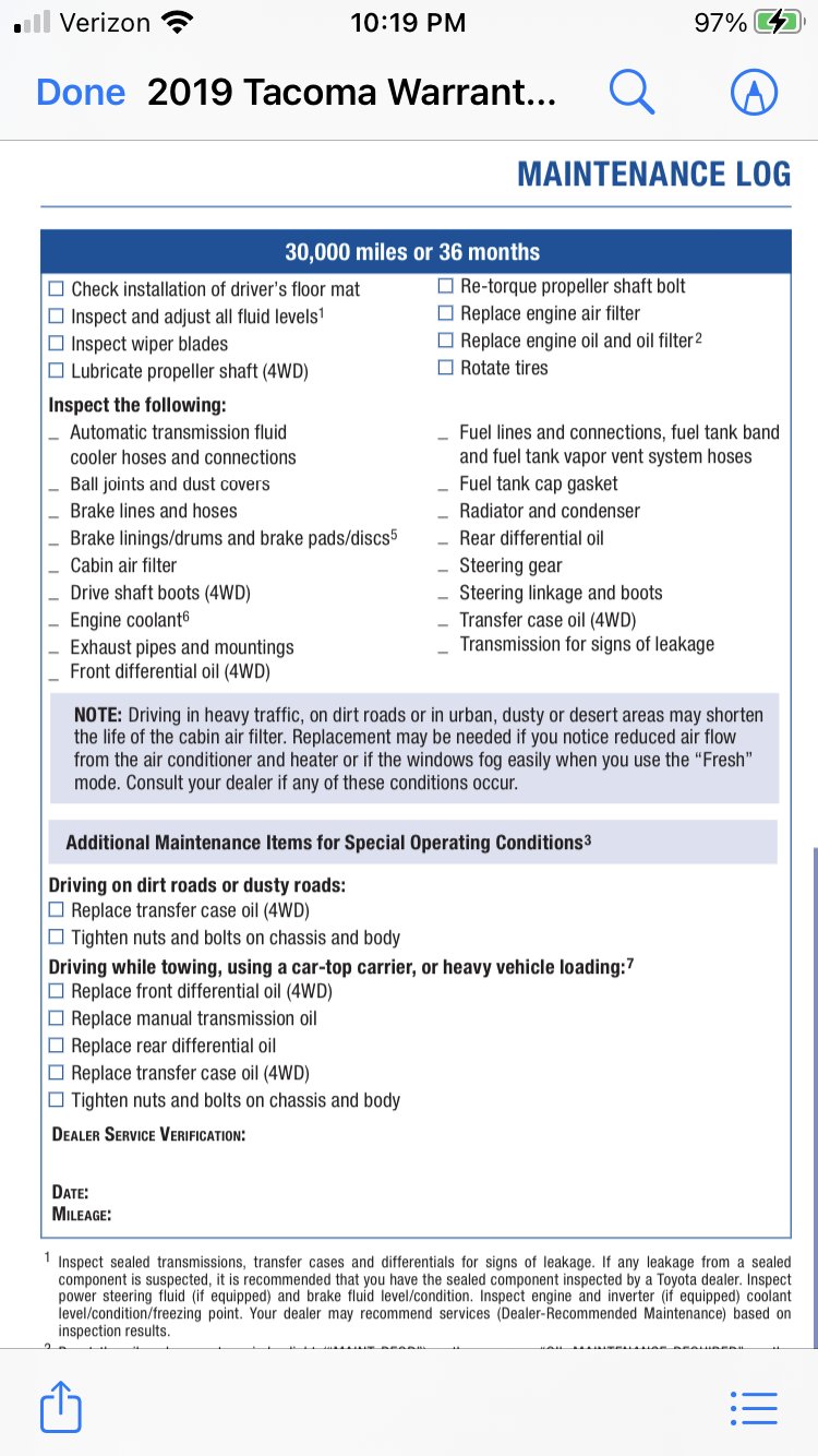

    Nonsense. The only fluid changes the Warranty and Maintenance Guide for my 2019 calls for at 30k is oil and filter. Everything else is an “inspect” unless harsh conditions driving.
