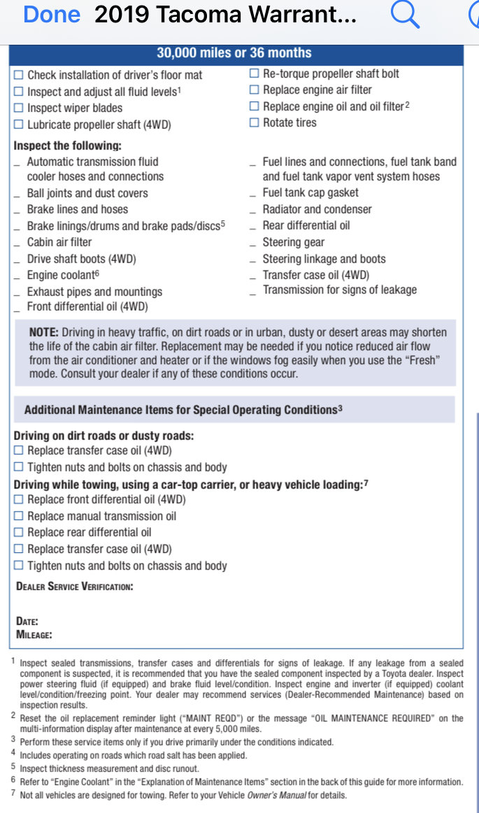

    I should have included the Note 3 for “Special Driving Conditions” which states
    “Perform these service items only if you drive primarily under the conditions indicated.”
    If you drive primarily under the listed conditions then do the listed items. If not no need to. Whether it’s “most” of us is speculative, only the individual drivers will know. It’s certainly not “all” or even “most” driving primarily in those conditions for the Tacomas I see in my area, your mileage may vary …dude. ;)

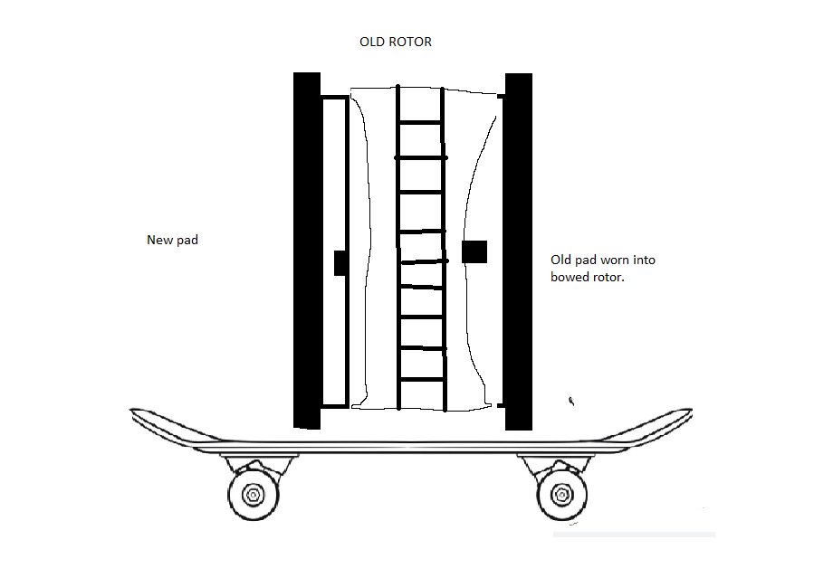

    Even a good looking rotor can have a concave surface to it, like a skateboard deck. Especially German cars, the rotors wear out almost as fast as the pads for some reason.
    Putting a new pad against a old rotor doesn't guarantee you'll have problems (I've pad slapped my own vehicles before) but it certainly opens the door to squeaks and vibes
    I always give customers the choice, but I tell them I can't fully warranty the job unless pads and rotors go on as a set.

    It's hard for people to visualize this.
    I will attempt with MS Paint.
    If I dont get 10 likes for this, a baby dolphin will drown in a local marina
