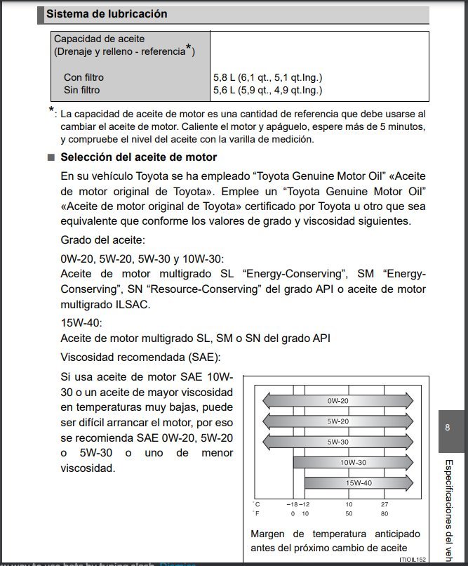

    You can use 5w30 no problem, the Mexico taco manual says it can be used instead with no side effects for the same temperature range. Even says 10w40 is ok if you dont see temps above 0*c. Might help with that quart consumption, thats kind of alot.
    Edit-added picture
