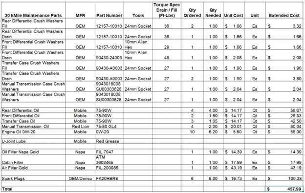

    My 2021 Tacoma w/manual gearbox was getting near 30 kMiles, so I asked the dealership, how much to change all the oil, spark plugs, air & cabin filters. The answer: about $1,300 USD.
    Luckily, there are some really great post and and some great videos out there to help.
    Here's the list:
    Doing the work over the period of a couple evening saved me about $800.
    None of the work was too bad, driver's side spark plugs were a pain though.
    Glad I did change plugs at 30k instead of 60k.
    Note: the oil for the manual transmission must be GL-4 rated, not GL-4/5 or GL-5.
    Part numbers and torque specs were collected from various sources, should be OK, but if there is an issue, let me know.

    Your chart has the incorrect oil listed for the transfer case.
    Toyota calls out a single grade 75W oil for the transfer case.
    SAE 75W Toyota Genuine Transfer gear oil LF or equivalent - Toyota part # 08885-81080
    It takes 1 quart to service the transfer case, it is expensive -- but then so was your truck.
    Search around, this can be found at widely varying prices.

    @RustyGreen
    You are correct, the 75W gear oil is what is specified for a manual transmission.
    However, according to a know Toyota mechanic, there is little difference as long the oil is GL4 rated as noted in the following link:
    https://www.youtube.com/watch?v=3le9ZT5HUlk&t=235s

    Yes, I was surprised by the different part numbers for the Crush Washers.
    From the factory, there were different types of crush washers.
    Some were basically just thin aluminum washers, others were true crush washers
    The front diff bottom was larger and had was made from copper.
    Just went by what in this article for crush washers
    https://empyreoffroad.com/blogs/res...toyota-tacoma-diy-maintenance-reference-guide
    And what the parts guy at the dealership said was needed.

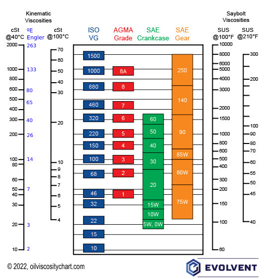

    Obviously you can do as you prefer, on the other hand since you are going to the effort of changing all the lubricants at 30K it would seem you have an interest in doing the job correctly.
    This has been discussed here many times, some folks have cold weather issues with the electric actuator for the transfer case when using the multi viscosity gear oil, some don't.
    Please review the orange "SAE Gear" section of the chart below, while you state "there is essentially no difference" the hot viscosity of the 90 grade oil is over twice that of the 75 grade - quite a substantial difference.
    Toyota engineers specified the 75W grade oil for a reason, the company goes to the trouble of shipping it from Japan in an old style metal can. Some folks have postulated that it is just a "cash grab" by Toyota. I feel this is silly.
    Most consumers are too cheap and lazy to have the engine oil changed on schedule much less pay for a transfer case service, also most dealer service departments are unaware of or choose to ignore the specification. If Toyota indeed wanted to increase revenue they would be much farther ahead to simply raise the price of every set of brake pads by $1.
    I prefer not to use YT as my primary source of information. ;)

    The chart above is for oil at its base weight (e.g., 75W without viscosity modifiers, 90W without viscosity modifiers).
    Viscosity modifiers are often carbon-based polymers and are used to prevent oil from thinning as the temperatures get hotter.
    The "W" designates that an oil has been tested to perform in both cold weather as well as at normal operating temperatures.
    Obviously, a 75W is a 75W oil. A 75W-90 oil is a 75W oil that has modifiers in it so that it performs as a 90W when heated
    (i.e., adds additional protection when the weather gets hotter by keeping the oil from excessive thinning where metal-to-metal contact occurs).
    So in the chart above both oils, 75W and 75W-90 have the same values as the chart.
    So, yes the transfer case oil change was done "correctly"
    There maybe a very slight decrease in MPG, if any.
    Also, it may be beneficial to read and use information from ISO, SAE, and AGMA standards instead of a summarized table shown on someone's website.

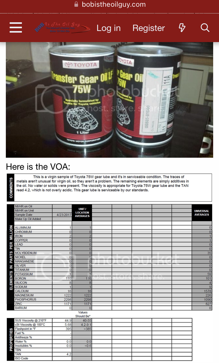

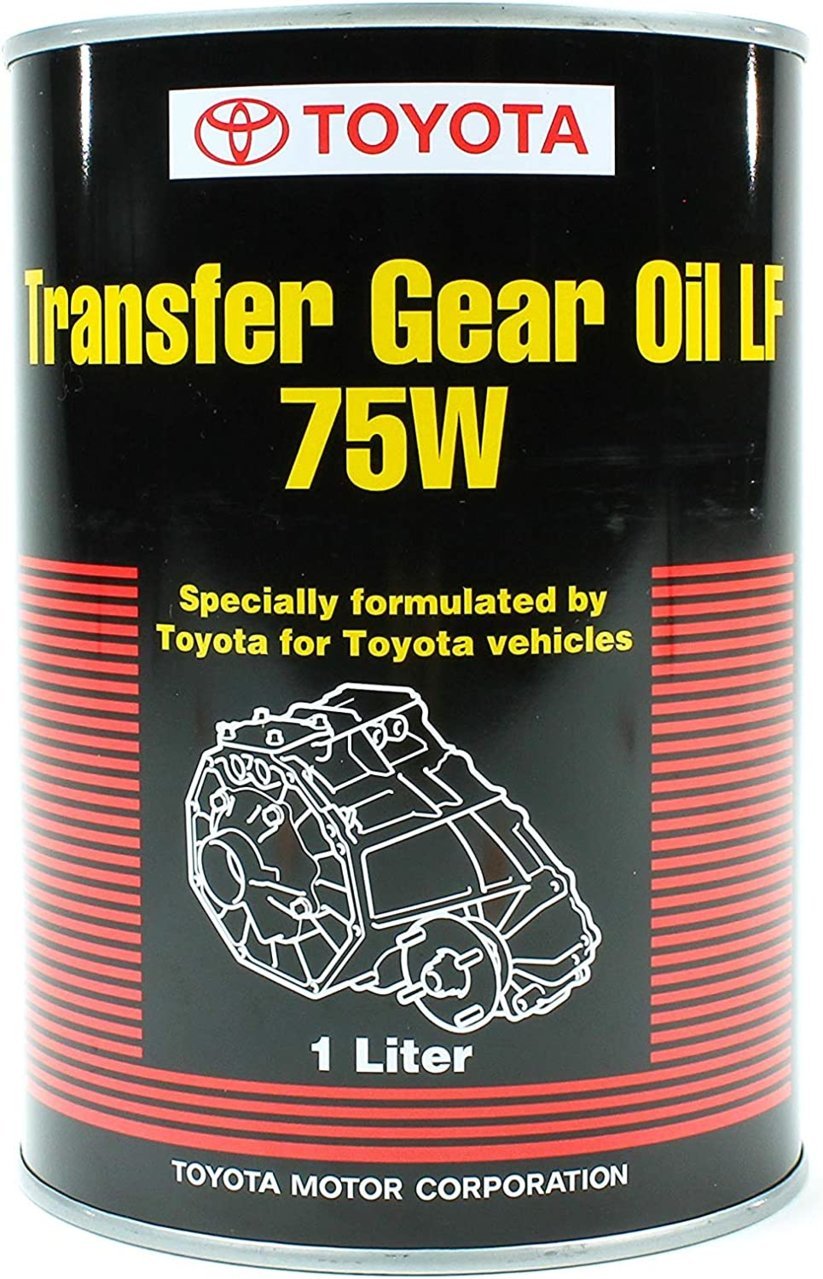

    Interestingly the 75W product lists no GL rating either on the can or in the manual.
