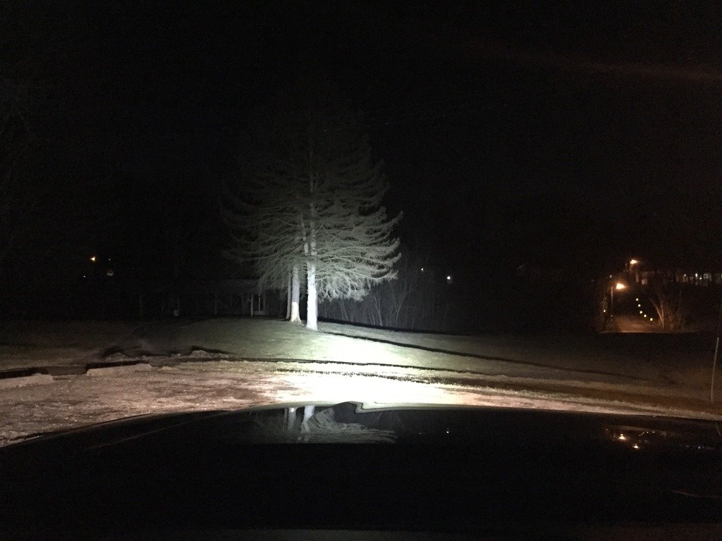

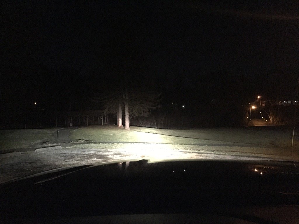

    Aussiek2000
    Aussiek2000 Well-Known Member
    Sep 5, 2015
    #163499
    5,652
    2016 Offroad AC
    55w HID low beams only
    High and Low
    High, Low, and light bar
    Just the light bar

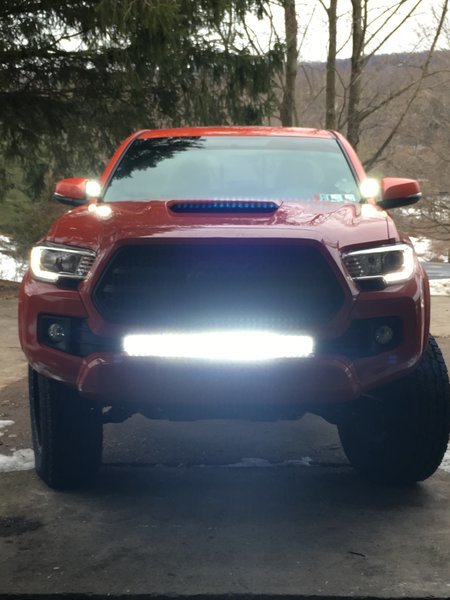

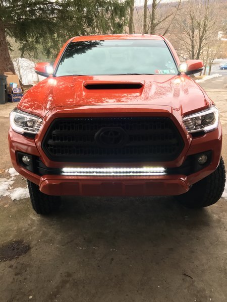

    Got my Cali Raised ditch lights and light bar all installed. Thanks to everyone for the help along the way. image.jpgimage.jpg

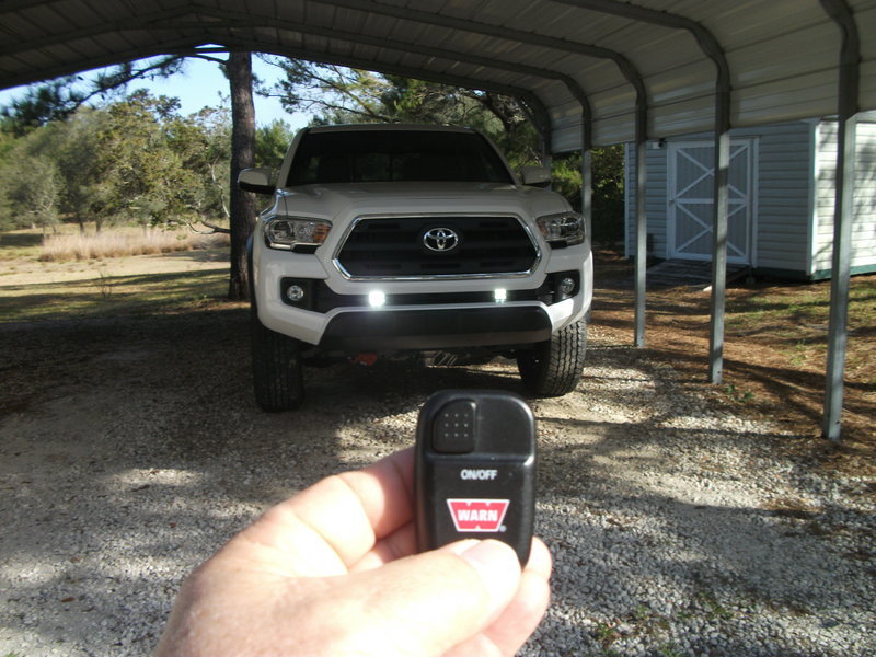

  13. Mar 16, 2016 at 4:03 AM
    #213
    tacomajoe16
    tacomajoe16 Active Member
    Dec 18, 2015
    #172518
    26
    Joseph
    Deland FL
    2016 Tacoma TRD Off-Road DCSB White
    Tailgate letters, Bed matte, Mud guards, Exhaust tip, LED cube flood lights

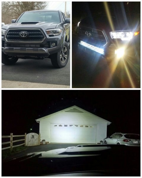

    It does take more work than people lead on!.. I blindly bought the CaliRaised 31.5" combo bar and brackets and it felt like a Chinese puzzle fitting it in there...I may have overpaid but quality feels good and and I'm satisfied with output. Outout Photo below is with bar only shining on house. Still need to figure out aiming..

    No holes to drill, the brackets stack on top of the outside aluminum bumper posts. So just four nuts to remove, slide the brackets on and reinstall. You do have to cut a section of the plastic air diverters on each side of the radiator to clear the brackets. Not much and I doubt anyone would notice later if you removed the brackets.
    One thing I just thought of is you would probably be limited to a 31.5" bar since width of the brackets is fixed. Brackets are slotted front-to-rear for light bar mounting though.
    But really it just consisted of removing the grill, plastic air diverters and unbolting two fluid coolers to help you guide the lightbar in.. Then reinstall everything probably about 6 screws/bolts and 6 plastic popout clips.
    It took me a total of about 1.5 hrs for full install with switch and some soldering(instead of crimps)..

    Danielnc06[QUOTED] likes this.

    So mine is the 3D lens flood/spot bar. It throws useable light just about the same areas as my brights..although the white light light reflects from much further out on signs and animal eyes. If you are wanting distance I would definitely say choose the 4d lens spot only option!.. I had a hard time deciding but needed a general spread of light so when with the combo 3d bar.
