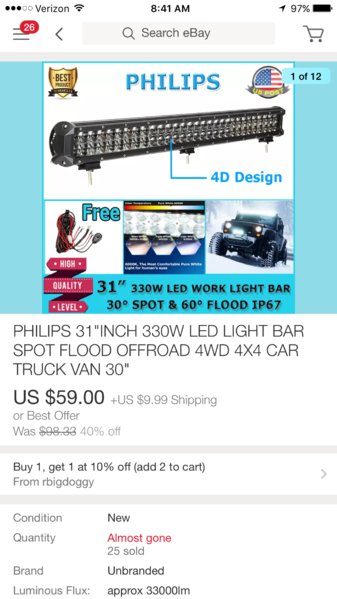

    So I just got this light bar as a gift from my fiancé... but I noticed this has three bolts to mount into the frame it looks like... anyway I can use the cali raised brackets on this bar? To me it doesn't seem like it. Thanks in advance... also if I can't use a bracket anyone see an easy way to mount this bar?

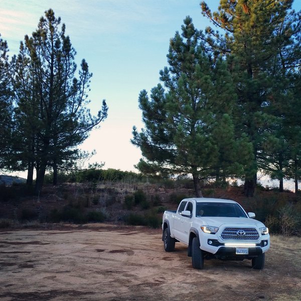

    So I'm real late to the party... I just got a Rough Country Flush lower grill light bar and installed it on Saturday. Will this switch fit my truck? I've only got three wires going to my interior switch
    Basically, is the size correct? 1.54 x 0.83 inch ?
    https://www.amazon.com/dp/B0117B1J3W/ref=twister_B01HZ8MITK?th=1
    and what about a hanger for the relays? It looks like shit hanging from that fuse box screw...
    sorry, I'm sure this is all in here but my wife really wants this done soon

    Here's what it looks like now. Went with the Rough Country when it was on sale. The job was quick except for dremelling out the grill slits and trying to get those damned crash bar nuts off. Those were so tight! I went with the flush mount.
    How are you guys adjusting it? Horizontal or a little above?
