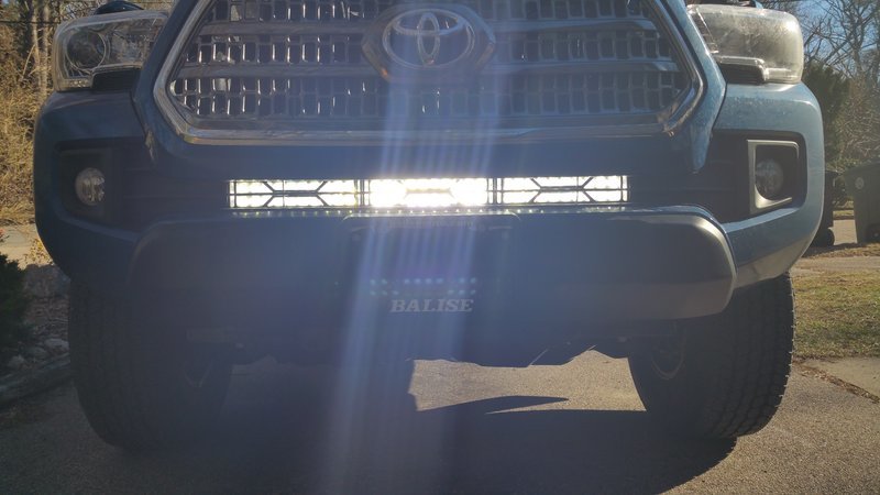

    Thanks to @rysingsun and @pwalnut I finally got everything buttoned up this past weekend.

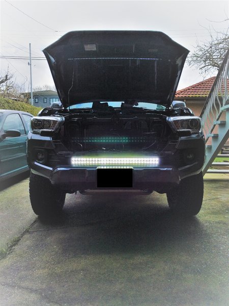

    Just a few LEDs...
    Mine isn't exactly a "light bar". It's more decorative than functional, but a member here has made a bracket that allows the mounting of a functional light bar in the scoop of the older and newer 2nd gens. He might have a kit for the 3rd gens by now.
