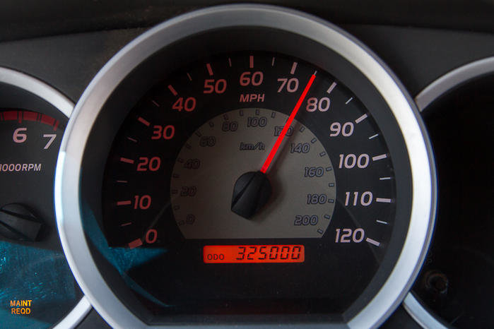

    I decided 325k on the original clutch was enough. I had the clutch disc+TOB+pilot bearing+pressure plate all replaced and the flywheel resurfaced by a dealer.
    The clutch was working fine, I just wanted to be proactive, as the original clutch had 325k on it and I did not know how much friction material remained.
    Here are some pics of the disk. I was surprised to see it was a LUK clutch disk, rather than ASIN.

    Large
    Large Red
    Sep 10, 2011
    #63268
    22,457
    You take some excellent photographs sir!

    Dang, still lots of miles left in the clutch disc at least. Good to have a new throw-out bearing though, hopefully it stands up as well as the original. I guess we'll know when you hit 650,000 miles.
