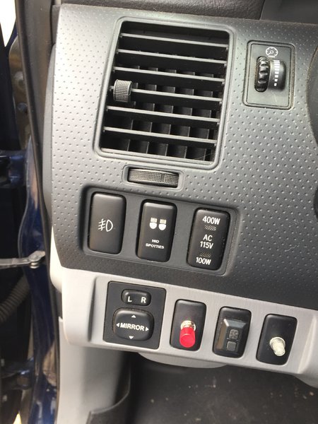

    So the switch is in...:taco:
    I took advice from @YamaDirtrider @mountainmonkey and I shot a pm to @Iggy awhile back since he made the harness the light bar came with..
    Thanks guys:D
    The lower light on the switch stays on at all times but I doubt it will hurt anything,pretty much like my alarm led I would think..
    If not somebody give me a heads up!!!
    Ya and I know it says spotties for a light bar but hey the switch was free

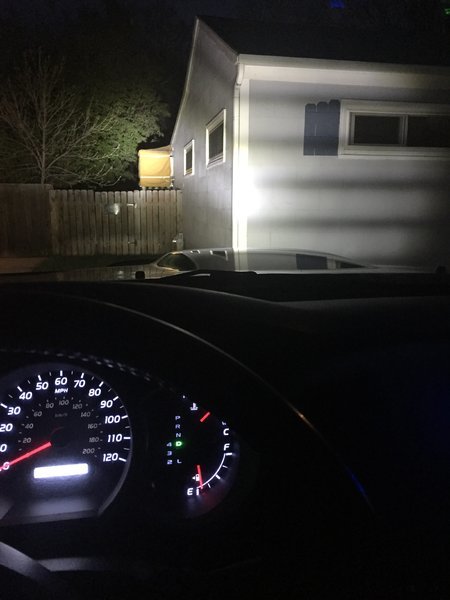

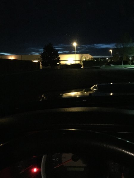

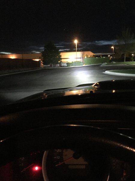

    Ok pictures as promised
    I'm going have to aim it down a little, spot is kind of high IMG_1562.jpg IMG_1567.jpg

    Might be just me but is a little left as well, no?

    It looks like it in 1st picture but don't know how that's possible its centered behind grill..
    I'll double check though :D
    Should the light be aimed a little below headlight cut off or above???

    With that bright sombich I would do a little above the headlights so you can see errthang

    I'm having this same problem with my switch, scouring the forums for answers. has it drained your battery at all?

    No and I let my truck sit all week.
    My switch is only 3amp.

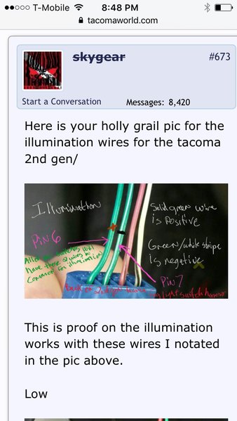

    Just need to tap into a wire for illumination and fuse tap to trigger switch with ignition on,instead of running all the wires back into the relay where they are hot all the time. Here are a couple threads I have found useful..
    I've been lazy about it.:D
    https://www.tacomaworld.com/threads/how-to-secondary-stand-alone-fuse-block-install.120561/
    https://www.tacomaworld.com/threads/wiring-an-aux-fuse-block-relays-and-switches-in-a-2016.401253/
    And a discussion with a few of the colorado guys
    https://www.tacomaworld.com/threads/colorado-b-s-thread.131441/page-5218#post-13642326
    And finally here is a picture of the illumination wire coming off fog lights
    Hope this helps

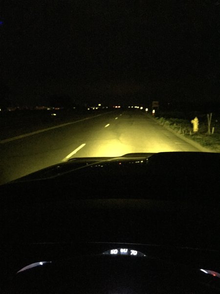

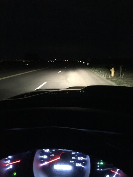

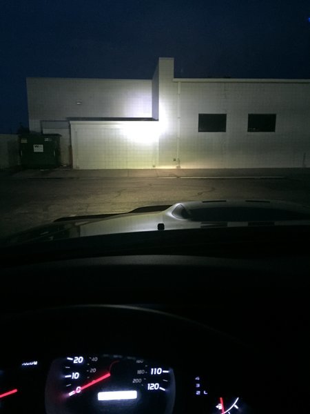

    Took a few more light pictures where it's dark out by where I work :taco:IMG_1583.jpg
    Lightbar
    Lightbar
    Just the Fogs and headlights
    Headlights lightbar

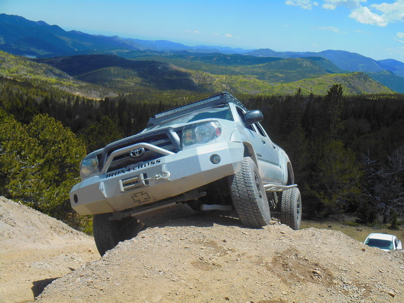

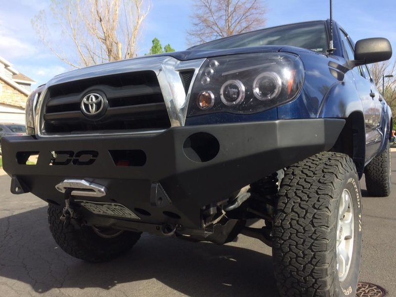

    No harm done it looks like though. How are the approach angles with the Iron Cross bumper? It looks to hang a bit low IMO. I just recently installed the flat top Demello bumper. I have yet to go out and use it though. Taco 4-16-17.jpg
