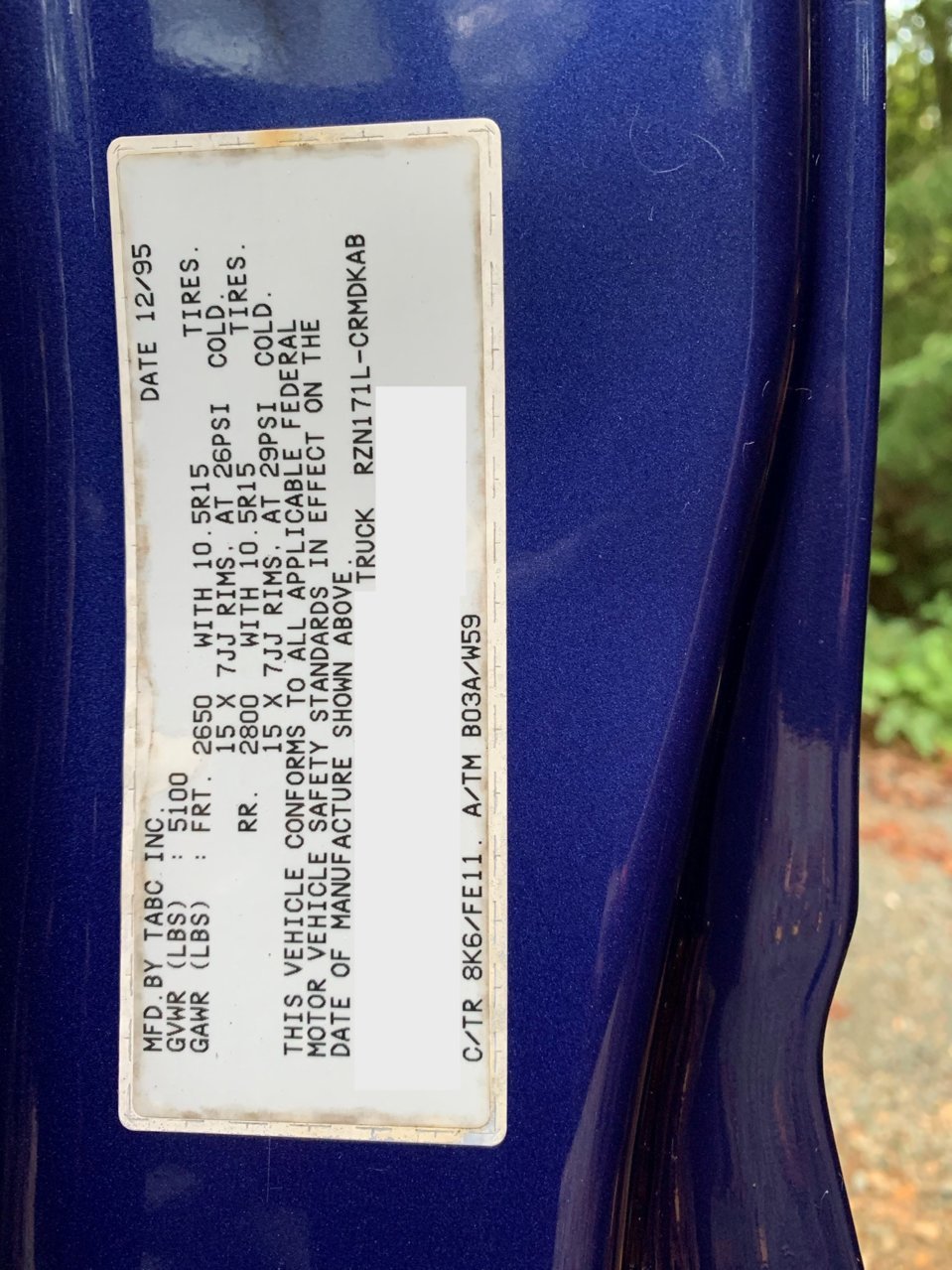

    ALL Tacomas have the generic tire sticker that says 225/75/15, don't ask me why but they were still an option up until '02 I believe. However most that came with the larger tires (31x10.5x15 or 265/70/16) also had an additional sticker to indicate the actual tire size.
    My truck still has both stickers on there.
    You will "appear" to gain MPG but in reality it is just your axles spinning more than intended (as stated, larger tire = less rotation, smaller = more) based off your gearing. If you look at your door jamb and read the sticker with the VIN it will tell you codes for your gearing. that is usually the determining of the 225/75 vs 31x10.5. Most 98+ had been upgraded to the 31s and 4.10 gears while a lot of 95-97 were on 225 and 3.73(?) gears (obviously some variations depending on auto vs manual and v6 vs i4).
    If your speedometer is reading correctly then stick with the tire size you have now, otherwise you will need to keep track of how fast your going, and if you calculate fuel mileage have to convert based on the smaller diameter tire.

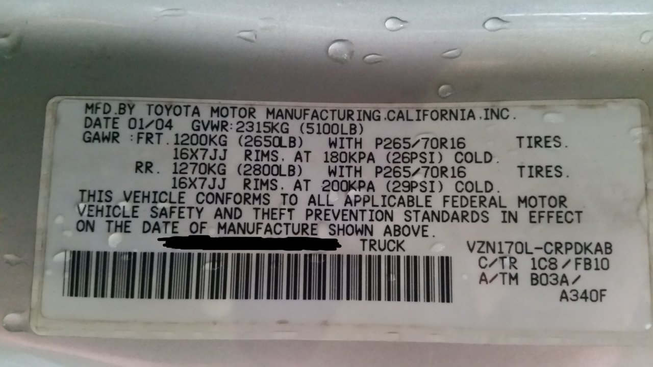

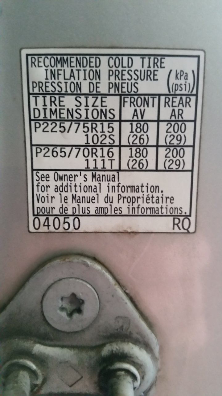

    my door stickers:
    seems maybe they started putting the correct size in the later years?

    Thanks. I hadn't seen that second sticker before. Appreciate the bit about gearing as well, I'd wondering what my gearing was but wasn't sure where the info was. I've got the 4.10 too. I get that the odo/mpg gain will be inaccurate I thought that the smaller, lighter tires would give an improvement in fuel economy but seems like the consensus is it's not really or not enough to be worth it.
