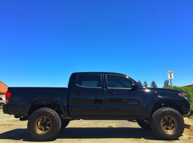

    I've got a 3in lift with 295/75/16 BFG ko2s... Like most people said in this thread you'll be glad you went bigger than smaller.

    Just the lift and offset from the wheels fit those bad boys on? Or did it require more modification?

    Yeah just the lift is all I did so far.. But I haven't had a chance to do the CMC yet or do some light trimming on the fender flares and plastics. I get some very light rubbing while turning when the suspension is flexing under normal driving conditions. So I know for sure I will be rubbing horribly if I do any time of off roading. So until I do the CMC and trim... No off roading for me lol
