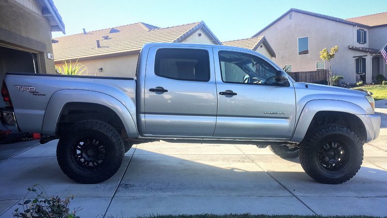

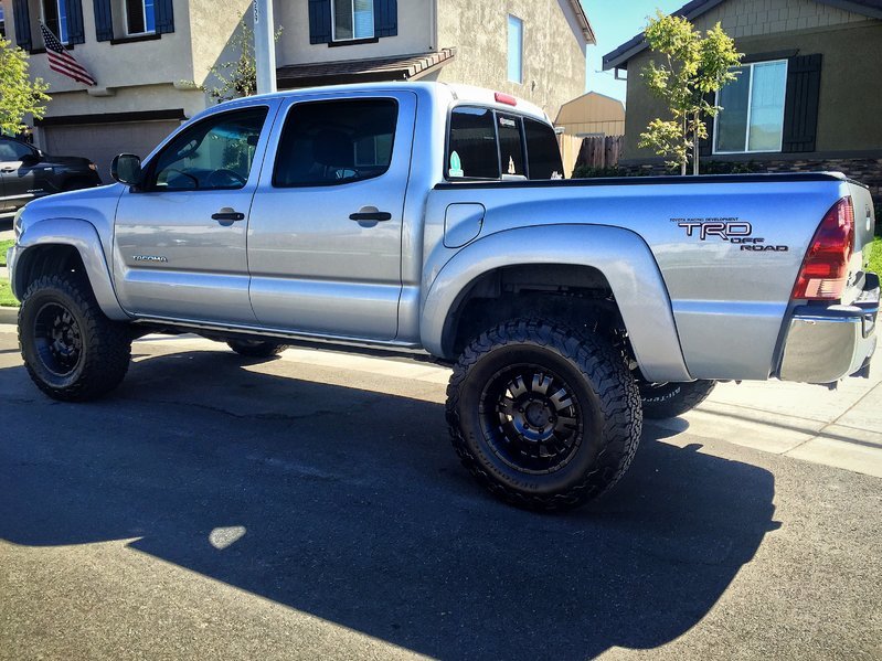

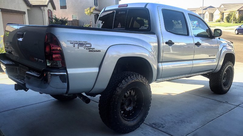

    I went with 285/70/17's which are 32.7". I have fairly aggressive tread so it's pretty much a 33" tire. With that I love them and would have hated if I had gone anything any smaller. I almost wish I went full 33" 12.5". With my 3" lift it gave me such a mean ride height. Here are a few pics.

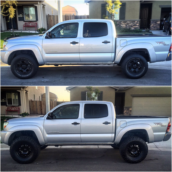

    Here's a before and after for comparison

    Looks great. How much cutting did you do? Do you notice any reduced power or drive ability?

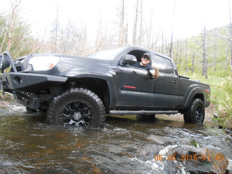

    I had a set of 285/70/17 TOYO MT's on my truck for a long time. Loved them. They are HEAVY though.
    Still would go with the 33's
    Pic for reference

    I only trimmed the front fender liner plasti mud flap a bit. Nothing major or noticeable at all.

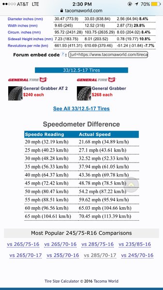

    I still fell all of the power of the V6 engine but it isn't as quick off the line, but it's really nothing major at all. Also keep in mind if you go larger with your tires that your speedometer is no longer accurate. You'll basically be going 5mph faster than it reads while on the highway.

    If I remember correctly (have it plugged into my UltraGauge for accurate speedo) the calculation is 1.07x your current speed on your factory speedo. That's if you go with a 285/70/17
