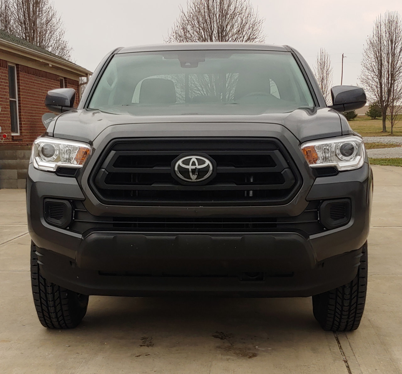

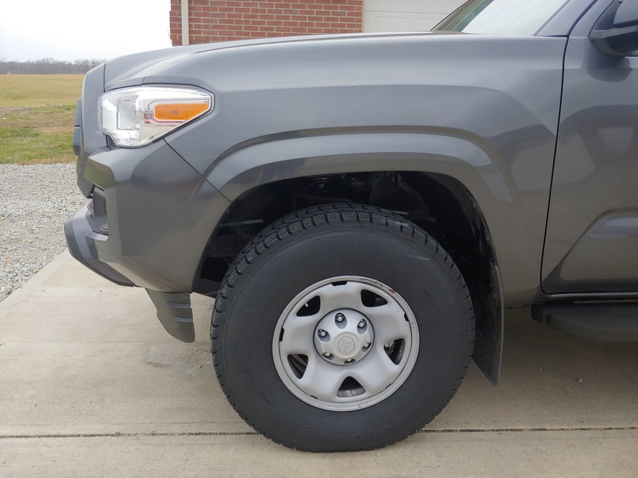

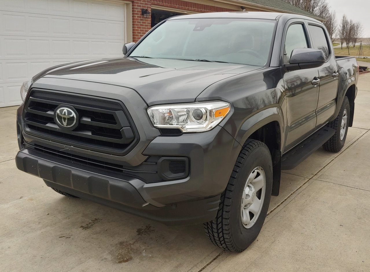

    LT235/85r16 fit without any mods on a 2022 Tacoma SR, V6 4x4
    Doing a quick post here as a thank you for all the great post/comments folks had on this forum to help make my decision to get these tires for my truck. With that I would like to say these Firestone Winterforce LT snow tires fit without any clearance issues or modifications. These are LT235/85r16 (32in) mounted on stock steel rims. As expected, they have more road noise and the ride is rougher. Given the deep snow I frequently navigate, those are expected and known tradeoffs. Tire pressure is set at 35psi.
