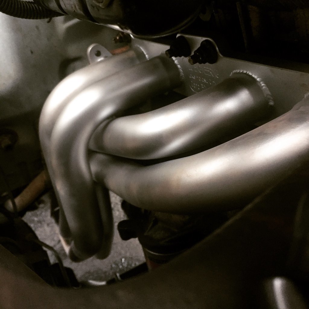

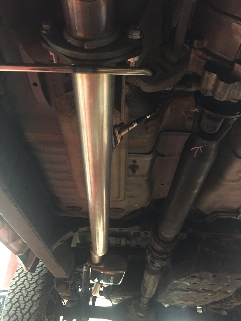

    Yup did the full exhaust did was stock with 180k on it and needed it bad! That's a good price, wonder what they would charge for the rear as well..
    Here's some pics....

    Exhaust came out sic! I'm pretty close to that to... 174k on mine. I'm debating on doing the entire exhaust or the header and cat then build my own catback. I'm mostly concerned with the noise levels at hwy speeds now that I'm running 3200rpm on the freeway. So I though about doing an exhaust with a large/quitter muffler on it. How long is the muffler that comes with that setup?

    That's awesome, the muffler was off LCE site but it's a little loud. What speed are you doing when your turning over 3200k?

    That's at 75mph. I was talking to one of the guys at LCE just now and I think I'll end up going with the header and cat and see if I can fab a custom catback with a quieter muffler. Thanks for the info!
