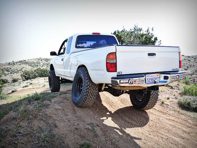

    3" lift Up front(Donahoe Racing ext. travel coil overs, Camburg UCA's), 1.5-2" lift in the back(aal and some billy 10" stroke short bodies), Bushwhacker Cut-Out fender flairs, 16"x10" Procomp Street locks, and 305/70 Procomp X-Terrains.
    I have 4" bs with a 10" wide rim, 305/70s(33/12.5s) Not a lot of room if you only have a 3.5" lift.
    EDIT: I have about a 1" to 2" of room between my tire and uca.

    You could get a ticket for those tires extending out your fenders as it shows. I here they are really getting stiff on this small fixit things.

    Will I still get a ticket if the tire is sticking out like 1", I just put on BushWacker Cut Out Fender flairs and it hides the tire more.
    Sorry OP just do not want a ticket.

    I all ready have my flairs on, just do not have picks of them.
