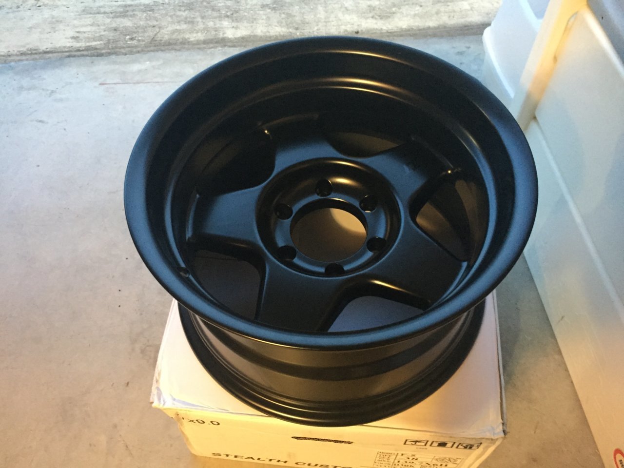

    Right now I'm running a set of dead DC Extreme Countries on some ebay wheels. Cheapo Craigslist deals and friend "payments" to get 35s to fit.
    Going with SCS F5s with STT Pros for the first "new" set of dirties. Just waiting on the wheels to get delivered Thursday.

    Haha... got em! Im just waiting on tires. :cheers:
