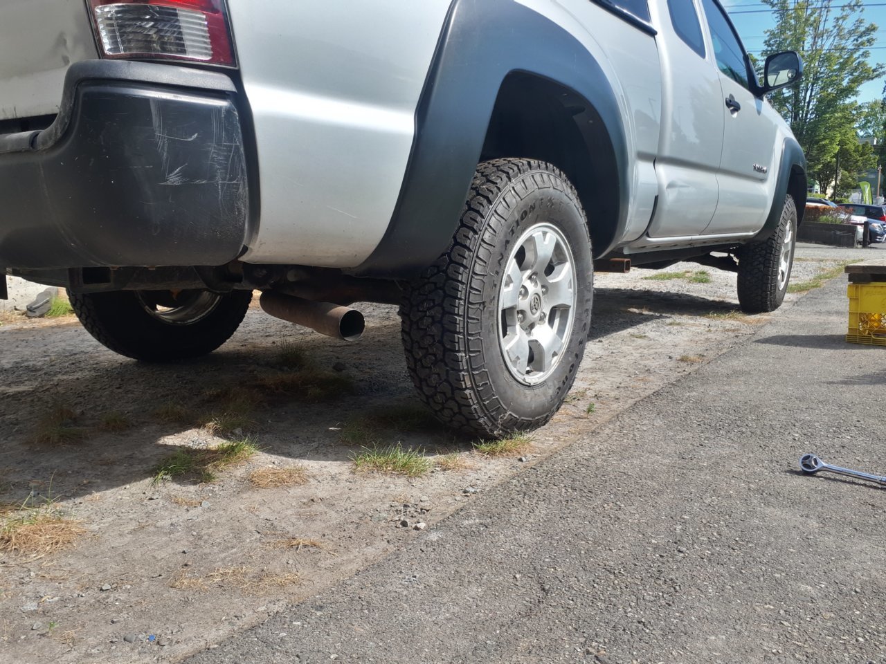

    With lighter tires, your truck accelerates much faster, experiences less suspension wear, and gets better fuel economy. Typically, a skinner tire will be lighter in the same model of tire. Skinnier tires cut through snow better, and are more sure footed in rain. Less good in mud and sand.
    I'm running some 215/85/r16's Destination X/T's, and the truck feels awesome, especially when compared to the stock size BFG KO's I have on steel rims. The truck feels "dead" with them on; sluggish and noisy.
    I think my wheels and tires combined are 55lbs or so.
    Depending on who you talk to, a pound of unsprung weight is equal to 2-5 pounds of sprung weight.
    Lighter is almost always better, unless you're doing some HC offroad.

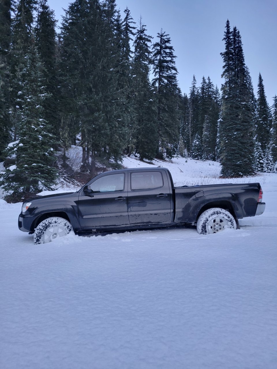

    I went with the toyo open country AT3s in 235/85/ 16 e rated at 44 lbs per tire. I like the size but the tires are a little less than impressive in rainy and snowy conditions.

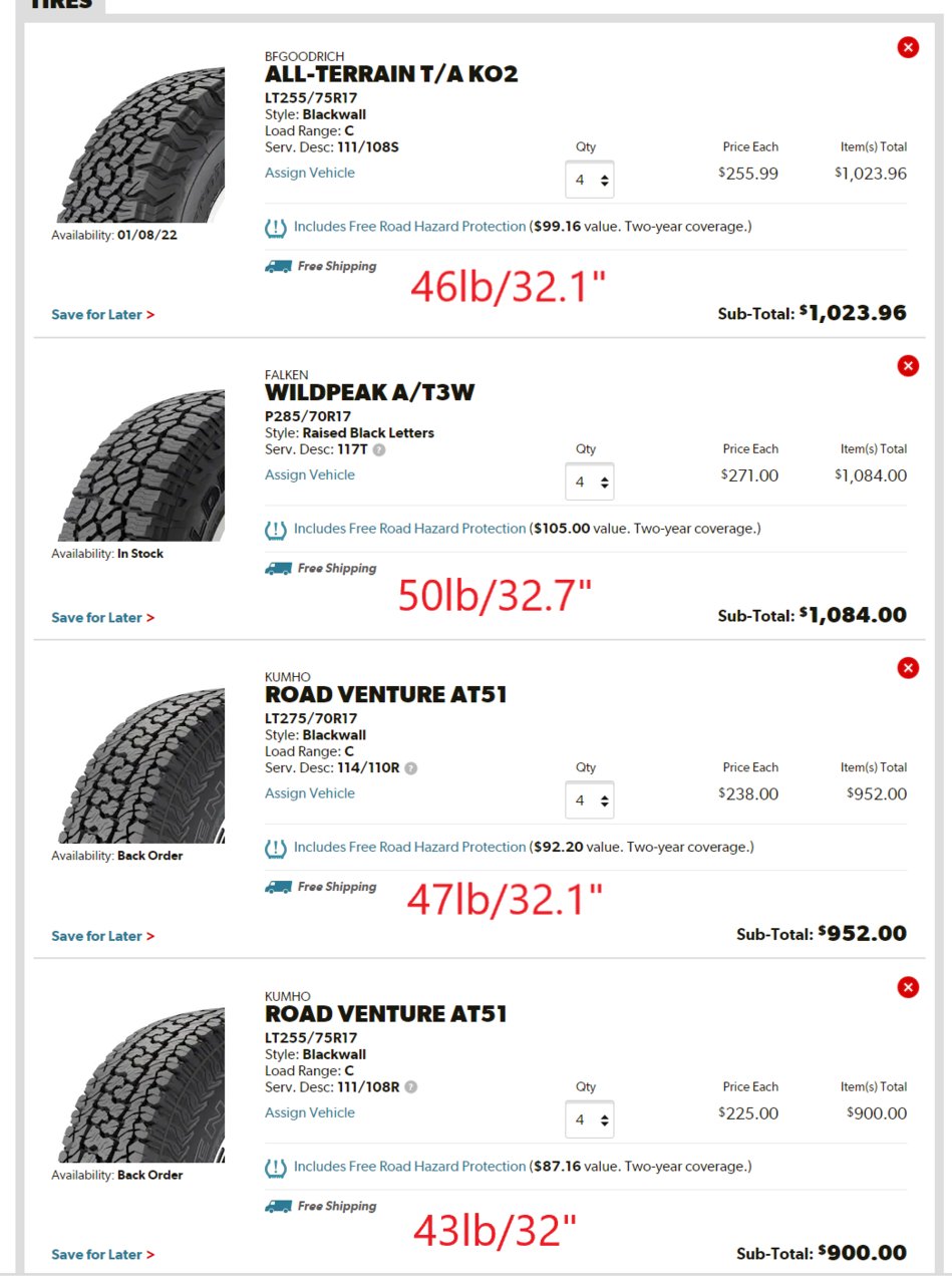

    Here is some poking around I did.
    Thoughts?

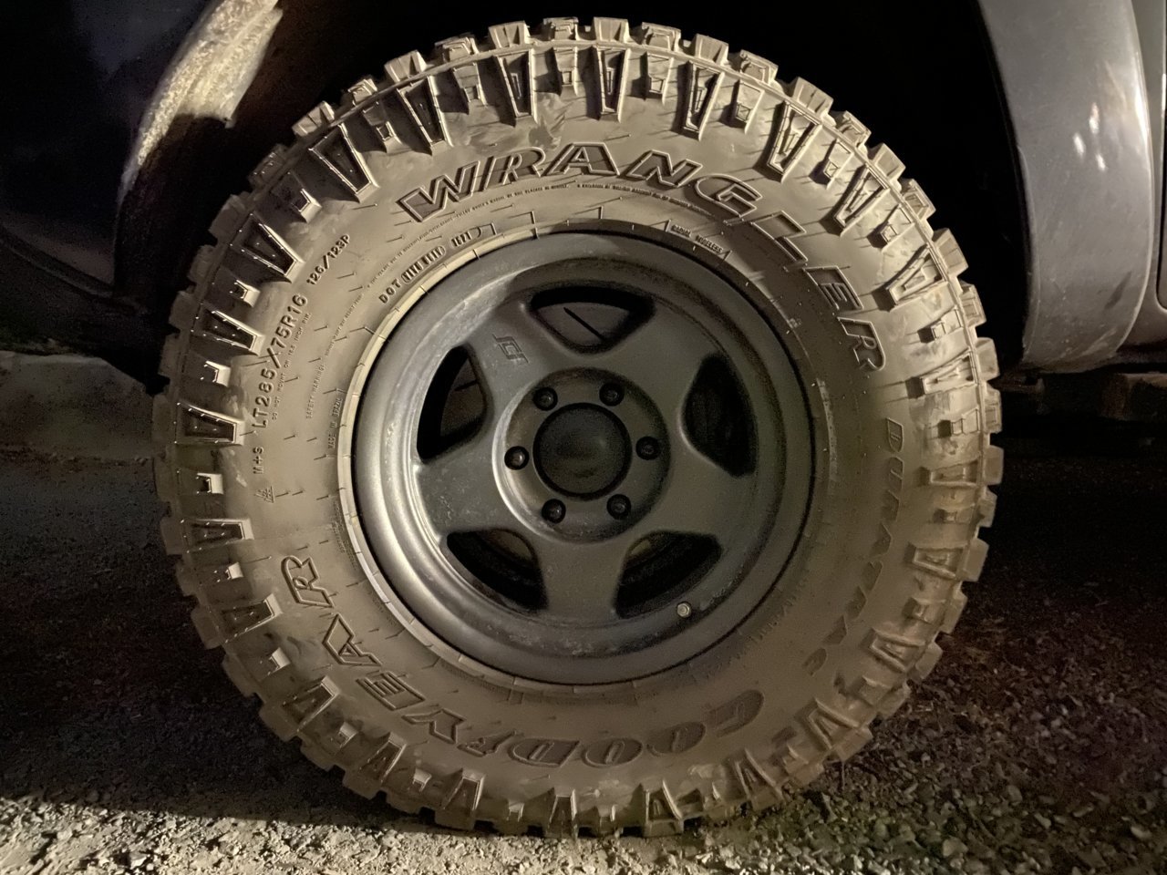

    This is likely the lightest 16" setup with a 285/75 that isn't a street tire.
    SCS F5 at 19lbs and a Goodyear Duratrac at 55lbs (they are aired down to 20lbs which is why the sidewall has some bulge).
