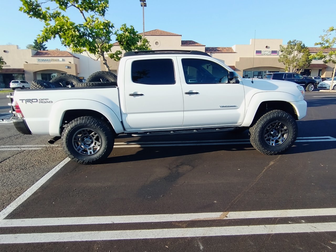

    This doesnt exactly pertain to the 265/75/16 tire size being discussed but I was very concerned about tire/wheel weight as well.
    I went from 265/75/16 BFG KO2 to 255/80/17 (true 33" tire) Toyo ATIII.
    Mounted on TRD 4runner wheels.
    I did not have any change in MPG surprisingly
    The reduced width with a tiny increase in weight seemed to balance out.
    I also think the taller tire reduced the overall drive ratio which reduced RPMs on the freeway.

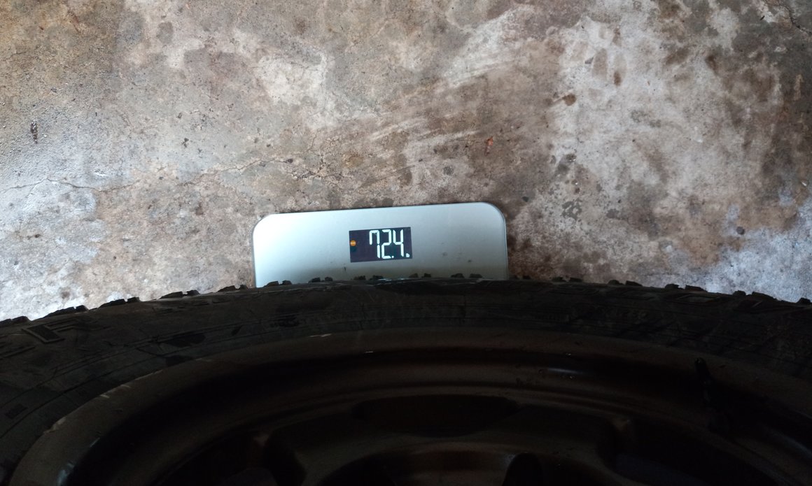

    CS_AR
    CS_AR Well-Known Member
    Apr 3, 2019
    #289019
    12,949
    1999 Tacoma PreRunner TRD
    Everything but the driveshaft. B03A - 410
    SRS F5 + Cooper MTP 285/75/16. 72.4 LBS
