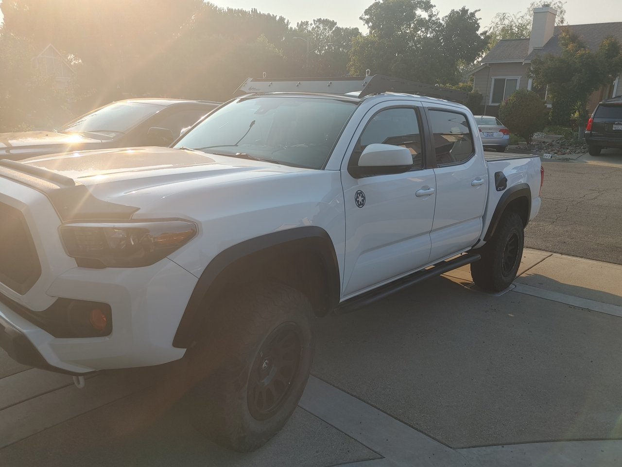

    I run 265 70 17 bfg ko2s with a 3in eibach lift. Love the set up. Ive heard 275 wont rub, but once you go to 285 you need to start cutting.
    maplefins[OP] likes this.
