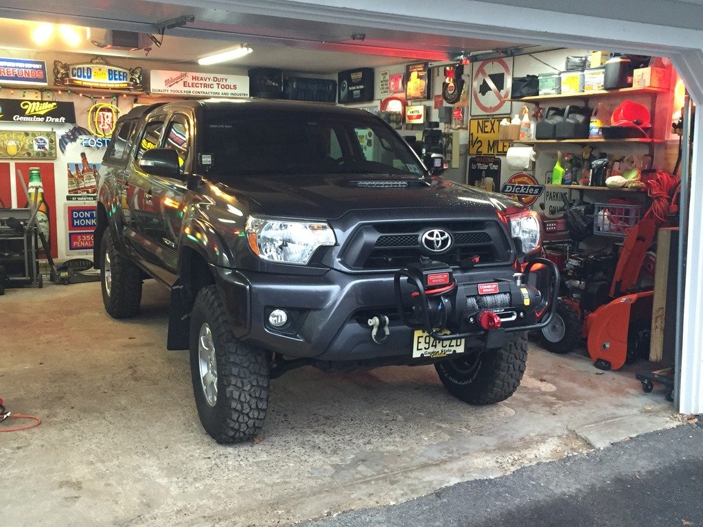

    Gigantic PITA (speaking from doing LT swaps)
    3.5" lift up front with 285/11.5/17 I had to cut some fender away to keep it from rubbing in full lock. Never rub after that even at full lock both ways.

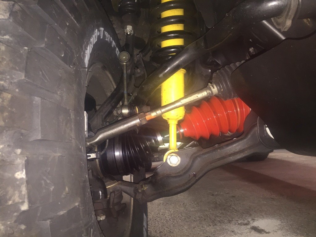

    Hardest part is knocking the CV's out of the diff. There's a little retaining ring that needs to be defeated. I like to put the end of a pry bar in the notch on the axle and knock it out with a hammer. Install the same way. Everything else is just removing and replacing bolts.

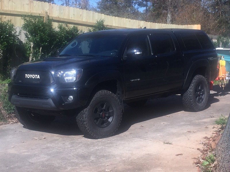

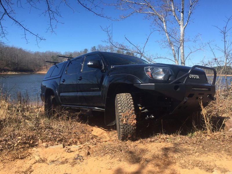

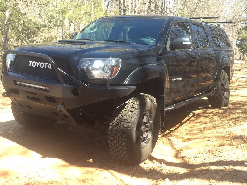

    Since that picture - I've added sliders, aluminum Pelfreybilt front bumper, and an aluminum Pelfreybilt IFS skid... With the extra weight, I lost a little bit of height up front and a do rub on the inside corner of the front mud flaps sometimes when the wheel is turned and the tire is up.
    I think it would be fine if I removed the mud flaps, but I kinda like not slinging rocks up the rocker panels... I may get the heat gun out again and work on that inside corner again.
    And I am not running any spacers, but I am running SPC UCAs.
