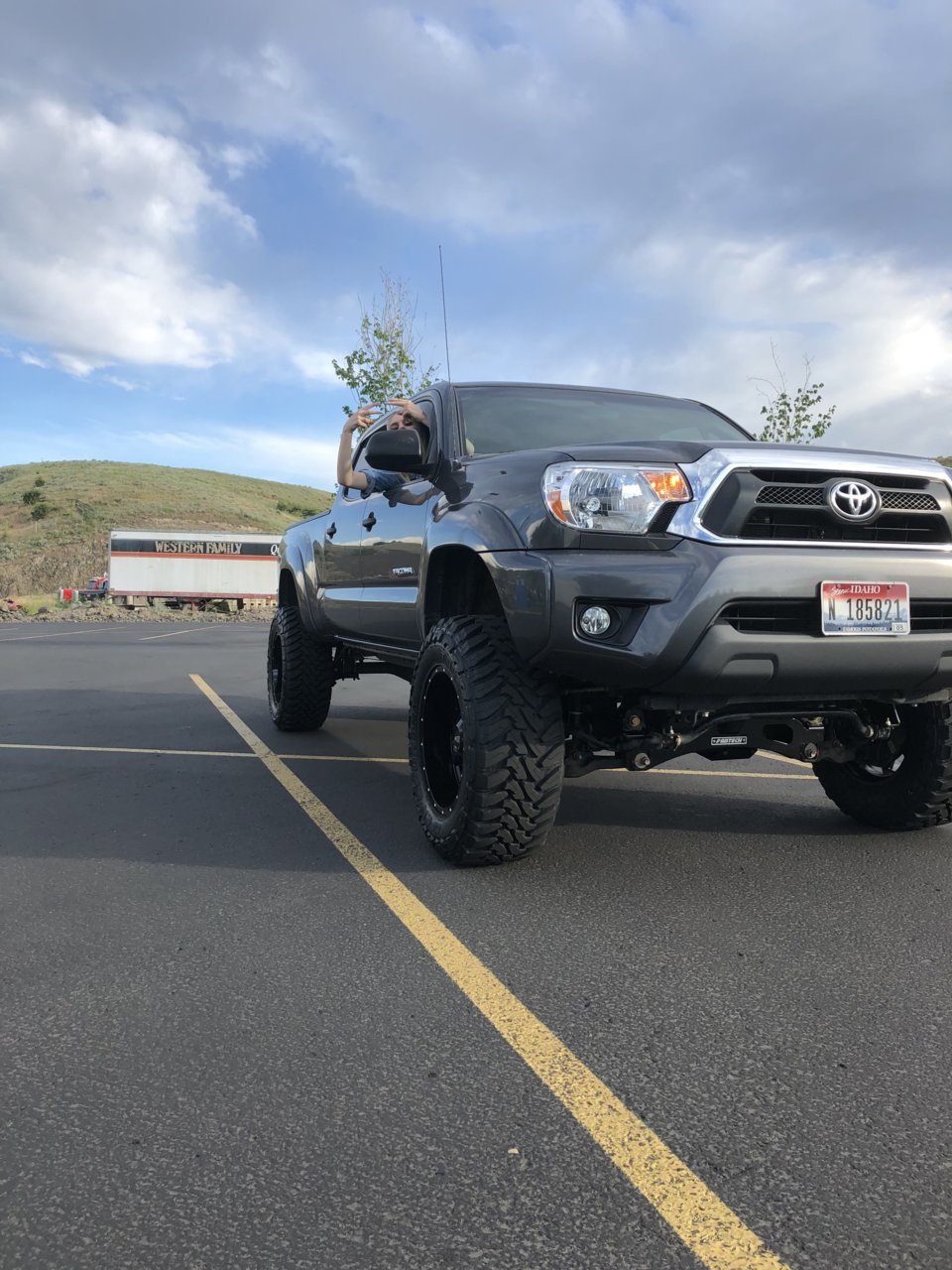

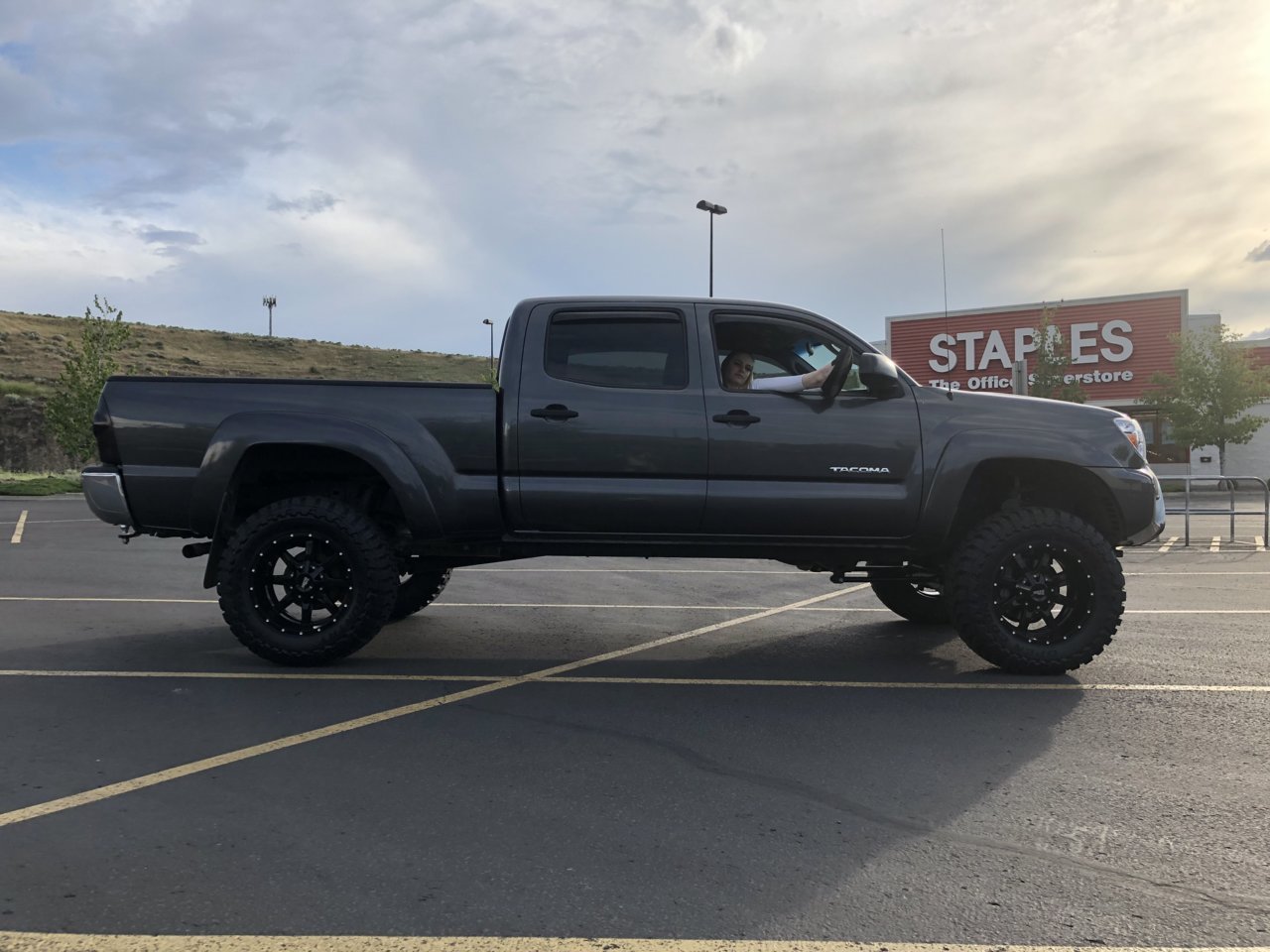

    6in Fabtech suspension Lift, 33x12.5 tires.
    Honestly think it looks really good. I had ordered all my stuff to do the 6in with 33s and after started reading this thread. Quickly started second guessing my decision and thought it would look dumb, but was extremely pleased with the outcome, and avoided the extra headache that comes with 35’s. Long story short, do what you thinks going to look good and don’t stress about other people’s opinions like I did!

    Is your passenger a member of the scissor gang mafia , lol

    She is in fact, apart of the scissor gang :D:D

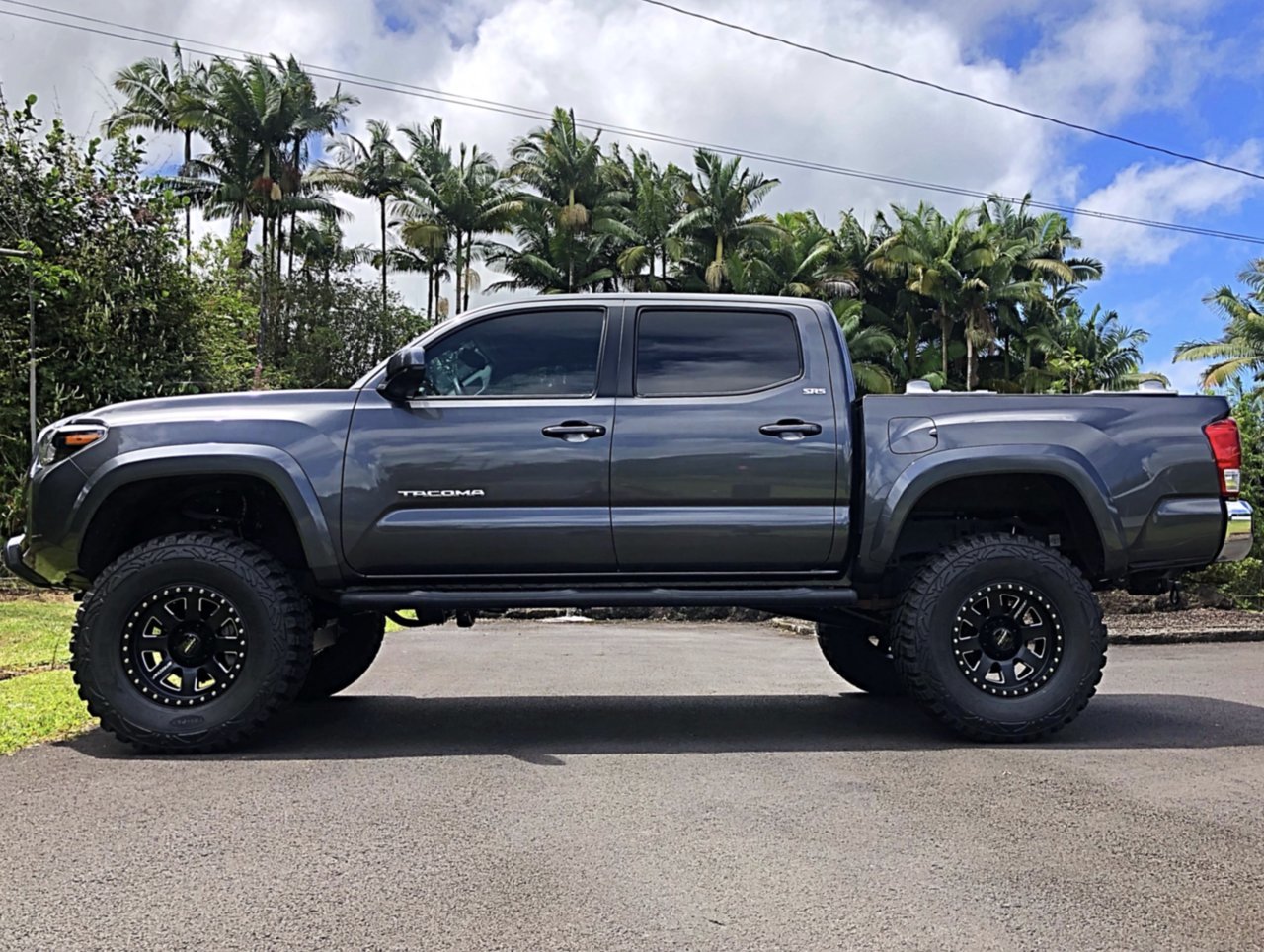

    6 inch pro comp lift on 33s
    1A63A85A-CE9D-47B9-A557-A35B78DD930C.jpg BF7715A4-410C-446F-975B-EECE1B393E70.jpg
    6 inch pro comp on 33s..
    You got a tacoma its always lifted 6 inches or higher here in Hawaii..
