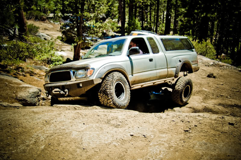

    X3 I have 33x12.5 and i rub like crazy off road on the street it's fine but if you wheel your truck they will rub unless you tub your fenders.

    I beg to differ with my wheel and tire setup you would need to tub your fenders to fully stuff my tires without rubbing and a 10.5 is not a 12.5
    I rub the top of the fender and the fender wall with my 33's

    I blew the bushwhackers off in the front and hit the sheet metal wile hauling ass down a fire road at 50+ I do have a mid travel setup so I have more travel then most. But if I'm at full lock with the tire stuffed i rub the fender wall and the frame so I just don't see a 33x12.5 having no rubbing at all on these trucks if you in fact wheel your truck.
