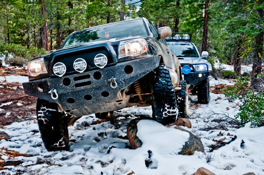

    I have more clearance than I had with my 33's. I have less rubbing than I had with 33s (Because I hadn't cut or trimmed anything with my old tires), and I hit the bumps before I come in contact with the fenders. I tried to stuff them on a rock on the wheeling trip on Saturday and I still had a bit more room.
  16. Nov 16, 2010 at 1:52 PM
    #36
    Jason'sLawnCare
    Jason'sLawnCare Prepared for Bambi
    Apr 12, 2009
    #15878
    12,343
    Jason
    Jacksonville Florida
    08 4x4 Double Cab TRD Rugged Trail
    CBI Moab 2.0, CBI Trail Rider 2.0, CBI sliders w/kickout, Superwinch EPi9.0S, OME sport shocks w/886 coils, OME n182, 1.5" aal, JasonBuilt 3/16th full belly skid, BuiltRight uca, Body Mount Chop, 285/75/16 km2's, Rear cat delete, exhaust crossover rerouted, Fog light anytime, Locker mod, Rear leaf tsb, Debadged, Uws Tool Box, Electric Exhaust Cutout, AFE Pro Dry S, Kiwi Wifi, Diff Breather Relocated, Grom Ipod Adapter, Dual Diehard platinum batteries isolated by BlueSea marine switch
    I don't even think that is stuffed to stock height judging by the angles. It's an awesome picture though!

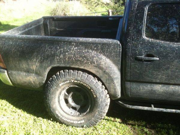

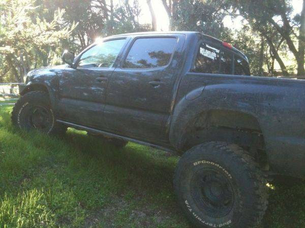

    Here Larry, went down into my yard to test some things out. Sorry for the crappy cell phone quality.
    Here is my rear, sitting on my bumpstop. It wasn't touching anywhere, I checked all around the tire and there was a very small gap the entire way between the fender and tire.
    Here is the front about 3/4" away from the bumpstop. The tire was turned slightly, not quite at a 45 degree angle. This is where it made first contact with the cab mount, but it still stuffs nicely. Testing this out made me want to get long travel. :(
    lo2hi likes this.
