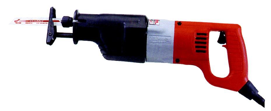

    This will be your best friend

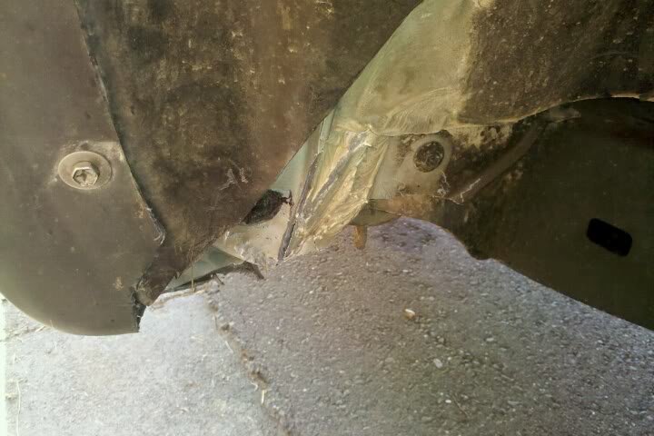

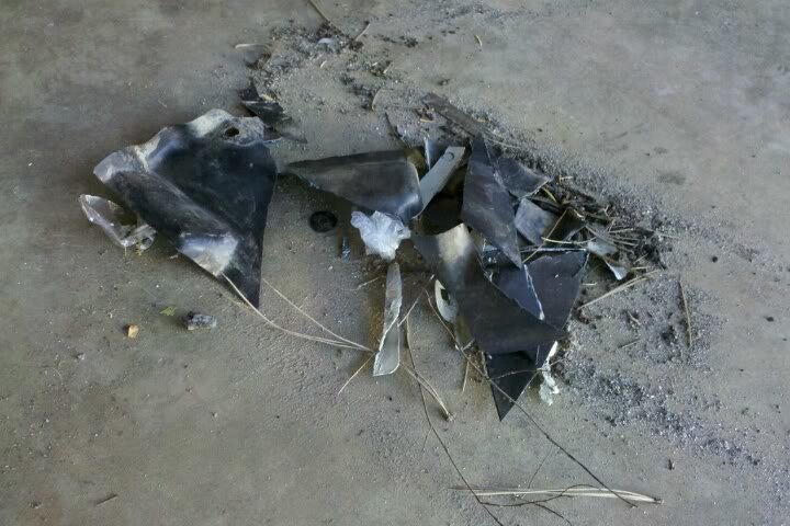

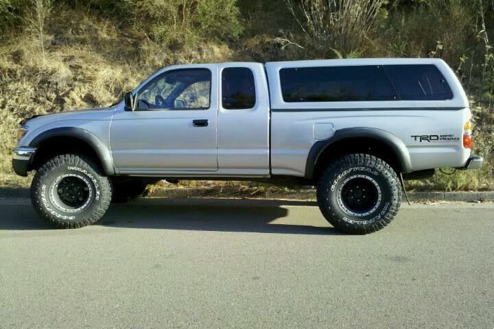

    It's defiantly doable I have a 1st Gen with 33"x12.5"x15's with no rubbing at all at full lock this i all i had to cut.
    On the street I'm fine but I have yet to go wheelin with the new tires and I'm sure I'm going to have major rubbing issues in the rear and climbing rocks at full lock.
