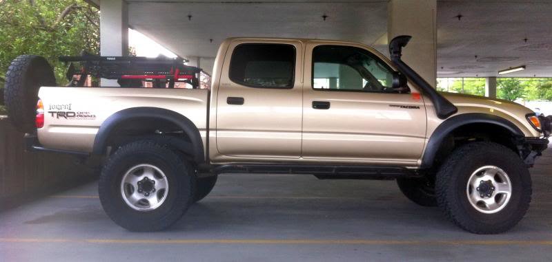

    For the OP if its just a street truck the 35's will work with a 3" lift and 1" BL. Still need to trim and do the pinch weld mod but you can run it without tubbing the firewall. I wouldn't use the 2" wheel spacers though
    Now if you plan to offroad it, then you'll definitely want to tub the firewall. Mine only rubs at full lock. Haven't rubbed once otherwise in the past two weeks of street driving even through some good bumps
    Here's mine
