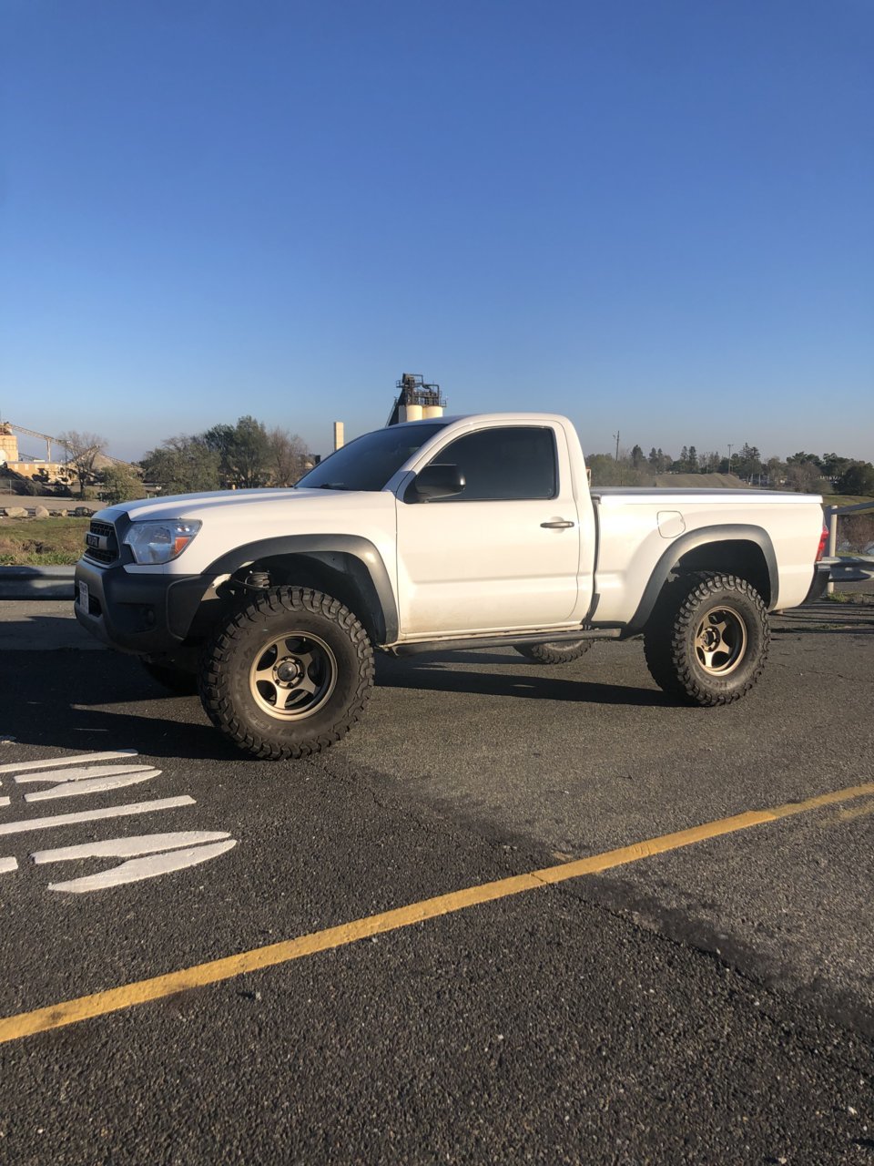

    2014 manual 315s on 1 inch lift . Runs fine with stock gears easily 70 mph on highway . 4.88 gonna make the drive much easier. EDBFB579-E857-4EBC-A2DB-9BE4B5B3AB6A.jpg

    I don’t mean to resurrect but can you give some more feedback/driving impressions Danglee? I also have a 5 speed regular cab and I’m aiming to replace worn out stock suspension and 265s with some 5100s and either 315 or 285/75r16 but don’t know if 35s will be too much. Saw a 3rd gen with 285s today and they looked kinda small but don’t want to tank fuel economy and performance

    Gonna need regear for sure with them 315s . 1-4 gear is good 5th on flat highway is fine , but little incline 5th gear is gone . Hope this helps…
