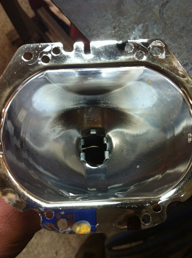

    Just so everyone understand what scorch looks like and why it's not a good thing. The bowl is cast aluminum with a special chroming process. The excess UV literally burns that chrome off and you no longer reflect light which turns your output to garbage. Nothing melts, it just ruins a good headlight assembly. See image.

    Thanks for the pic. Very good info to know!

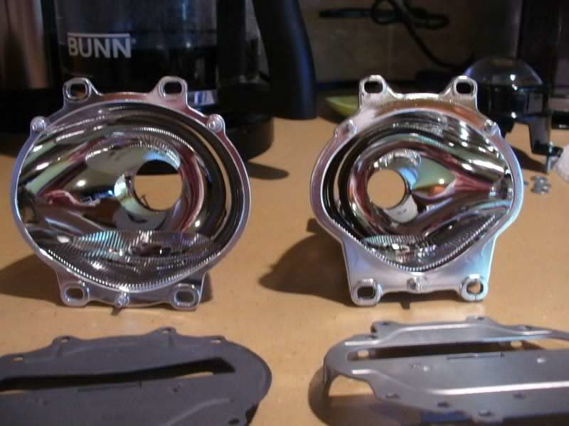

    That bowl is from a BiX housing, Mini H1 I believe. Same concept. The MD2S has a different bowl shape. See image. Halogen is on the right, D2S is on left. The bowl is larger and has more headroom allowing for the additional output of the 50W capsule.
