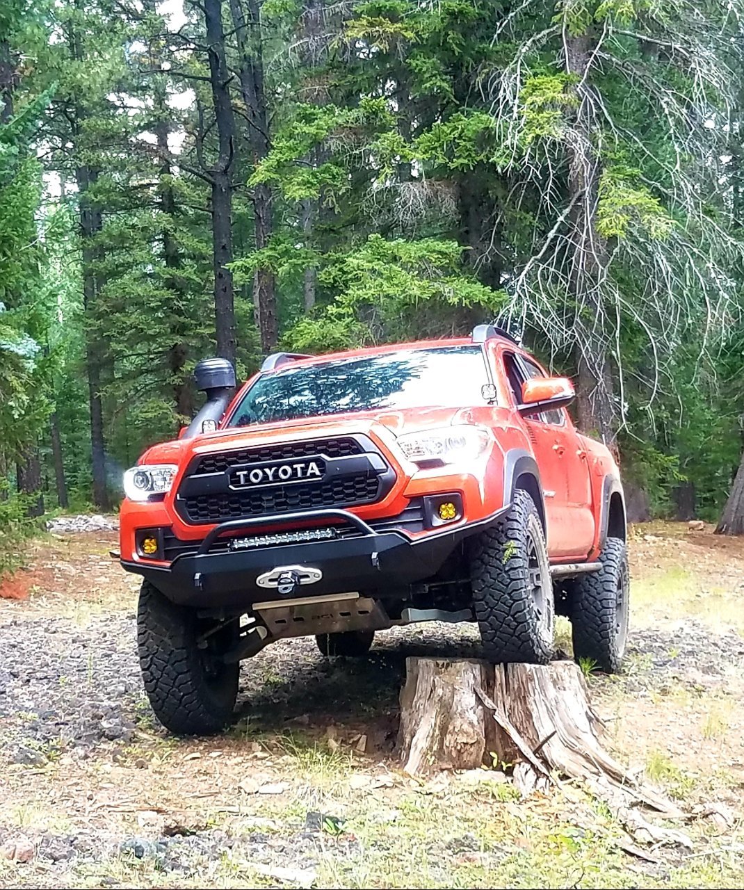

    I'm running these tires with TRD 4Runner wheels. Really the only thing out there that fit my needs as far as offset and width. I have no UCA or frame rub but did need to do a cmc and aggressively smash my pinch welds as well as cut a little bit of fender flare to fit them. Currently not rubbing off road with about 3" lift and ICON tube UCAs.

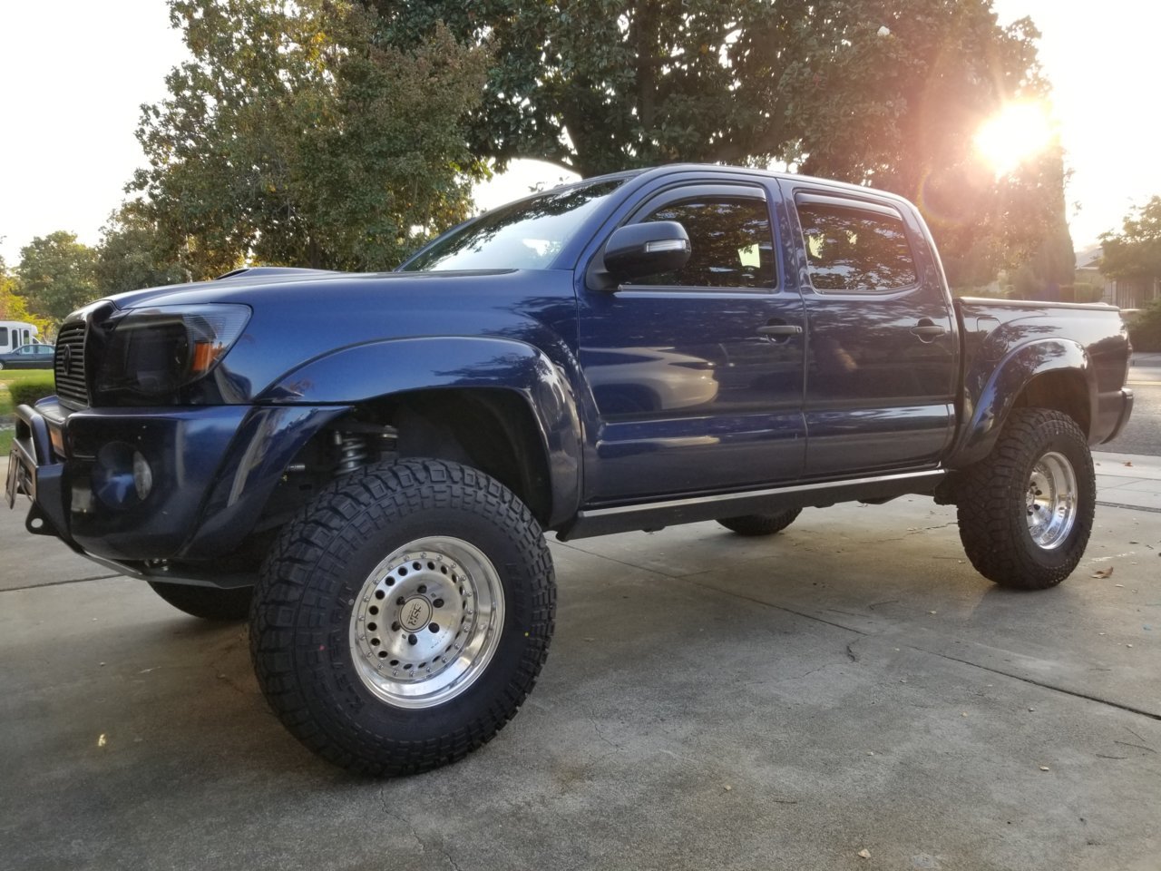

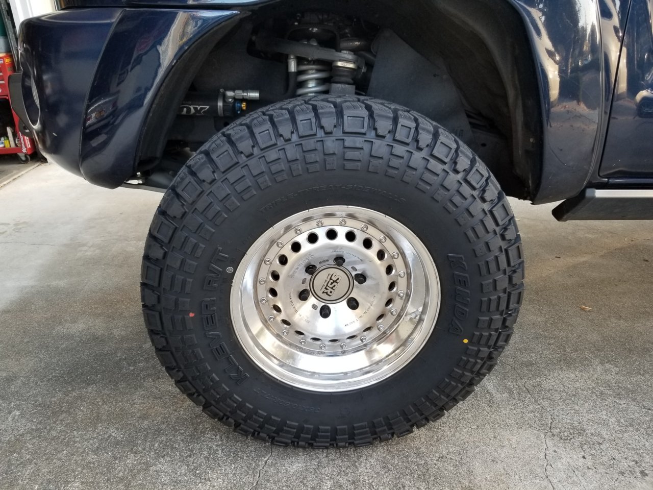

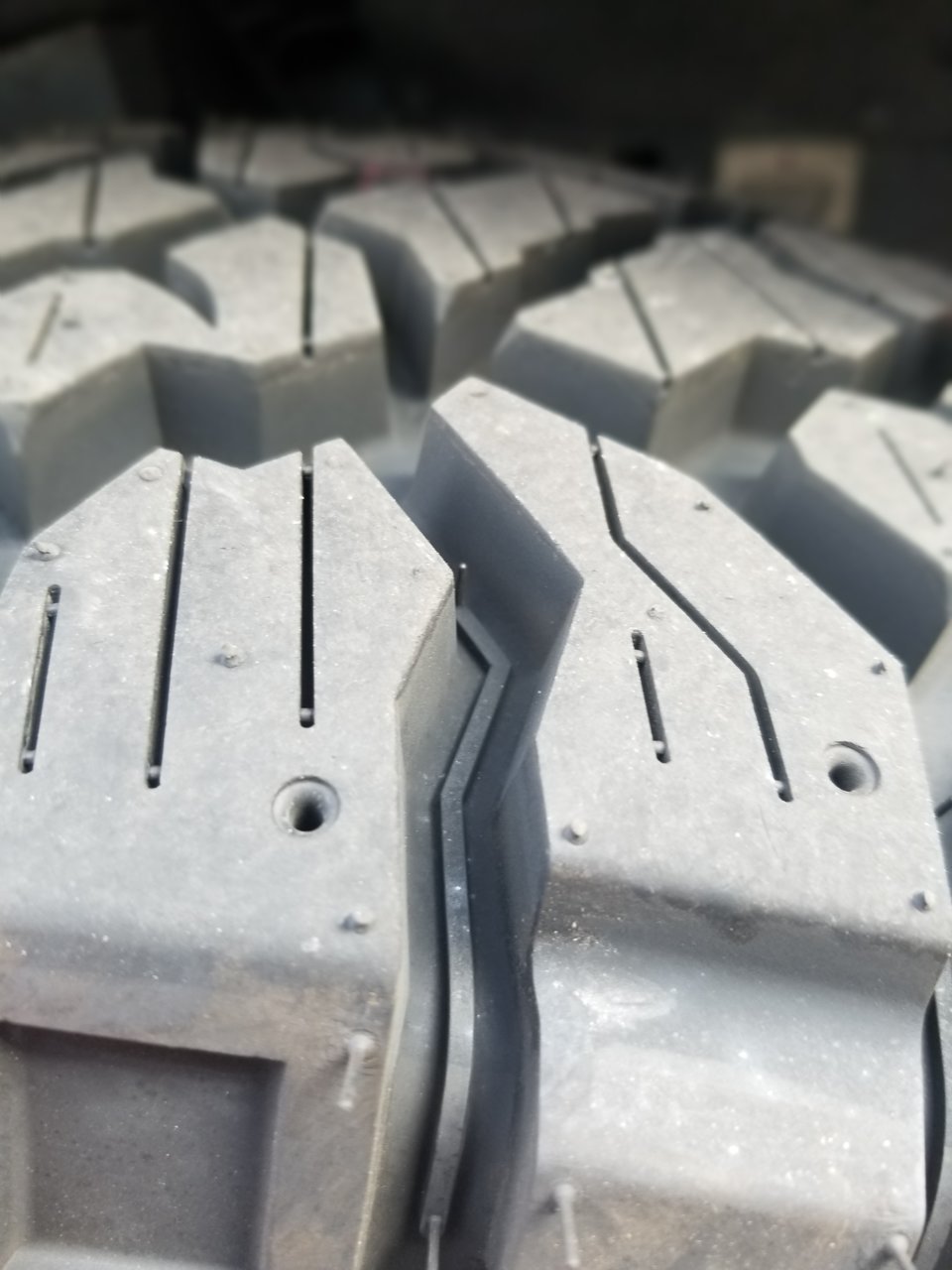

    I was in the market for new AT tires when I came across this thread.
    I was on the fence between the Yoko Geolanders AT in 315/70/17 and these Kendas RTs. (I know, apples to oranges) After conferring with @Lord Humongous, his 1st hand experiences with my tire choices pushed me over to the Kendas....and his suggestion to wait for the sale price saved me another $80!
    I received my Kendas from Walmart in 3 days. Got them mounted today. Wheel/tire balanced fine. These 35x10.5x17 Kendas were taller (35" vs 34ish") but narrower (10.5" vs 12.5") compared to the 315/70/17 Kumhos that they replaced.
    First impression: Love the rugged look of the RT tire over the AT. And LOVE the skinnier tire over the 315/70/17 in appearance because there's less tire sticking out of the fender

    Looks so good on those wheels and the ggressive sidewalls look awesome! Glad you could them at the sale price too!

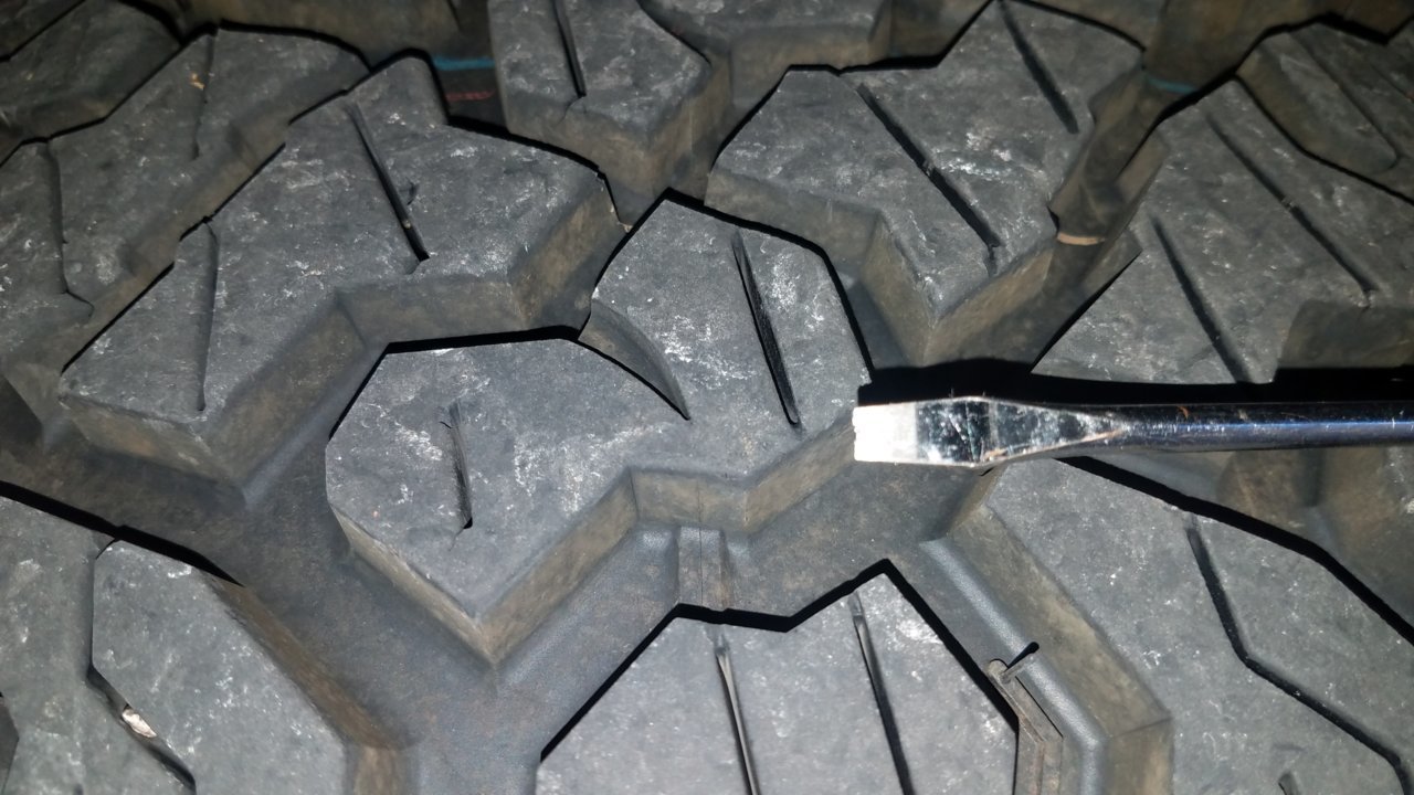

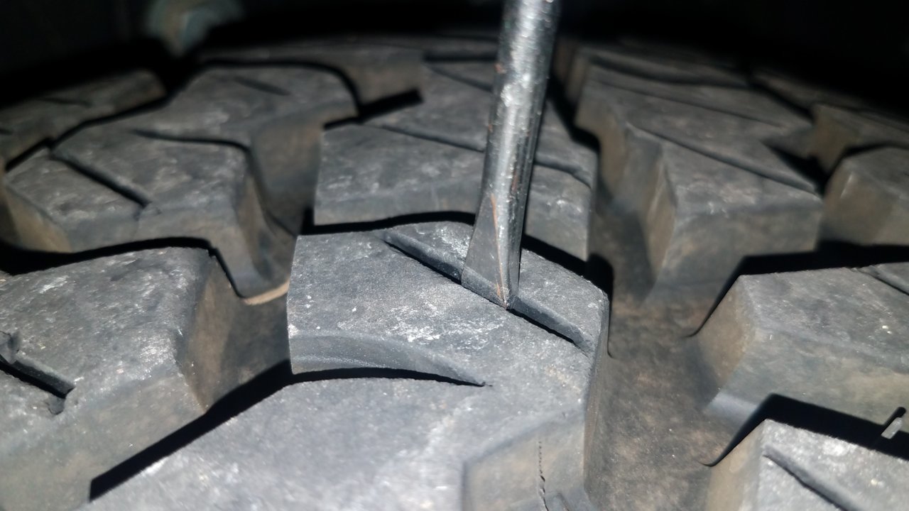

    Do they have full depth sipes? Glad to see some taller skinnies come out.

    I'd get about 10k miles out of those sipes. =/

    I think the sips are cupped on the sides. My screwdriver test says they're full depth.

    Looks like they would quickly become an MT. That was one reason that I decided on the Falken Wildpeak AT3/W over the Cooper ST MAXX.
