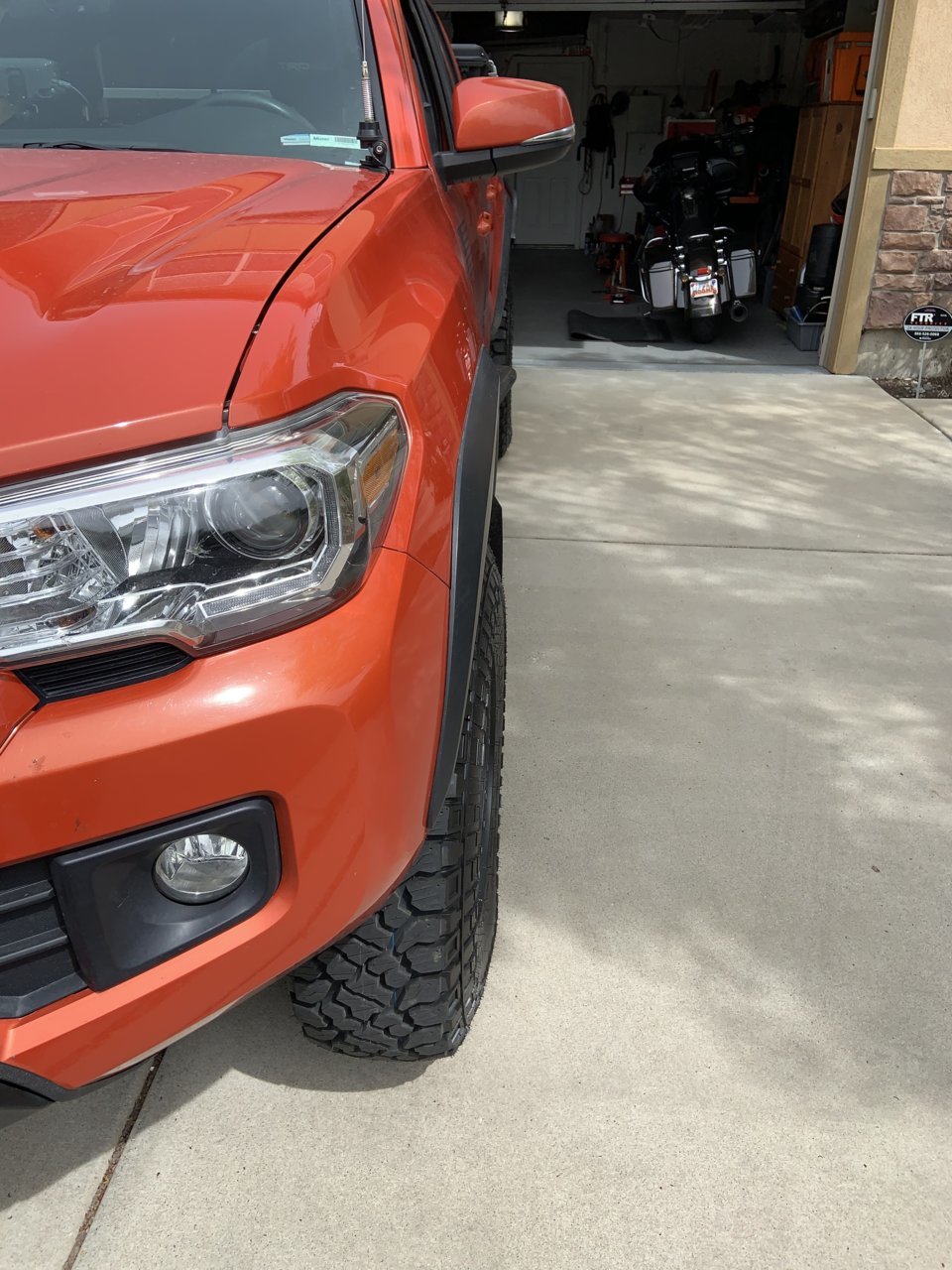

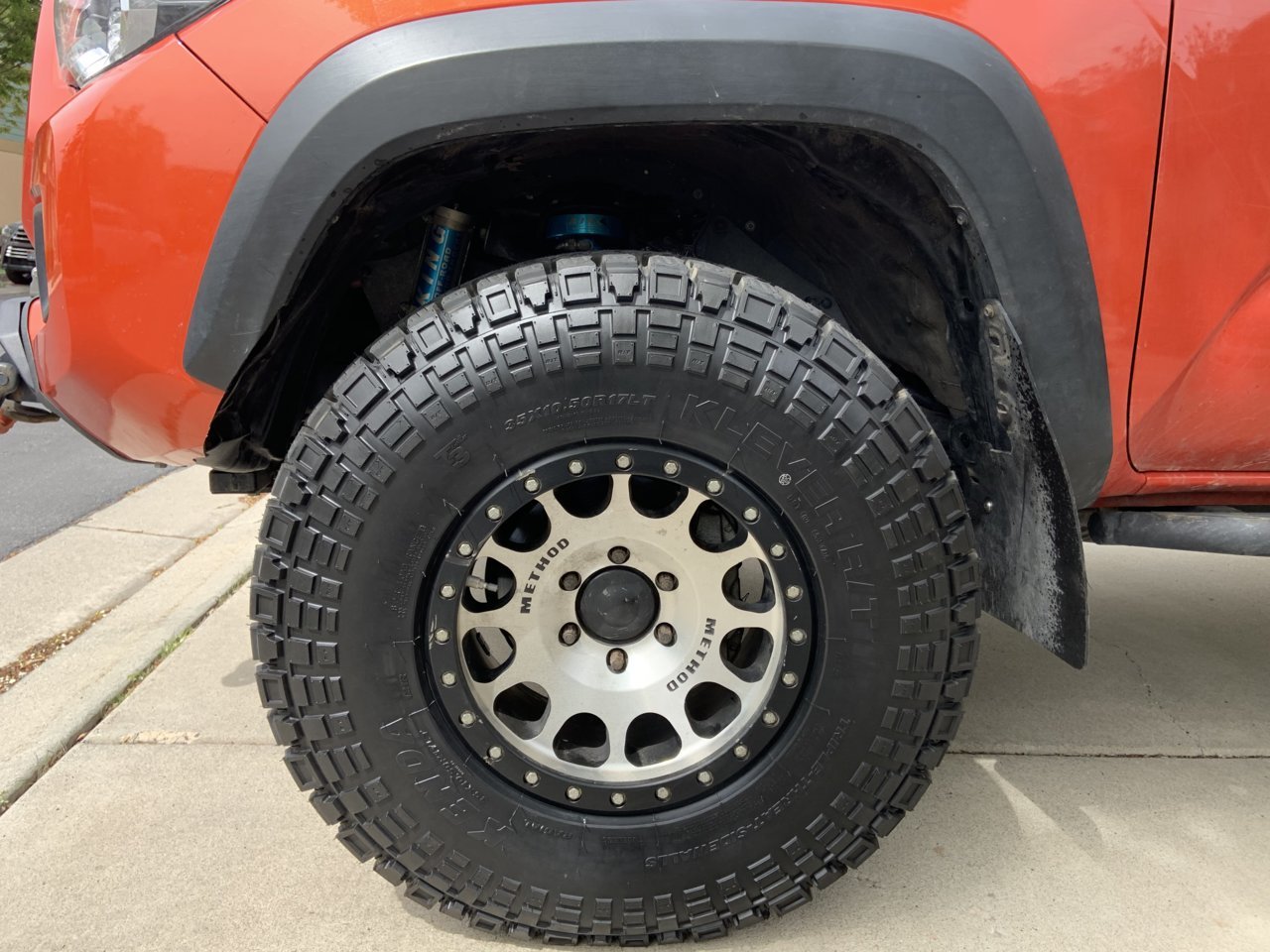

    Finally got them on. CMC, LCA full forward, seam smashed, and front top fender well beat in. Not rubbing on the street. They will still rub at full stuff on inner front fender well. That needs to be tubbed as I want full up travel for wheeling. Method Race 105s 17X8.5 Offset 0, Tires Kenda Klever 35X10.5X17.

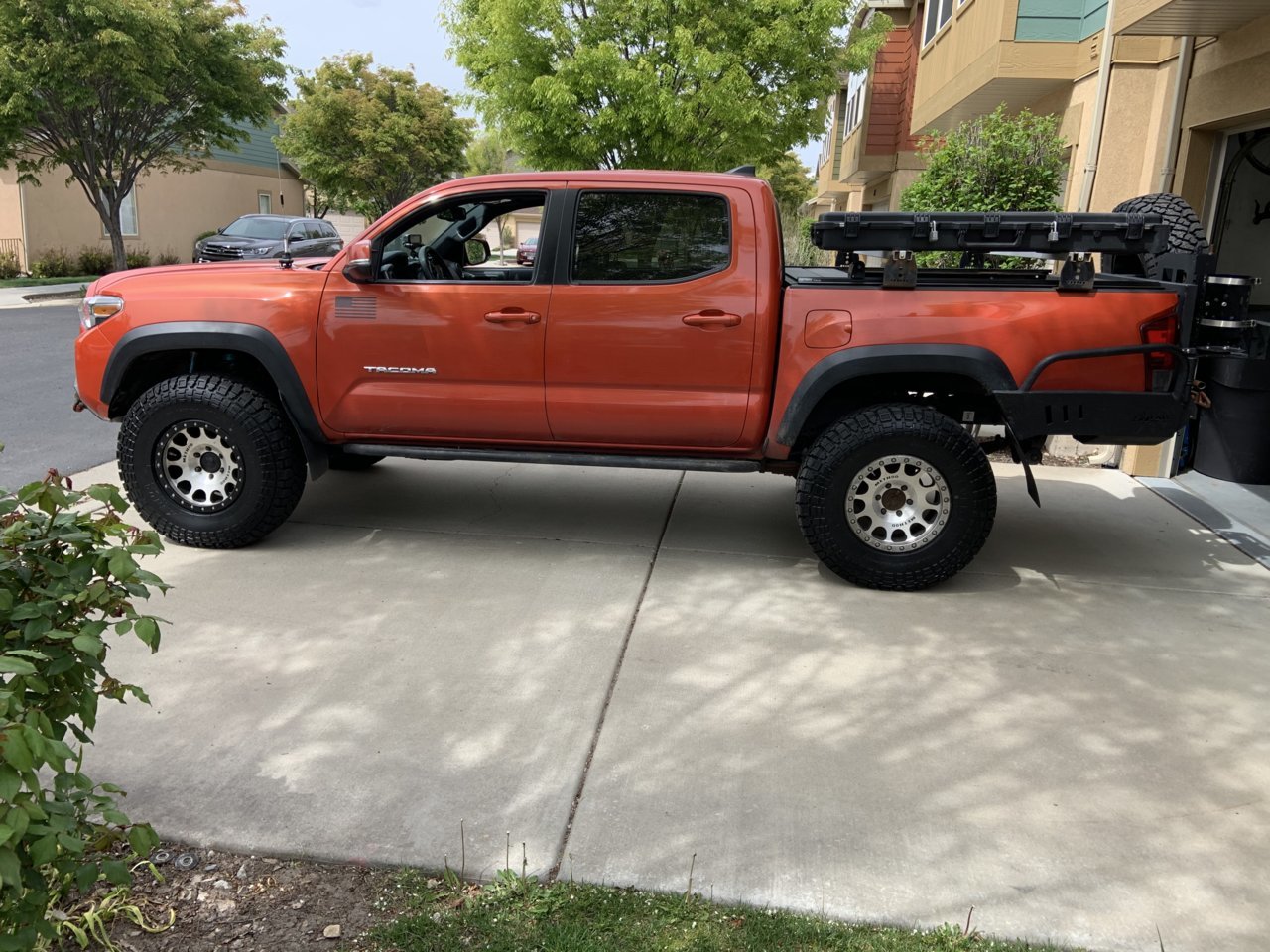

    Met up with @ETALATE to talk trucks and these Kenda tires. Here's a quick photo of three different 35" tires sizes and manufacturers.
    (From L to R)
    315/75/16 Coopers
    315/70/17 Goodyear Duratracs
    35x10.5x17 Kenda Klevers
