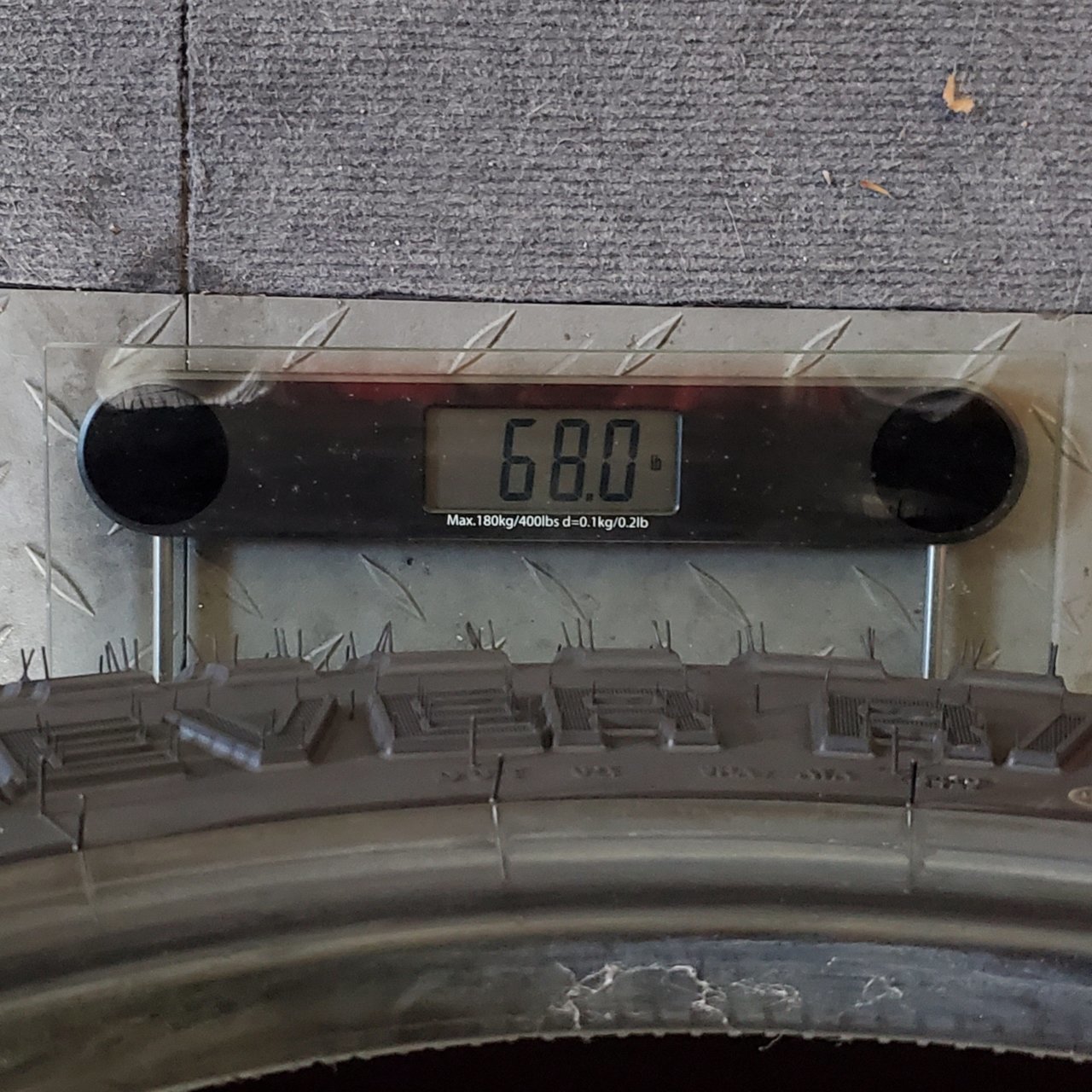

    holly that is one heavy tire. I was hoping they would be lighter then the KM3s being narrower but they are equally as heavy.
    LongDistanceTaco likes this.
