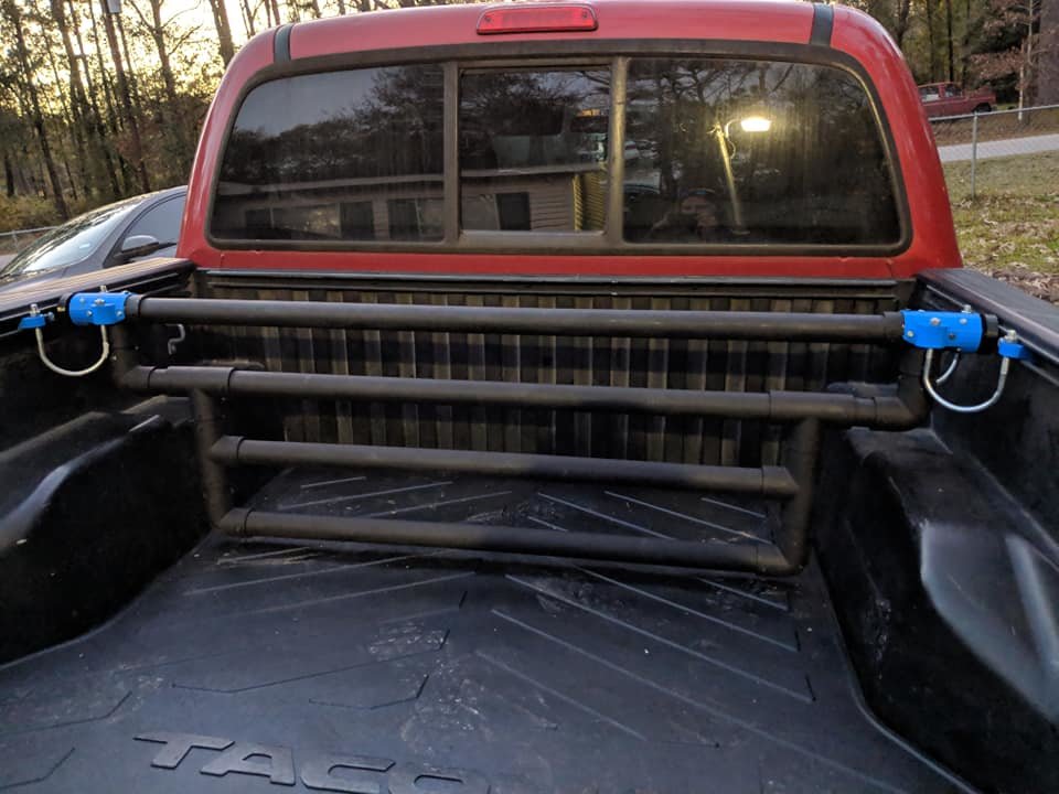

    Oh hell yes! I'll be printing these tonight!
    Out of curiosity, could you do away with the u-bolts and stabilizers if you just sanded the pvc elbows flat on the bottom and had them in contact with the bed? Indicated by the red circles. Do you think that would keep it in place?
    xxxmtixxx[OP] likes this.
  3. Dec 26, 2018 at 6:12 AM
    xxxmtixxx
    xxxmtixxx [OP] Member
    Nov 23, 2018
    #273627
    13
    I'm sure you could. I originally just had 1 foot at the bottom with no u-bolts and stabilizers, but wasn't enough to keep it from swinging.

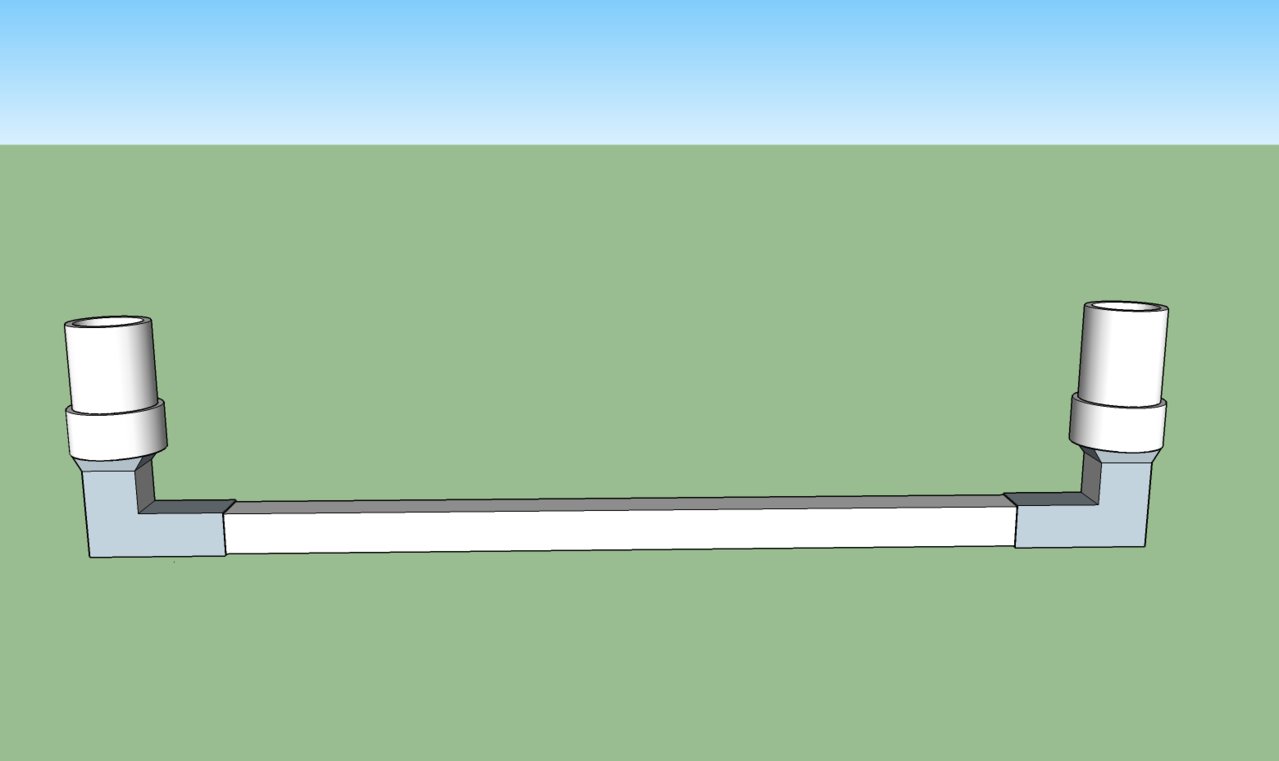

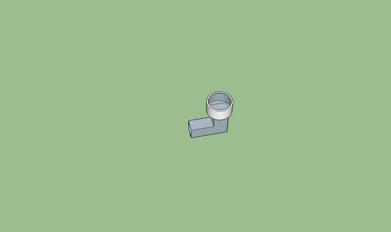

    Just mocked this up real quick. Maybe use this X2 for the bottom along with a length of square tubing along the bottom to keep it from rotating?
  5. Dec 26, 2018 at 6:37 AM
    xxxmtixxx
    Nov 23, 2018
    #273627
    13
    That would give it weight at the bottom and place it against the bed, so it may work.

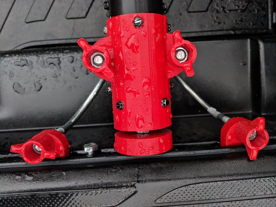

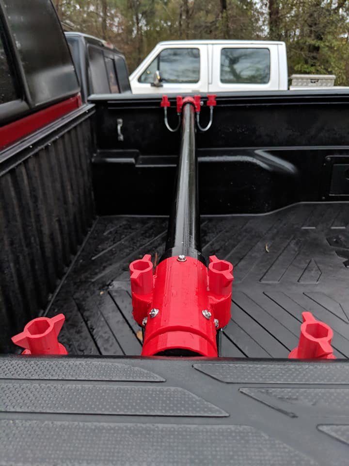

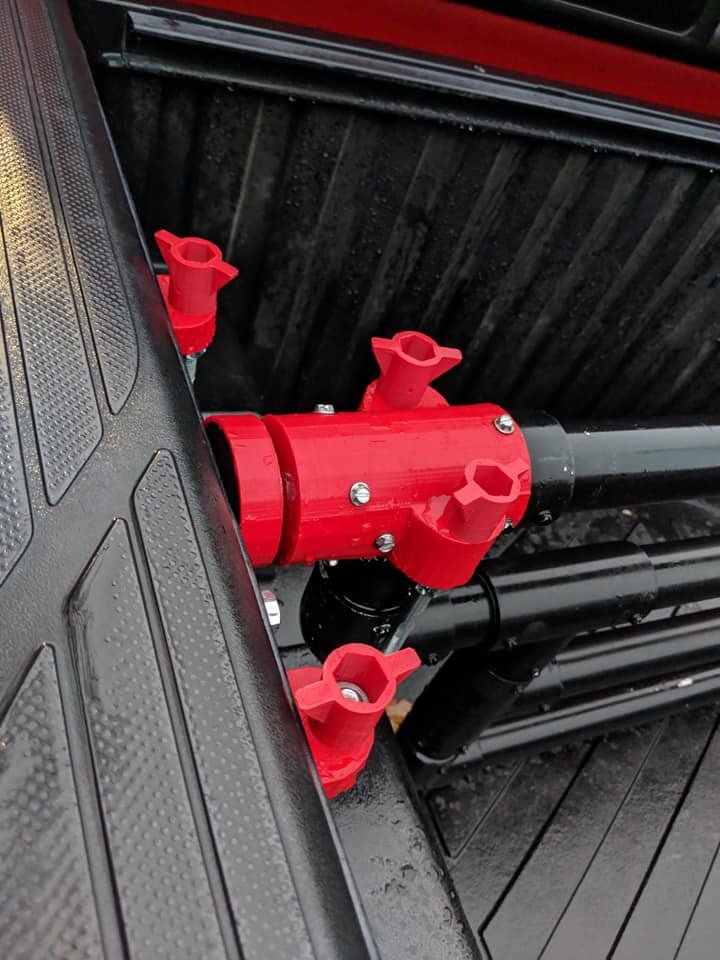

    Made a few tweaks to accommodate for these wing nuts so I could install everything without any tools.
