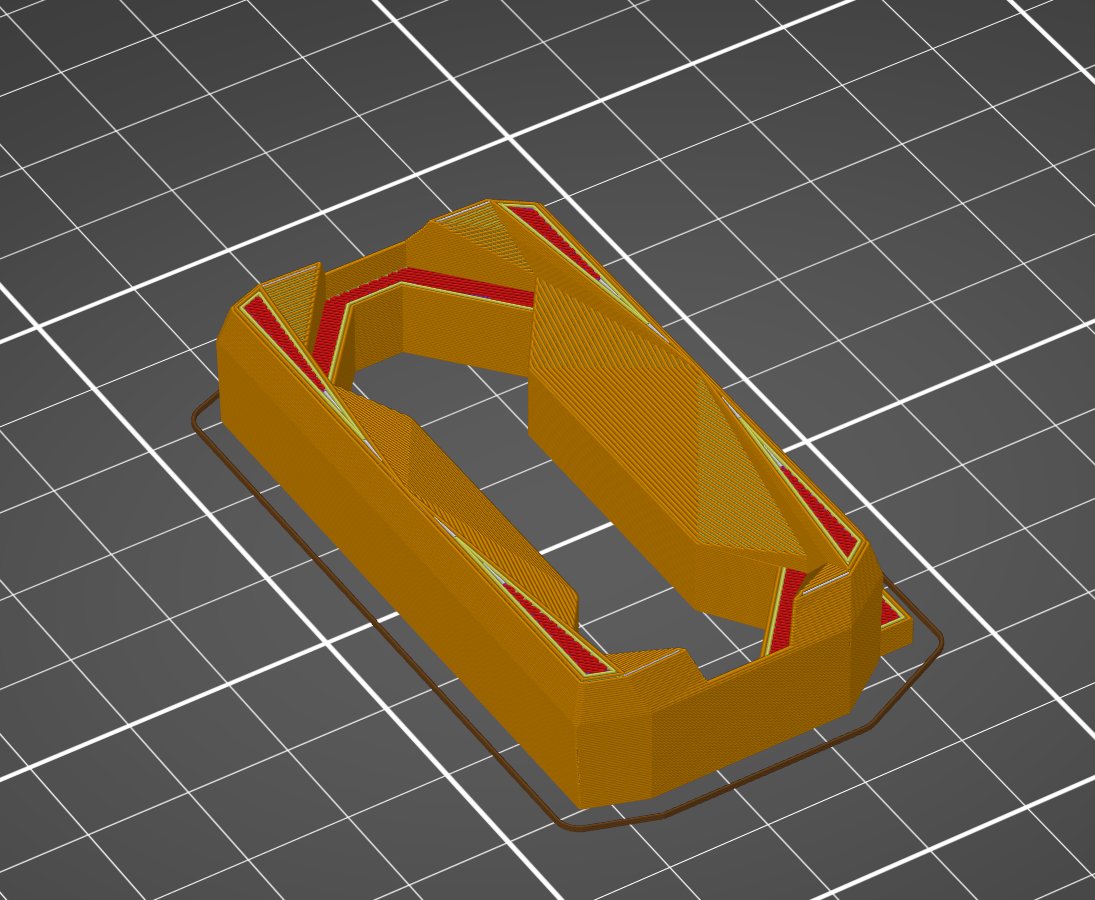

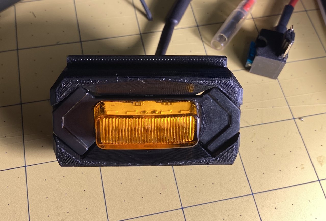

    Printing this version right now, will see how it works and if you can just plug the raptor lights into them. I may clean up the design some if it works with them.

    Nice! I've been working on a similar design to see how they would look. The most important part to me is to make the bezels look flush with the light clip shape. For now, the gluing method seems like the cleanest method for looks, but that may change depending on how well the clip in design I've been working on turns out.

    Did you figure out why your software was screwing with the vertices so badly?
    I have a flush mount on top design already, but to get the height I want in the part, I have to do some supports for the clips to go in, which makes it harder to remove the lights. I kinda like the sunken in method because I can print a part with zero supports and it's easy to remove the light, I just got to figure out how I want to curve in the design to the lights to make it cleaner. I can also do a bit smaller of a gap to make bridge easier with zero supports, which I may try to see if this ABS can handle it.

    Sunken ones came out pretty decent. Need to clean up the tolerances a bit. But works well.
