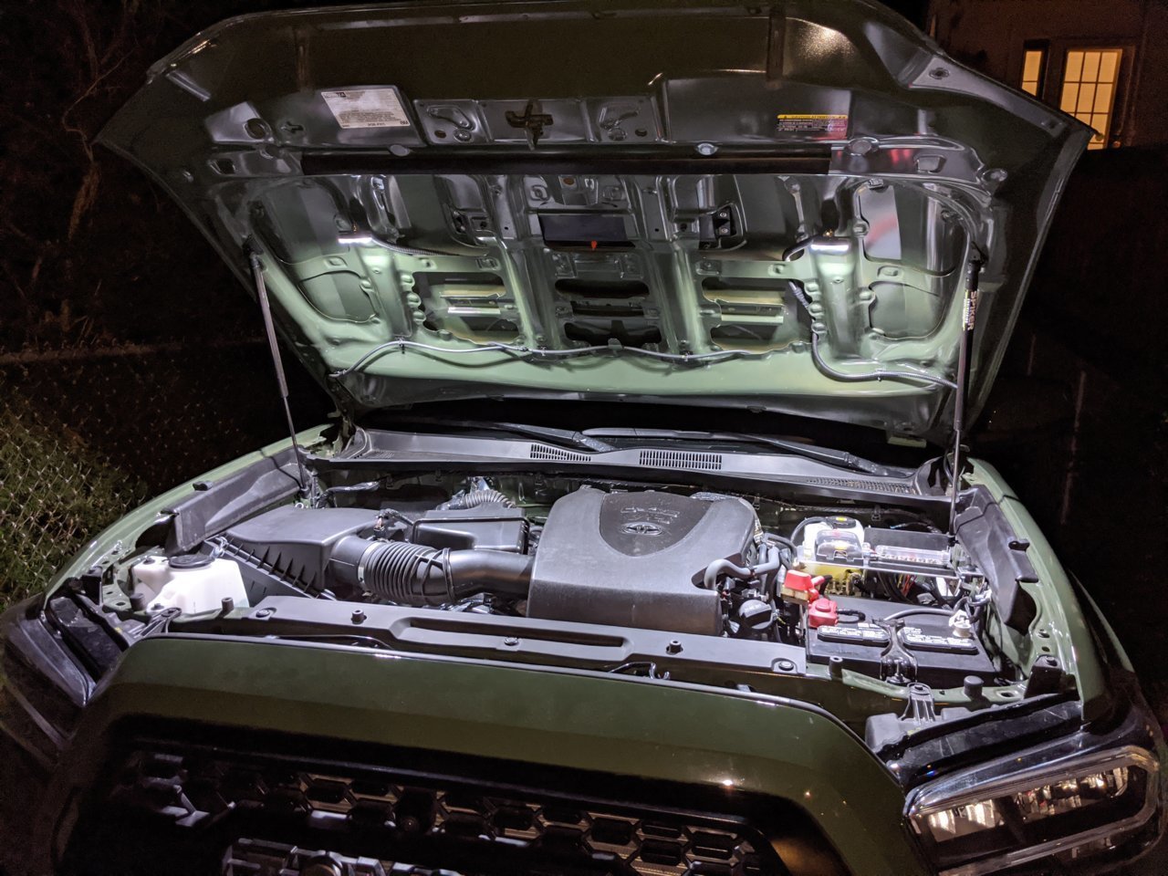

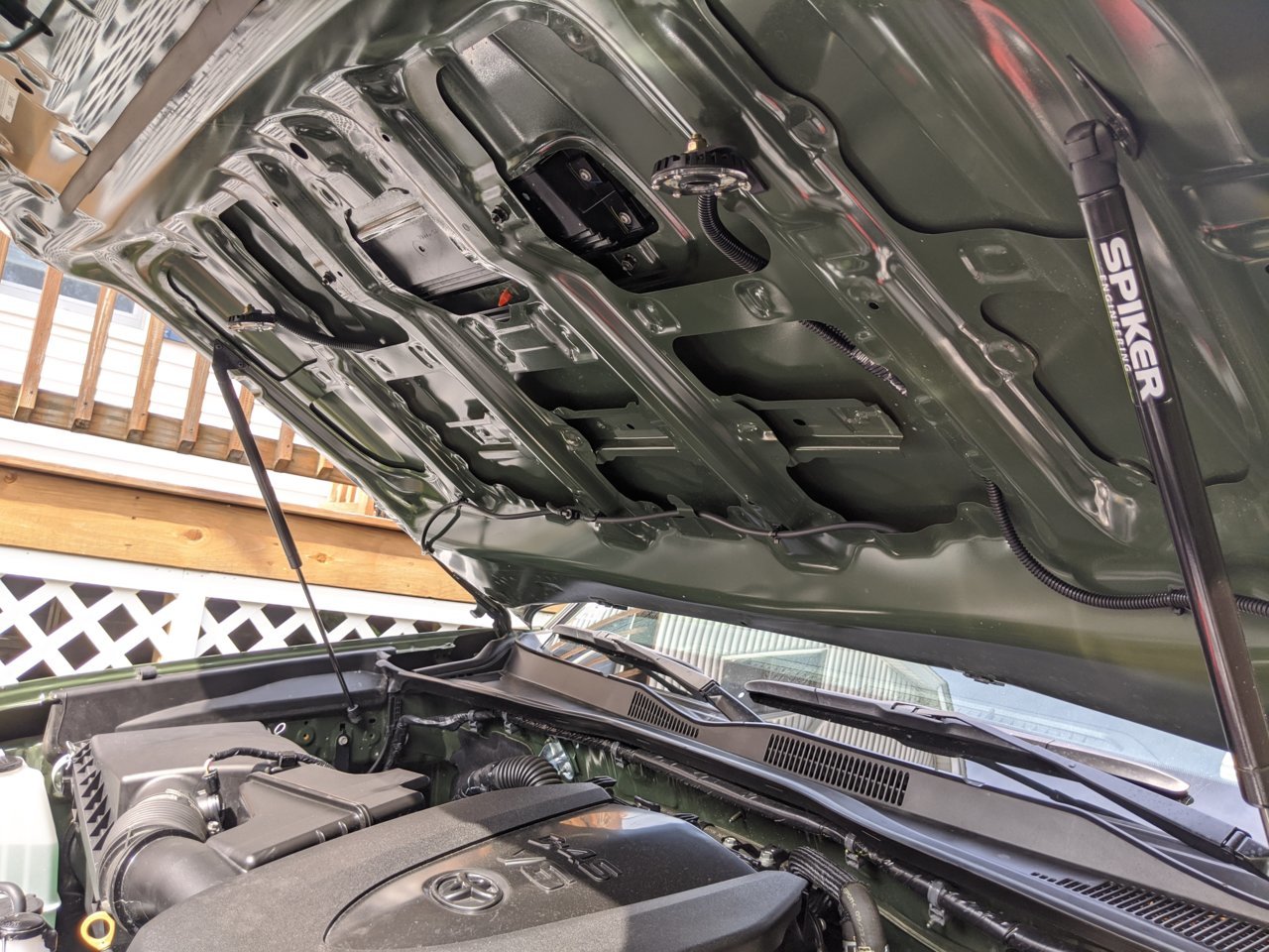

    Got around to installing mine today drilling some holes and using the provided hardware. Mine are mounted with the KC cyclones under hood lighting kit. I'll have to to add some pics later when it's dark out.

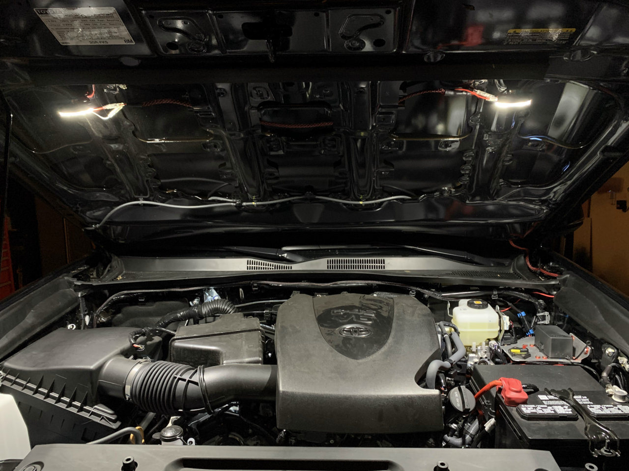

    Just now getting around to getting these installed and the pic uploaded. Going to have to say I got super uncomfortable drilling the holes but took my time and added at plastic tube to stop the bit from going too far. It turned out perfect. Got it all hooked up to my busman box and ran it through a grounded switch so the lights come on with the hood is opened. Thanks again!

    Thanks for sharing pics! Drilling the hood is very sketch the first time, many people do it to install hood struts, you can get a drill stop for your bit as well to protect against that. Unfortunately that's the only way for 3rd gens.

    Forgot to post the lights at night pic in this thread. The angle of the mount is perfect. Thanks again IMG_20200924_200302.jpg
