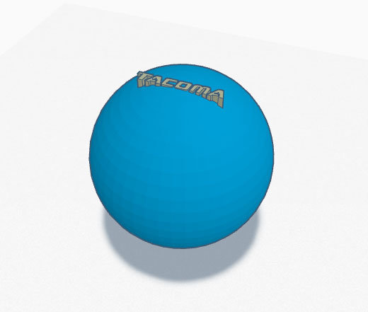

    initial design, Have to wait and measure the insert still and may turn that logo into a hole instead of raised.

    Definitely! That would not be comfortable the way it is. Tinkercad has a hex object to it will be easy. I would make it .1mm over your measurement and go from there. You could make a simple 5mm tall block and combine the hole-hex to make a quick test print for fit before you make the whole thing. Save on some filament.

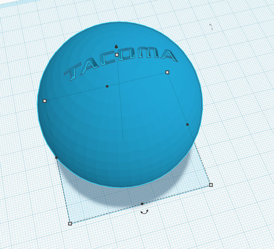

    latest... got the nut today, 20mm wide should leave enough but i'll do a test once I get my build surface.

    so for the final build, I should probably slice it in half and print 2 halves with screw holes, correct?
