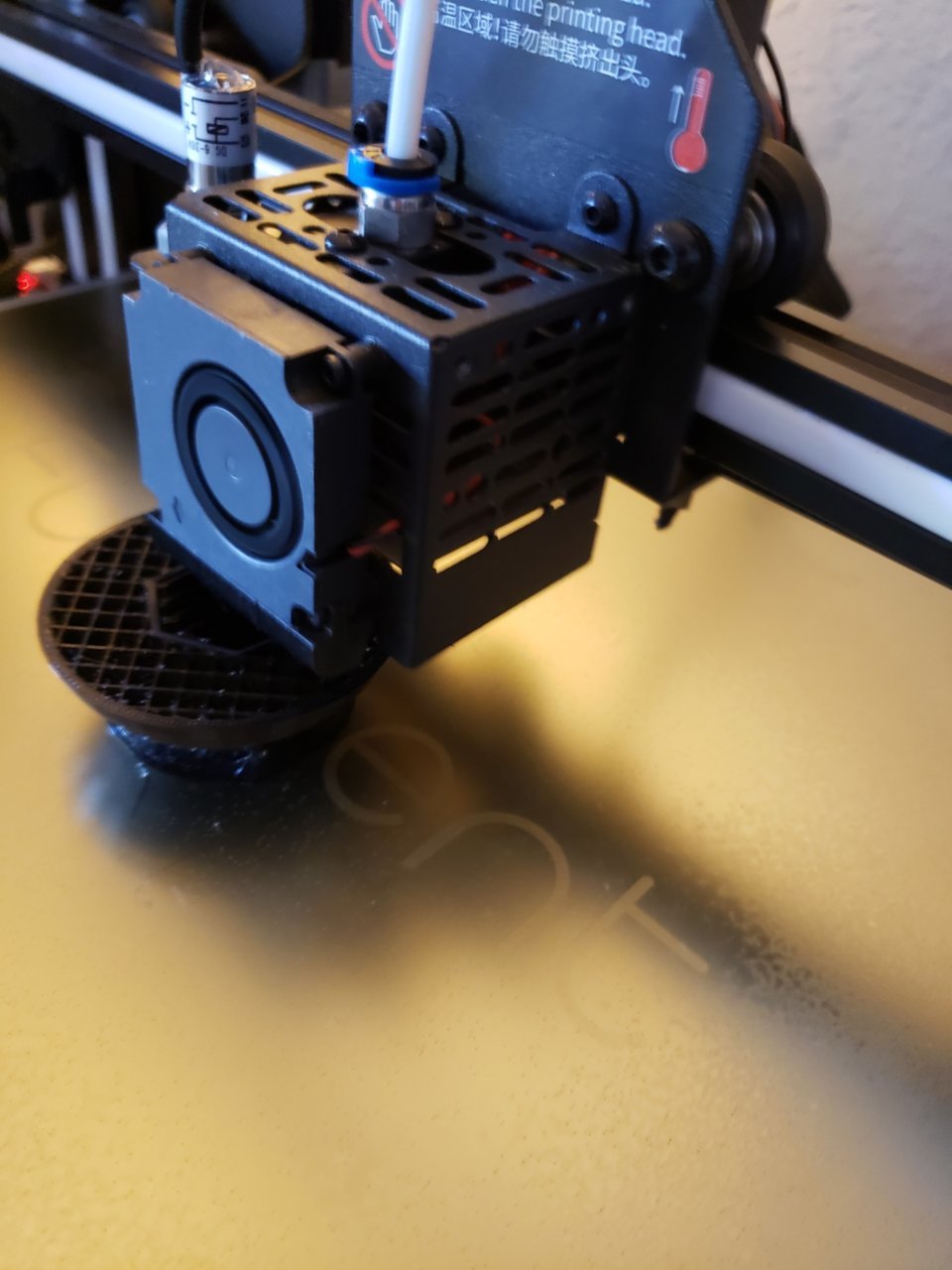

    You could always just pause the build once you're at the top layer of the coupling, drop in the hex nut, and then finish the print. Or if the nut hole is set up to be way at the bottom, just drop it in at the end.
    Use tree supports and a brim on that, though.

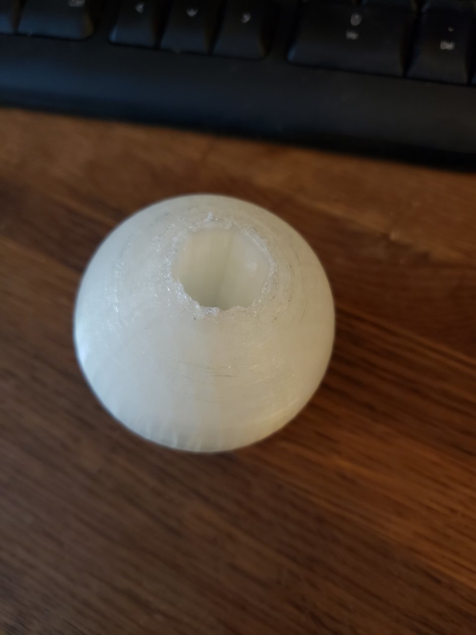

    test print for the shifter knob. just gonna check size and density.

    1st prtotype. the nut dimensions need to be bigger, by about 5mm

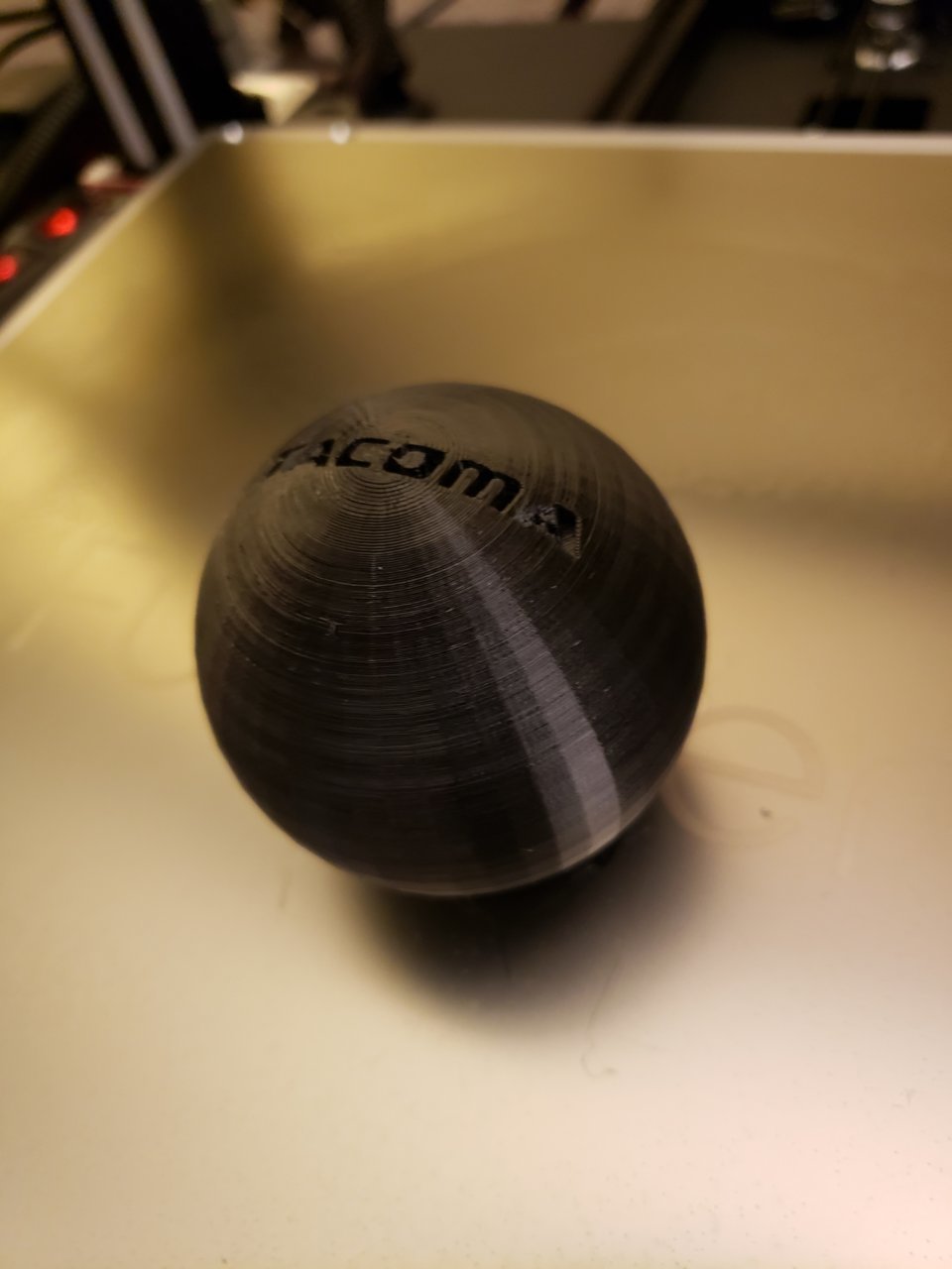

    switched to black PETG, should be done later tonight.

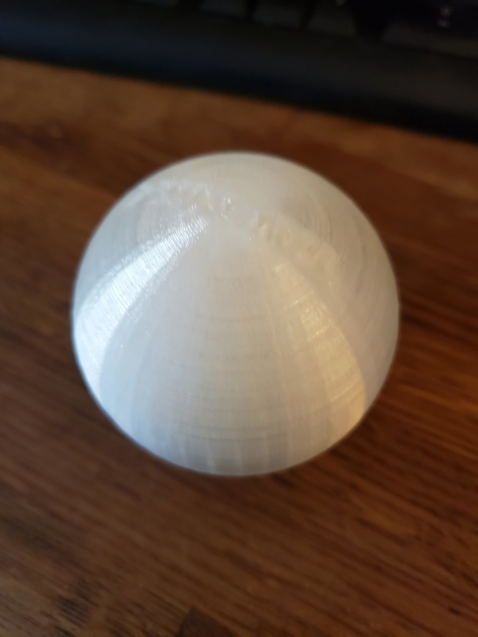

    came out great! nut fits perfect too. Next stop, test fit in the truck. if it fits, i'll coat it in acrylic clear and epoxy the nut.

    fits perfect. Just need to coat it in acrylic and set it with some epoxy.

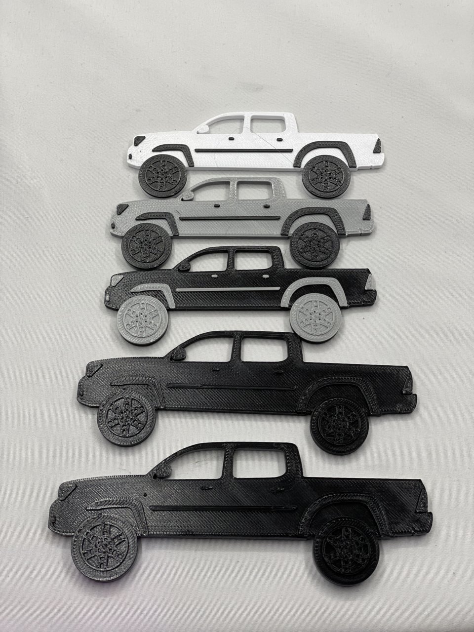

    Just bought a Prusa i3 MK3S and designed my own tacoma and printed some prototypes. It isn't done yet I have 4runner TRD wheels on the little taco and it kept breaking when I would slice so I made them big but I do not like how big tires look. Any recommendations are welcome or changes. I am working on a 3rd gen front end and side truck right now.
