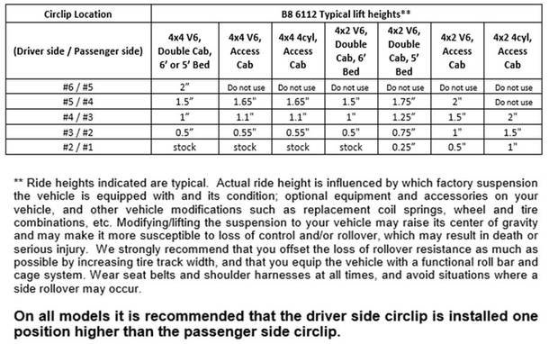

    On the 6112’s they have a recommended setting for desired height of lift per truck you put them on. So what truck you running and what did you set them at?

  11. Aug 1, 2020 at 8:45 PM
    MadKatt
    MadKatt In need of serious help..
    Dec 14, 2019
    #313265
    1,330
    Frozen tundra
    2019 TRD OR DCLB Calvary Blue
    On Headstrongs webpage here are the settings for the 6112’s.

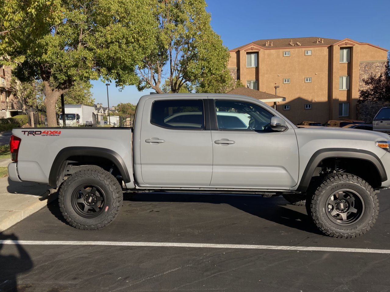

  15. Aug 1, 2020 at 11:39 PM
    pejhwm11
    pejhwm11 [OP] Member
    Mar 8, 2020
    #321641
    21
    Ve
    014934AB-2D06-4BF9-90F1-A5AD9B54CA12.jpg Thanks for the advice bro. Sorry it’s because I’m new to the taco forums and to lifting. I’m asking these information because I had took my truck to a local shop to do the lift and it was just a little off because the rear was lower then the front. I had even ask the shop that I wanted the truck to be level.

  16. Aug 2, 2020 at 3:24 AM
    #16
    Xer0 SiN
    Xer0 SiN Well-Known Member
    Mar 16, 2010
    #33334
    1,770
    Hilo, HI
    19 TRD SPORT TACOMA / 21 LIMITED RAV4
    this and that...
    the truck looks good dude. just leave it like that.
    Jukeboxx13 likes this.
  17. Aug 2, 2020 at 4:27 AM
    #17
    MadKatt
    Dec 14, 2019
    #313265
    1,330
    Frozen tundra
    It looks good, as stated drive it awhile let your oem leaf pack wear out some more then upgrade to a better pack. Should give you years of use at that point.
  18. Aug 2, 2020 at 5:30 AM
    #18
    71tattooguy
    71tattooguy Well-Known Member
    Dec 19, 2018
    #276275
    5,558
    Dino
    Petaluma , Ca (707)
    2019 DCLB TRD OFF- ROAD
    Kings 2.5” front and rears from Accutune / ICON RXT LEAF PACK black badges doors and tailgate / method 315 / 255/85/16 Yokohama G003 / magnaflow exhaust , axle dump / meso int delete kit / meso led map lights / dome lights / wheelers front super bumps / accutune Flip kit with spacer and new bumps / Cali raised fog light pods / Cali raised ditch lights / RCI FULL SKIDS / SLIDERS / RCI rear bumper / rigid backup lights / tuned on 4.88’s
    You could put 1” block in rear? Also Overload back in will give 1/2” I believe. Plus a shim. Just my 2cents. Your truck does look sick bro. Not taking away form that.
