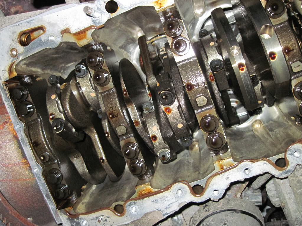

    Current: '21 Bronco Badlands. Previous: '06 TRD Access Cab, v6, 6-speed
    Besides making for some low-hanging hardware, the diff drop on the 05+ trucks rotates the differential so you have the added benefit of shifting the differential fluid away from the pinion bearings. :thumbsup:
    Hell yeah! Same goes for my engine. Oil on moving parts is SO overrated!
    As an added bonus I got to see this part of my truck, which was nice.
