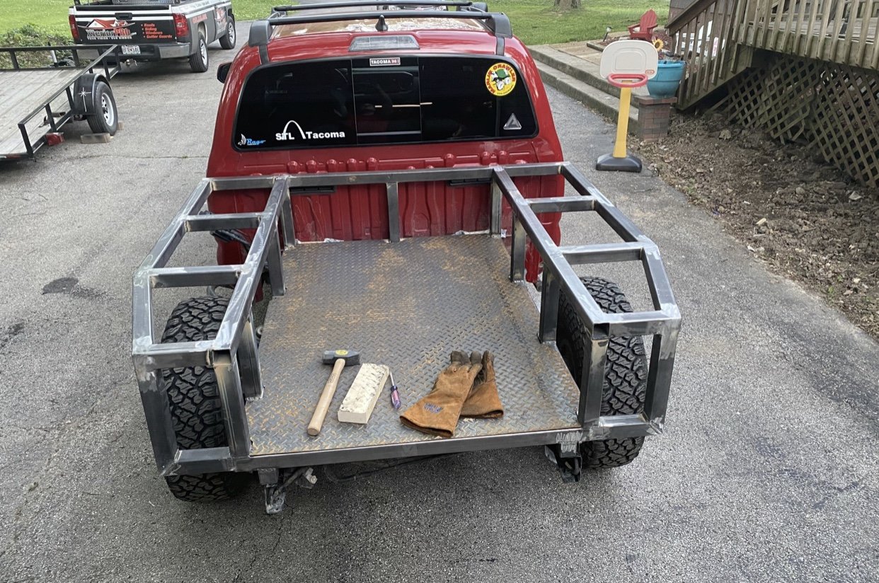

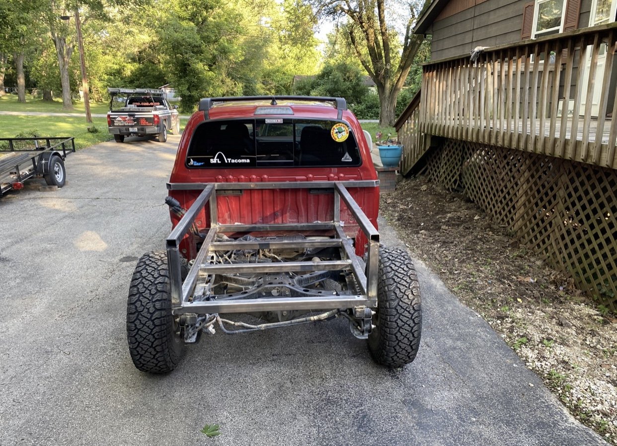

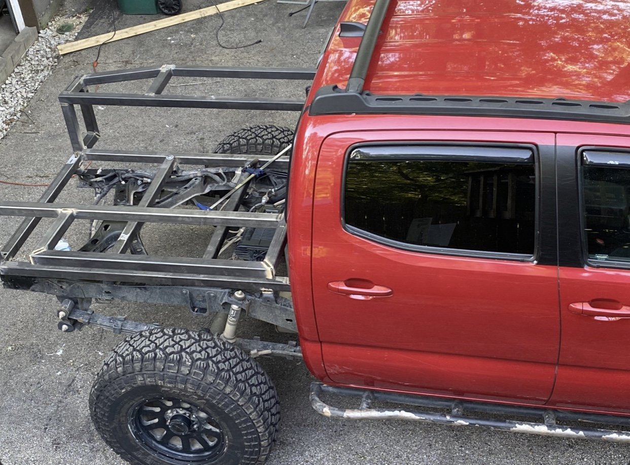

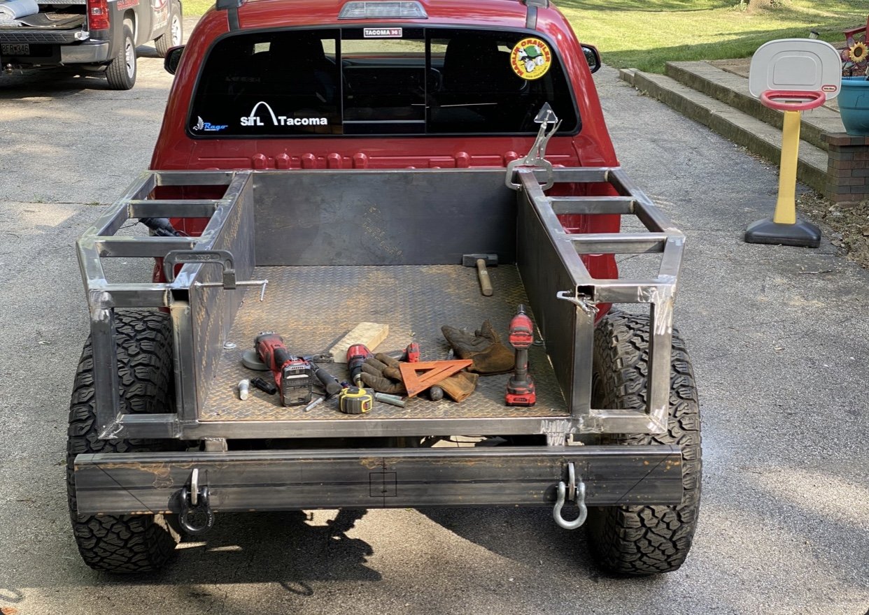

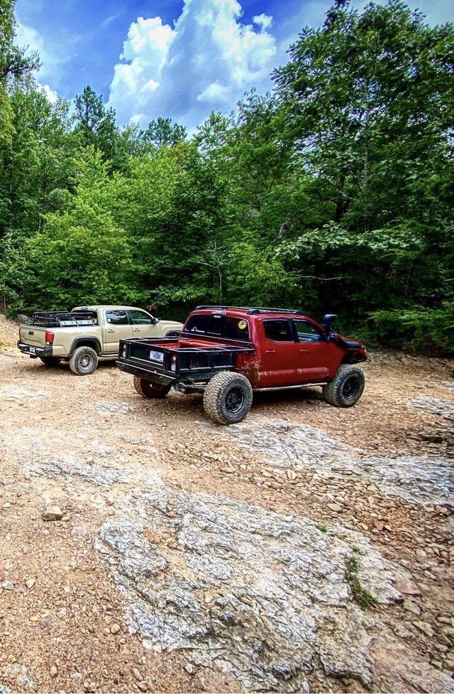

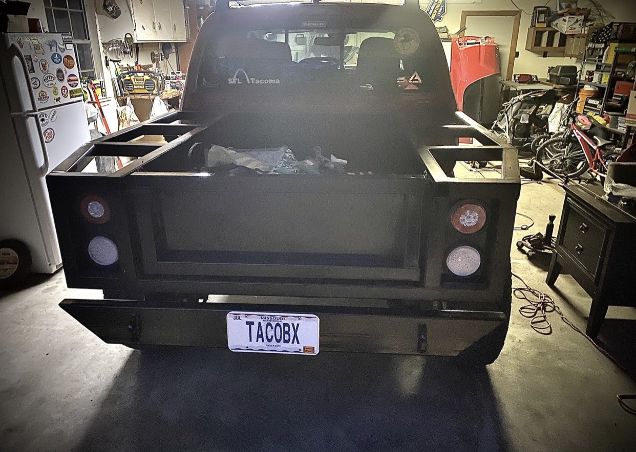

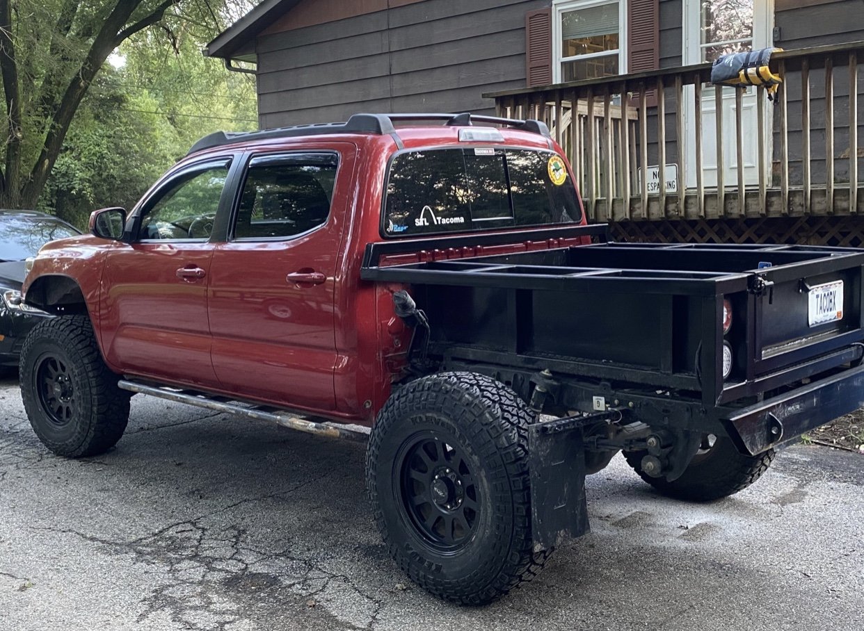

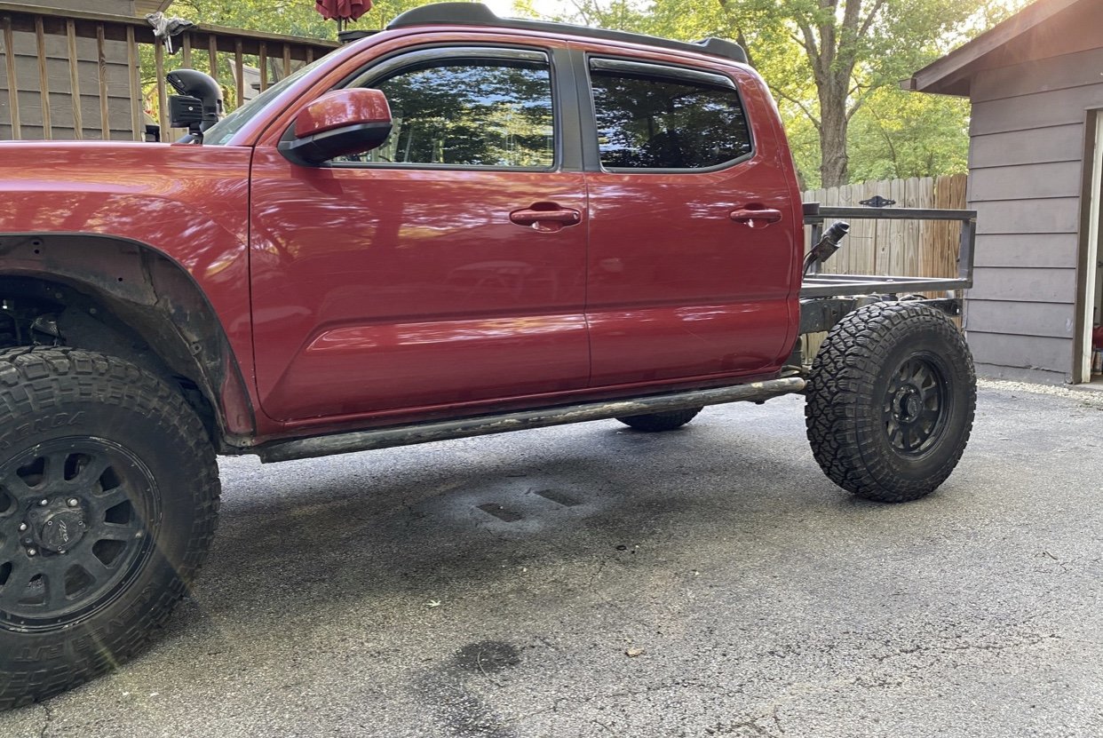

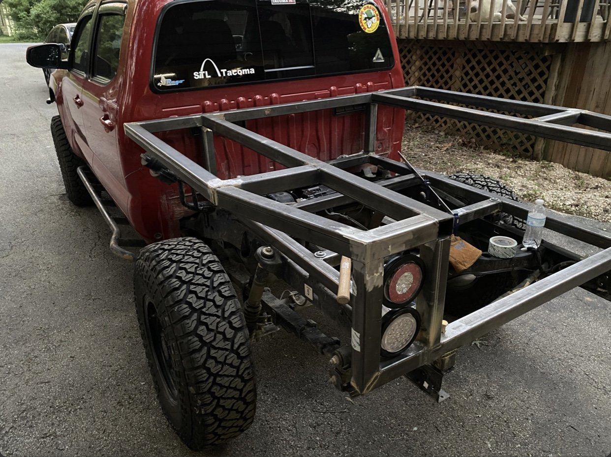

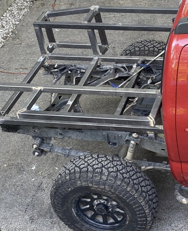

    So I built this awhile back but never made a thread on it. Have a few questions on it now and then so maybe this will help! So this will be “looking back” to show the progress.

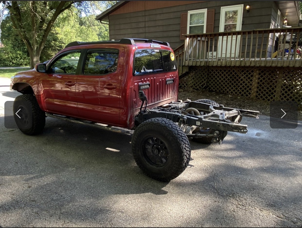

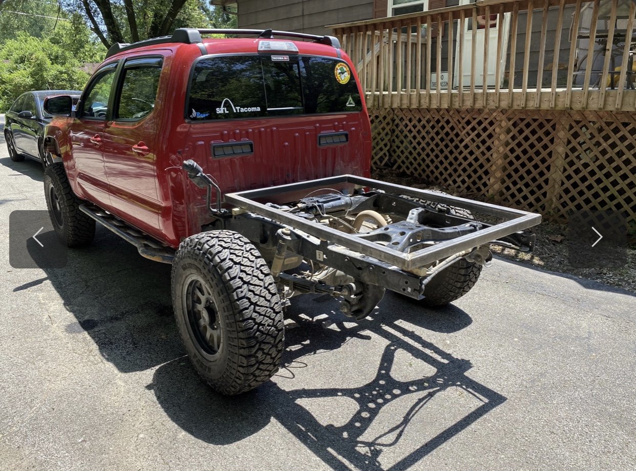

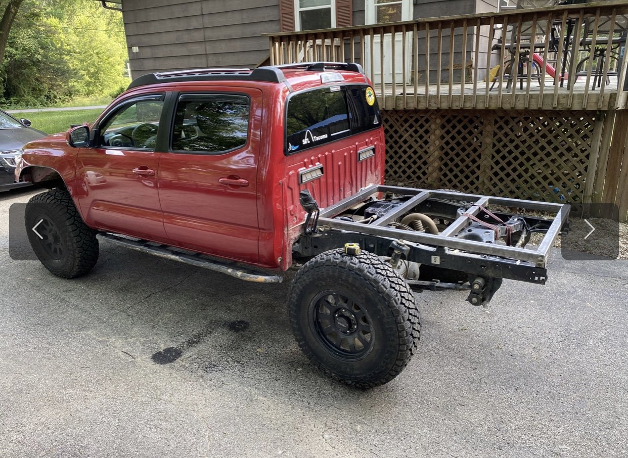

    Start- remove bed
    Now build base
    Time for braces, gussets, sleeve the bolts for mounting “feet”

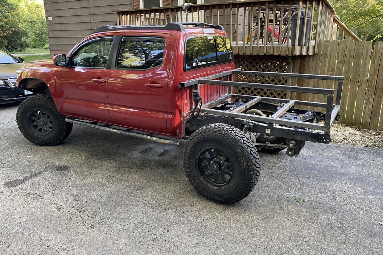

    Starting the skeleton
    Lights are temp mounted ^
    Then I started with the floor, sides and top

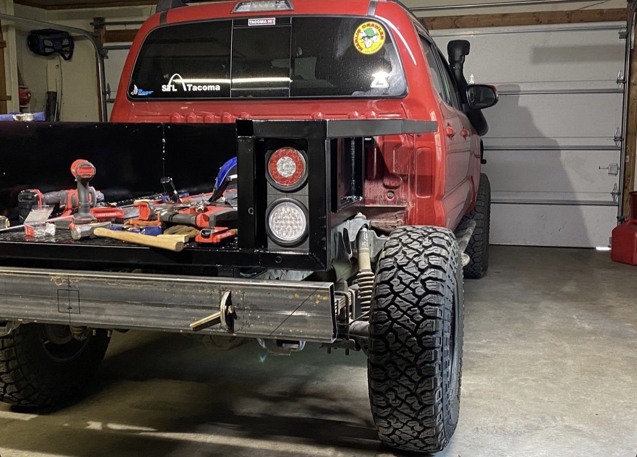

    Bumper, bolts directly to frame (not to bed, this was a question lol)

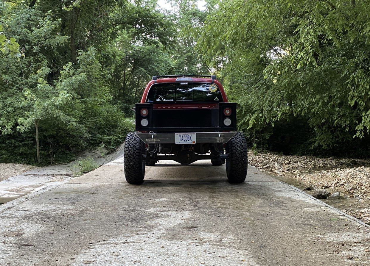

    Super fast forward to bumper being cut, all sheeted and painted. Light buckets made, etc
    It was time for a tailgate, needed a license plate mount and rear camera location.

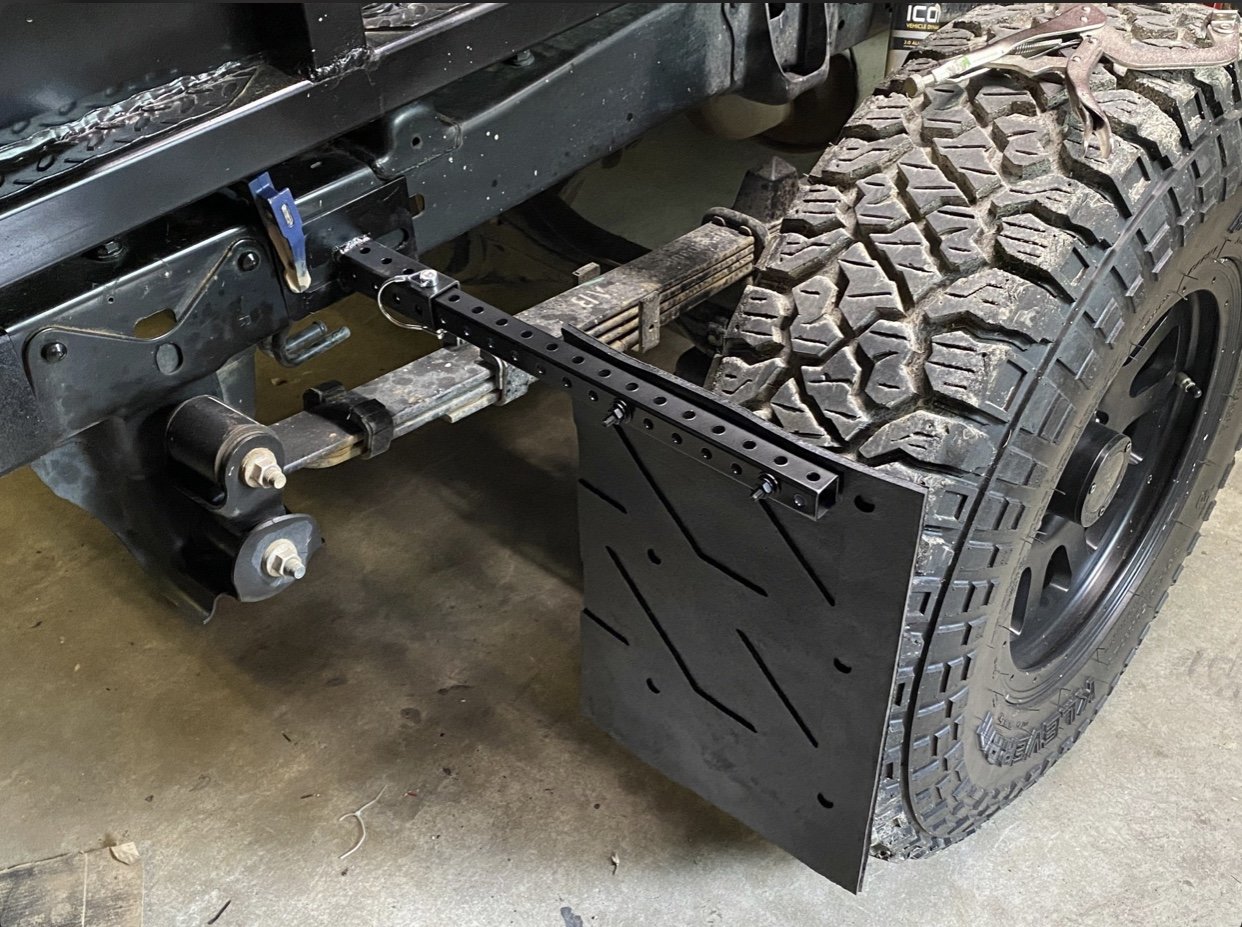

    Whipped up some quick detach mud flaps
    Added the short cross bar to the top, it is really just there to stop our four wheeler bumper from breaking my rear window

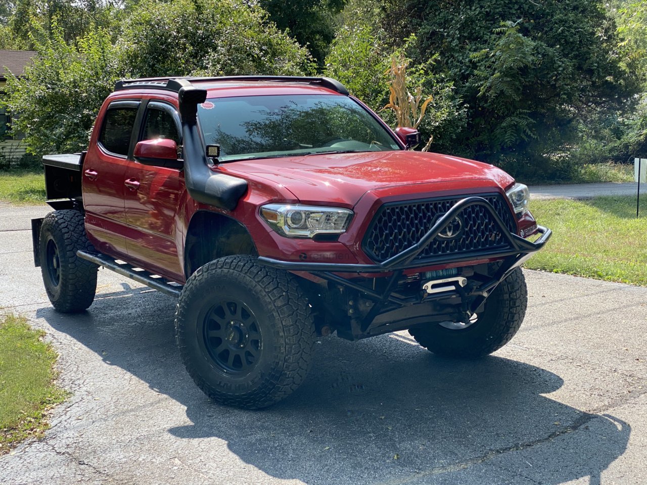

    If you read all that and are not bored, here is up to date photos.

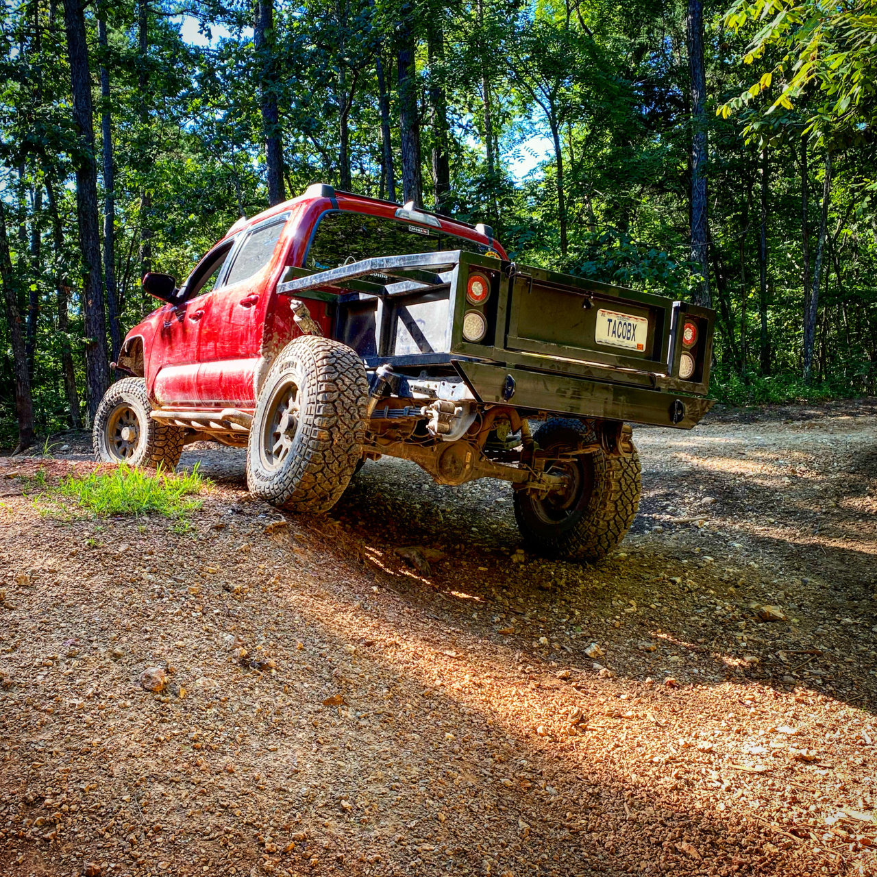

    Things to note:
    -I still have my stock bed for when I decide to sell my truck for a raptor
    -This bed bolts down to the existing factory bed location
    -Lights did hyper flash with the new leds. Added resistors and that went away
    -I did not loose much usable space with this bed. I can still load up my 3 kids and all their stuff and head to the lake, fishing poles and potty chairs and all

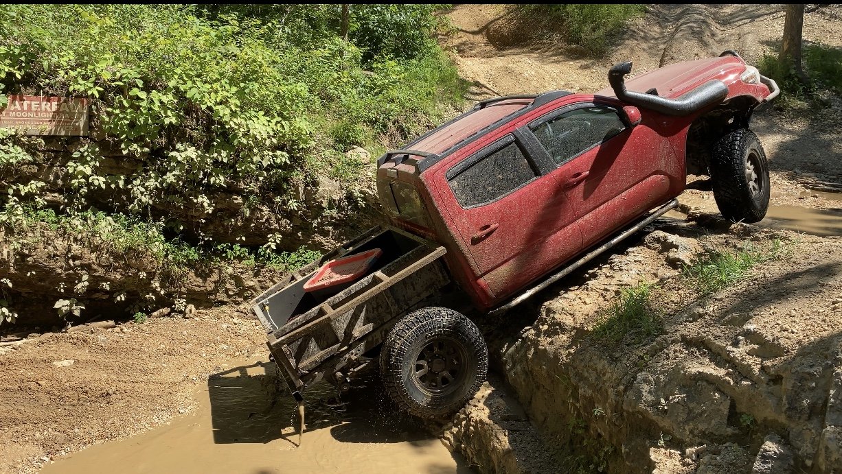

    -It’s not a flat bed, it’s an Offroad bed. Purpose built because my factory one is all dented. Yes, I get it happens when you Offroad, but it was a lot of fun to build this
    -I’m not a professional welder, I literally just started welding earlier this year. So no, I have no desire to weld other peoples stuff.
    Like it or not, it was fun to build. It’s not done but I’ve lost motivation and got caught up with time, and life.
    Here’s those pics that were mentioned-

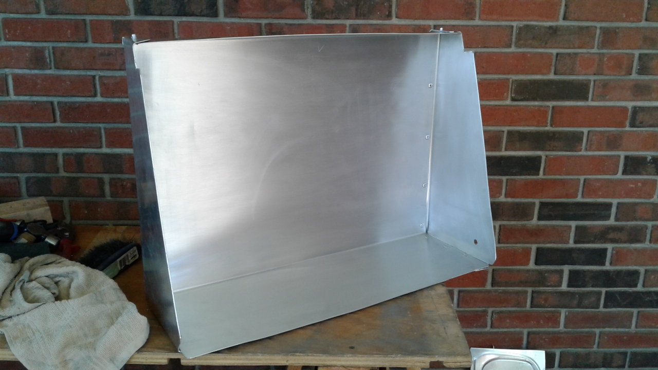

    Looking for a company to make me some side boxes to mount underneath the sides. Want them angled so I can use them as support for a fender. Need to close off that wheel well something fierce.
    So if any of you know of a place, let me know. I tried one place but they were expensiveeee
