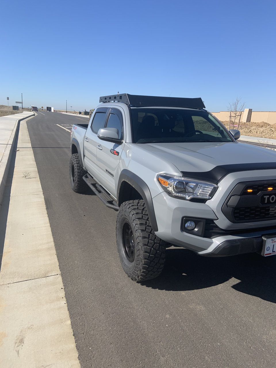

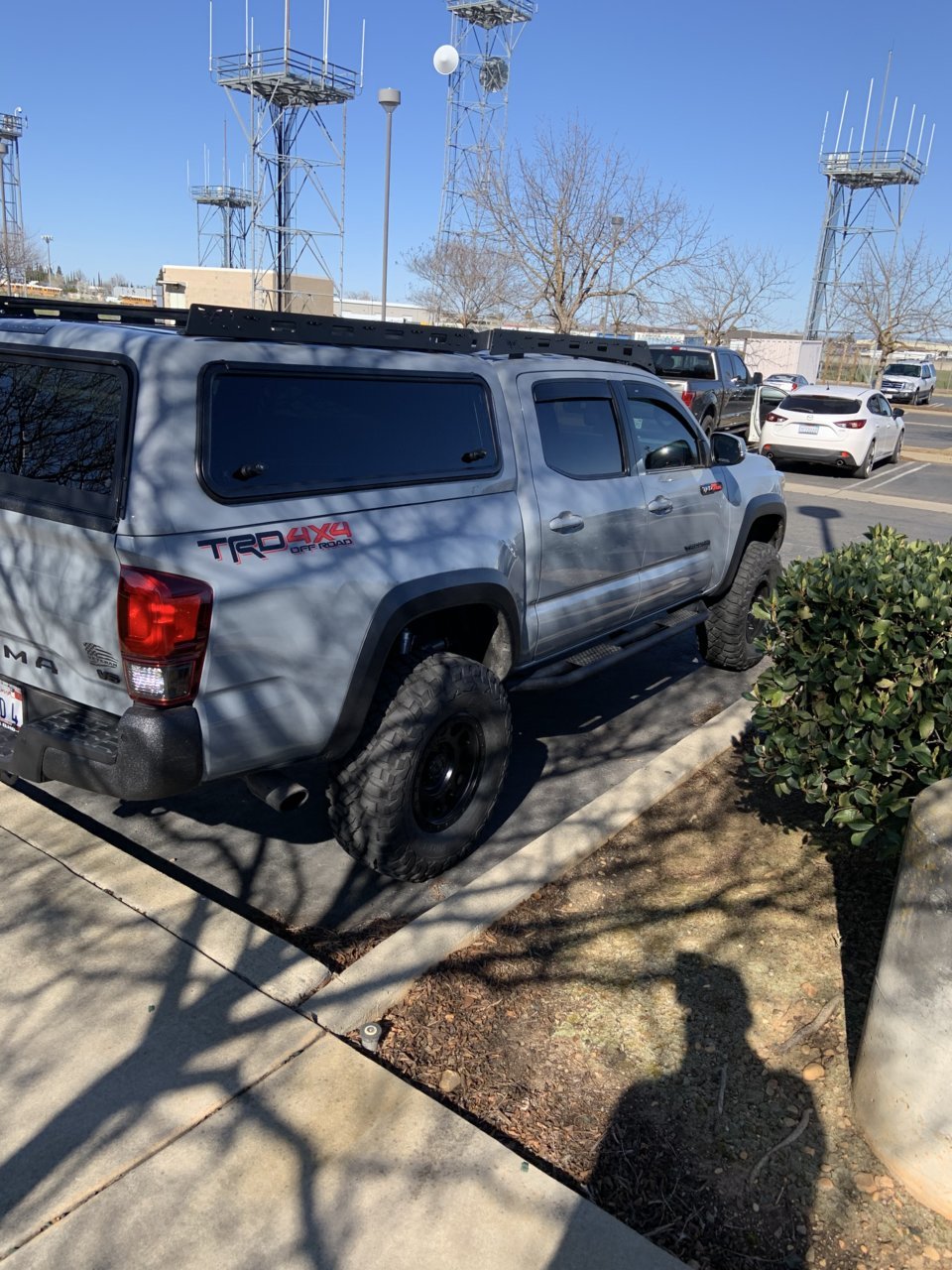

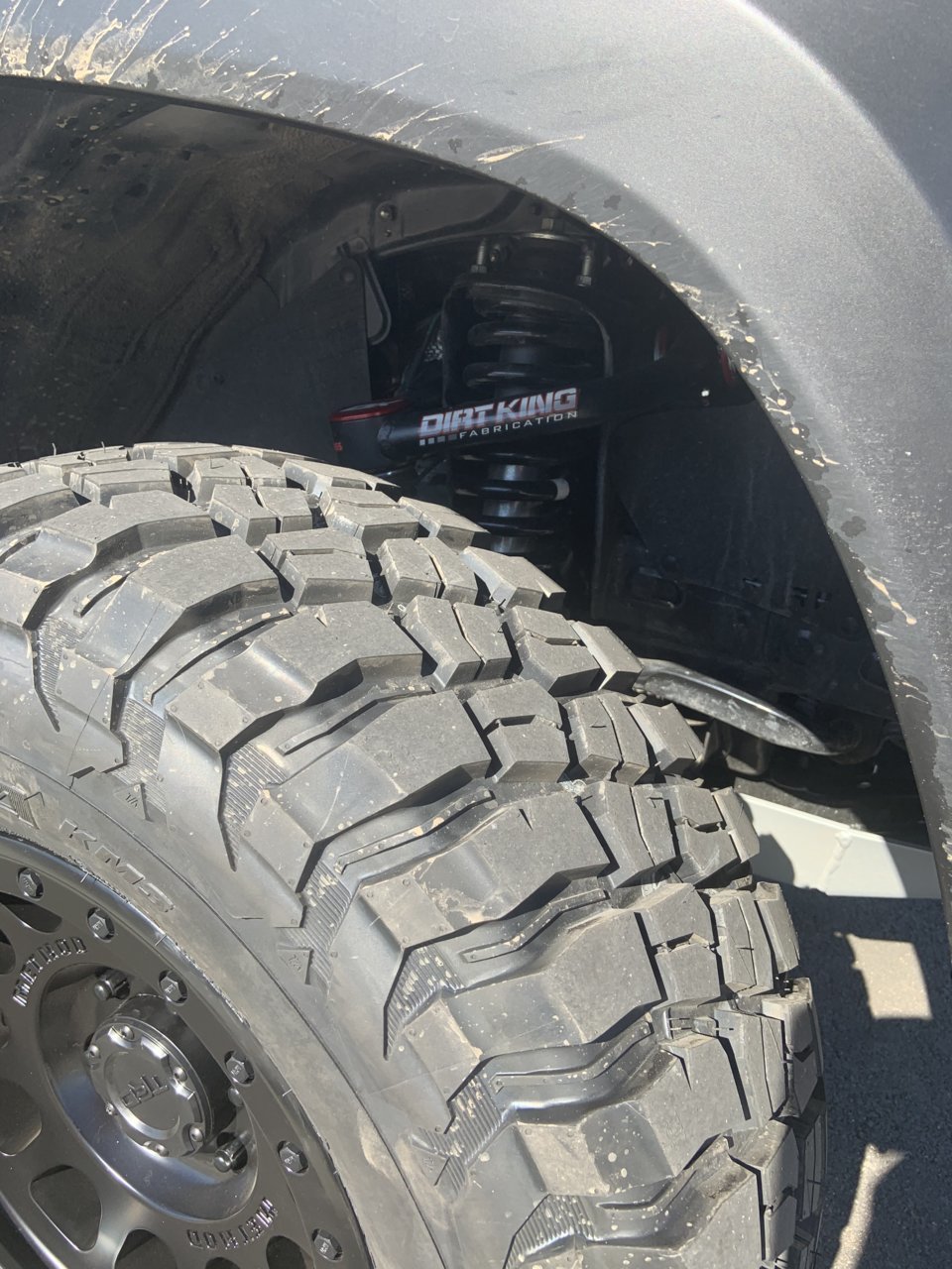

    RNO_TACO
    RNO_TACO Well-Known Member
    Jul 13, 2017
    #223983
    702
    Brent
    Roseville, CA
    2019 Cement Grey Tacoma TRD Off-road 4x4 DCSB
    A.R.E. Topper with victory topper rack, blacked out exterior emblems, star armor side steps, TRD CAI, TRD Pro exhaust, Method MR305 NV 16in Rims, TRD PRO front grill, Meso coin holder, TRD Pro skid plate, OME887 coils with 5100s for the front, 5160s rear, OME HD Dakar’s, ECGS, LT285/75R16 KM3s, Dirt king UCAs, Meso gas cap holder, Meso blacked out interior kit, TRD start/stop red button, AVS low profile window guards, AVS low profile hood protector, Full LED upgrades inside and outside, decked bed storage system.
    Hi OP. I can tell you first hand since I literally just went through all this. I have a 3 inch lift, 285/75R16 BFG KM3s, 0 offset wheels and 1.25 spider trax spacers which is roughly a -35ish offset and dirt king UCAs. CMC was an absolute must for me even with slightly aggressive alignment numbers. I understand that every truck is slightly different. Here’s some pics for reference. Good luck.
