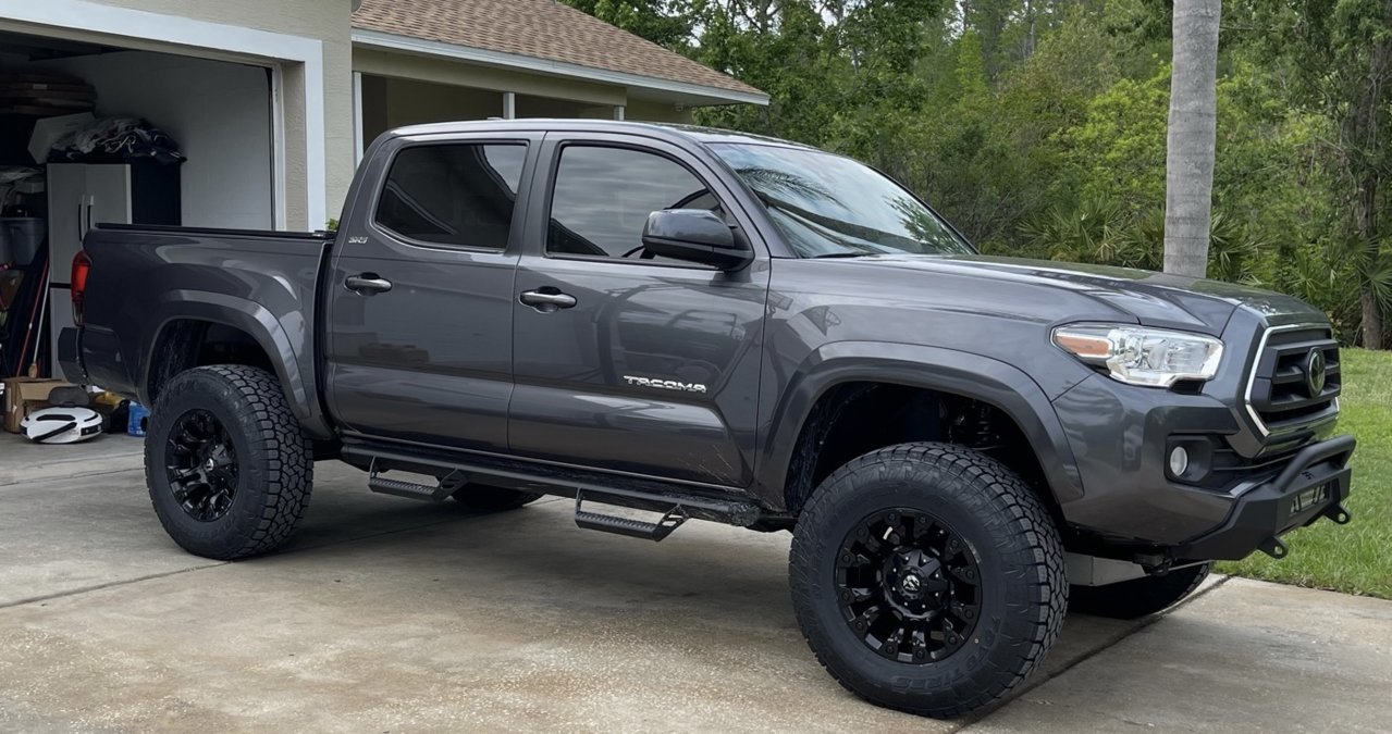

    Yes. I’m actually all done. I put a 3 inch lift out front and 2 inch in the back. Here is the results. CA03481F-15A6-4F7F-B0BC-2A10D64E18C4.jpg

    I’m very glad to help. It took me about 12 hours of research and YouTube videos to figure out what would work. I still have to do a tiny bit of cutting in the back of the forward wheel wells but there’s no rush on that because it’s not very bad. Once thats done it will be 100% perfect.

    cut on body mount? or what? because I already order same size tires and same specs of wheel, but different designs. Anyway, point is, I know 3 inches lift will work very well, but Im very curious where did you cut?

    My rubbing is remarkably mild. I have not cut it yet. I found a member here that’s going to do it for me. He’ll do it professionally and make it look like it was stock that way. No big deal.

    Right, but where did it rubbing on?
