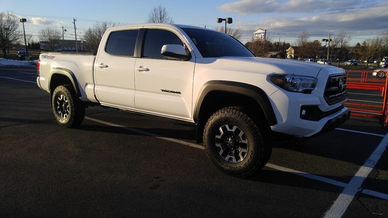

    2017 Tacoma TRD OR LB white w/tech package
    5100's all around from Headstrong. Front set at 1.65" with stock TRD OR coils and rear 1.5" AAL from Wheelers offroad. Rides firm but better than stock. Need to test it on the trails in the spring.
