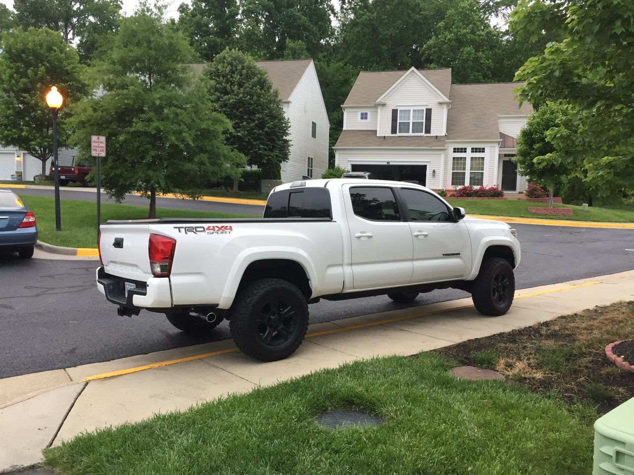

    Damn that thing is sick. Clean! Can you post the specs. I.e. what have you installed/tire size/etc. thanks!

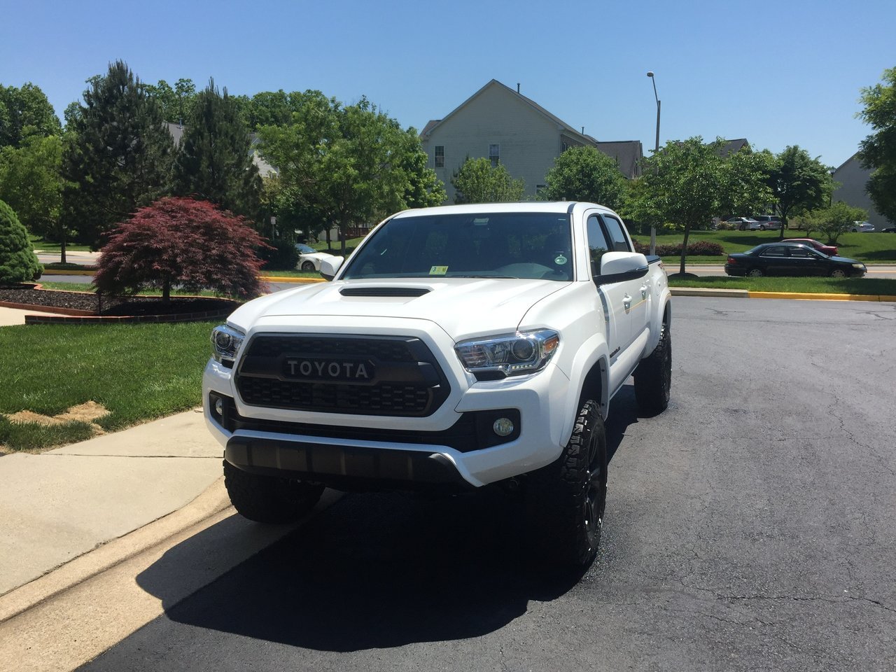

    285/70/17 Nitto Ridge Grapplers, Wescott designs pre collar lift, rough country power side steps, Truxedo pro x15 soft roll up bed cover, OEM bed mat, OEM bed swing out box, OEM Trd pro front skid plate, aftermarket pro grill, diode dynamics led fog lights,
    Thx. Click on my profile and look under information. You will see what I've done. In addition I did Spidertrax wheel spacers all the way around to fill out the wheel well. 1.25 or 1.5" I forgot lol.

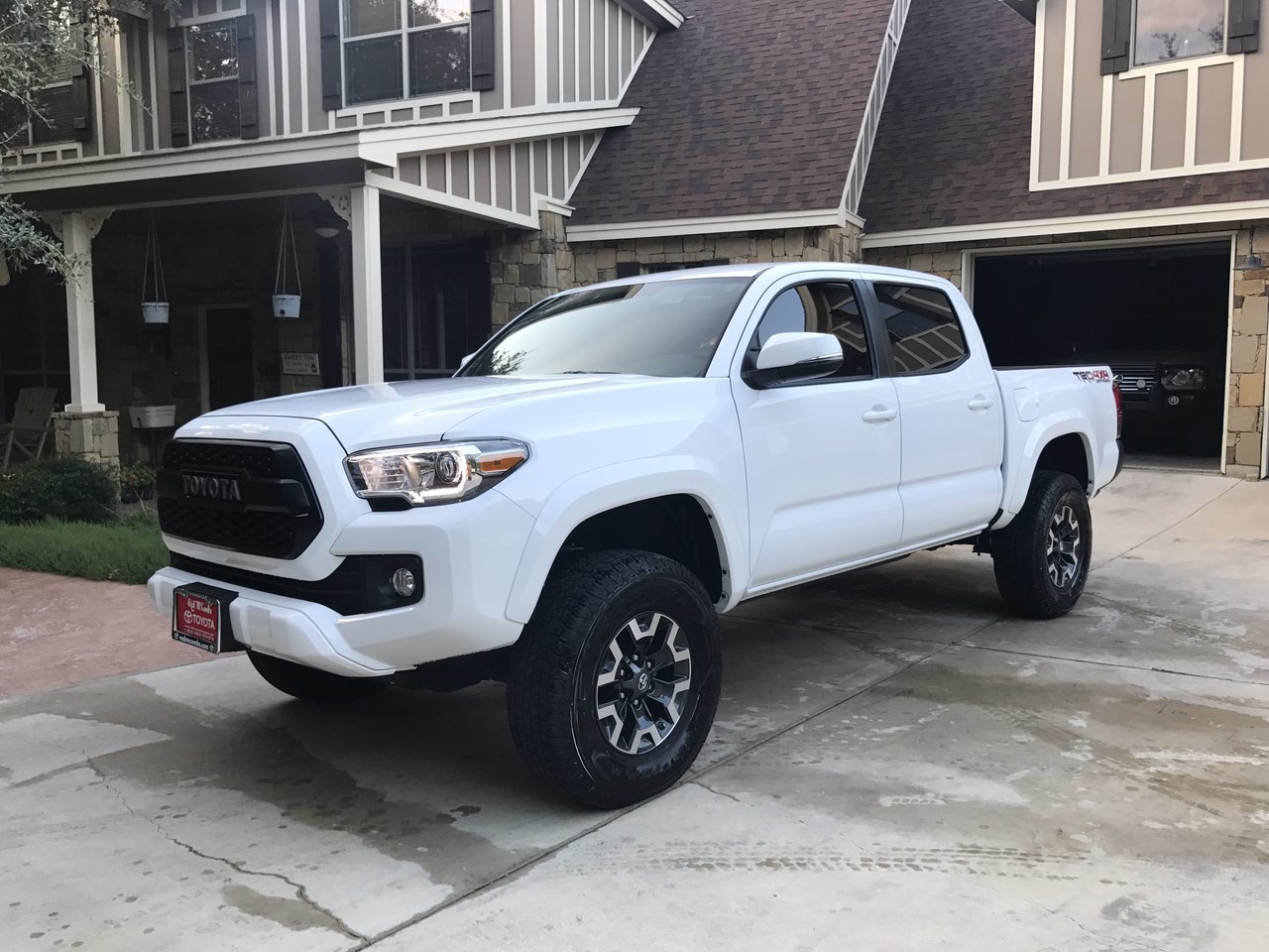

    2nd gen Bilsteins set at zero, OME 888's and HS 3 leaf progressive w/factory overload left in. Sitting on 265/75/16's with ATX AX195's -12 offset wheels. Zero rubbing and I was able to reinstall the factory mudguards.
    I left my before and after specs at work but I ended up very close to advertised lift for this combination. I plan in driving it for a day or two to let the suspension settle before aligning it. At this point it drives great and rides as good as stock from what I recall and I added almost 3". A huge thank you to marie@headstrong for all the help.
