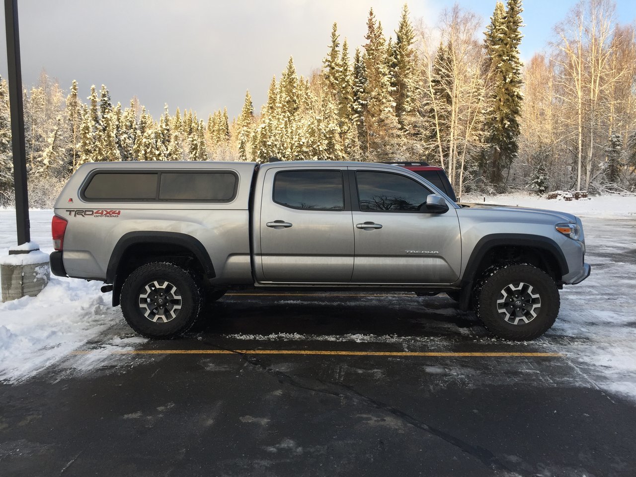

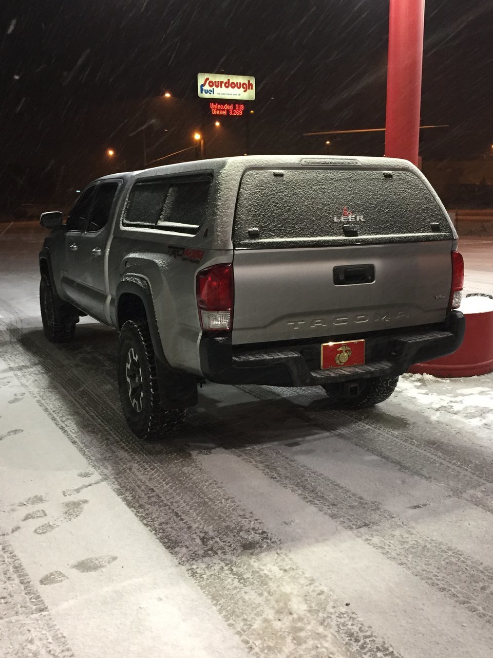

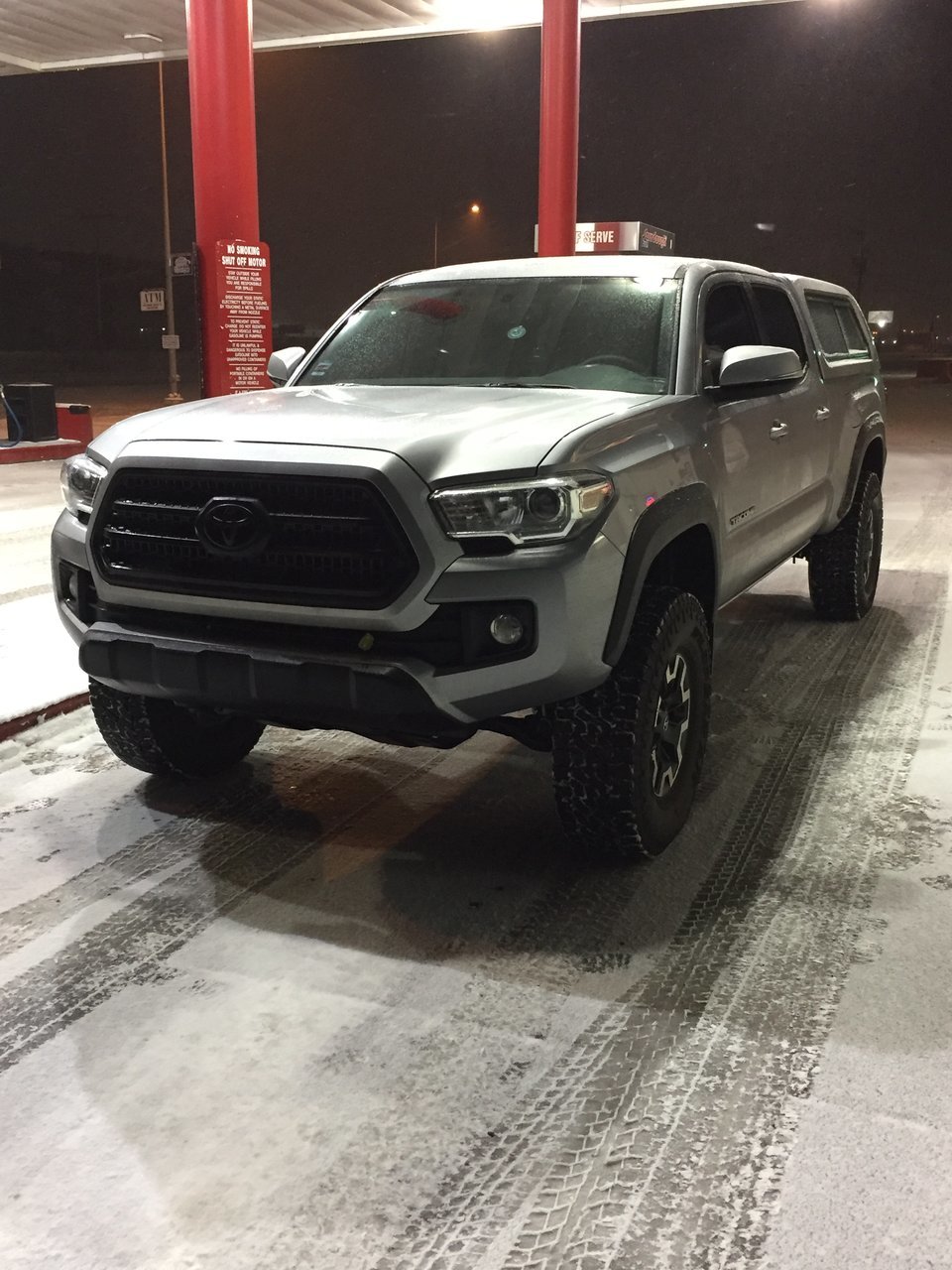

  16. Nov 5, 2017 at 3:42 AM
    #256
    Brent2014
    Brent2014 Well-Known Member
    Oct 16, 2017
    #233151
    725
    Raleigh
    2020 DCSB TRD SPORT
    Couldn’t be more happy with it. Stock uca, alignment went well it drives straight and decently tight. I still have stock wheels and tires but it looks like the truck skipped leg day haha.
  17. Nov 5, 2017 at 3:59 AM
    #257
    Therby
    Therby Well-Known Member
    Sep 25, 2017
    #231029
    873
    Kitchener
    Jeep JL
    Looks great! Exact setup im going for, except I don’t plan on doing the rtt and rack set up so im hoping the single aal will hold me over for awhile but i know eventually it will be a whole leaf pack going in.
    What kind of rubber is on that? 285?
    Catfish21[QUOTED] likes this.
