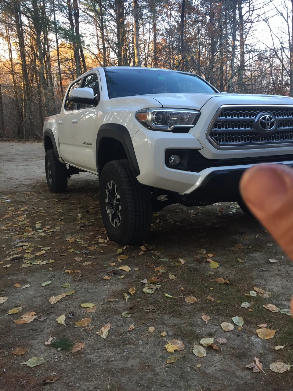

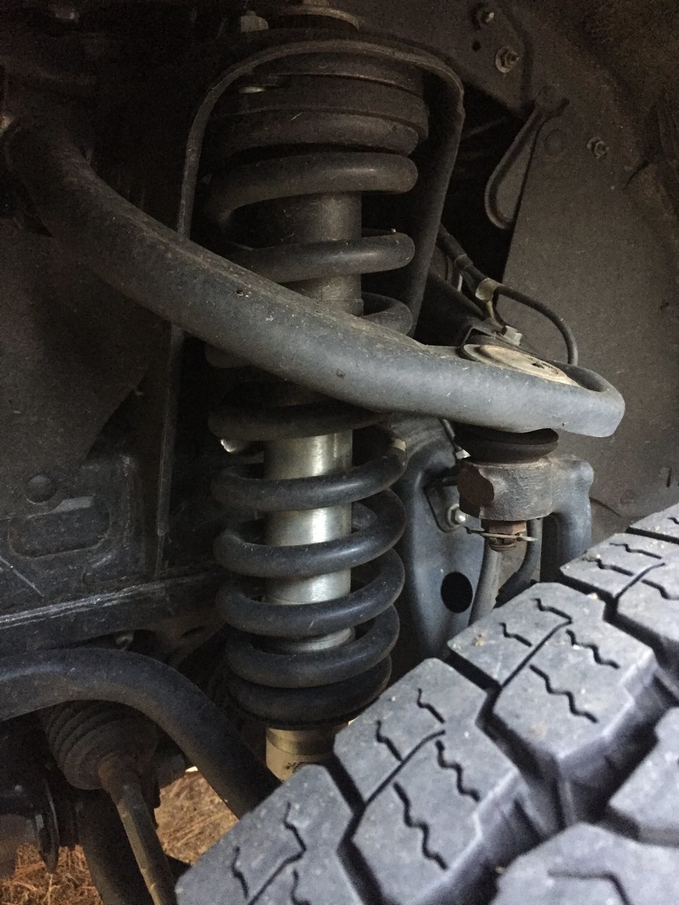

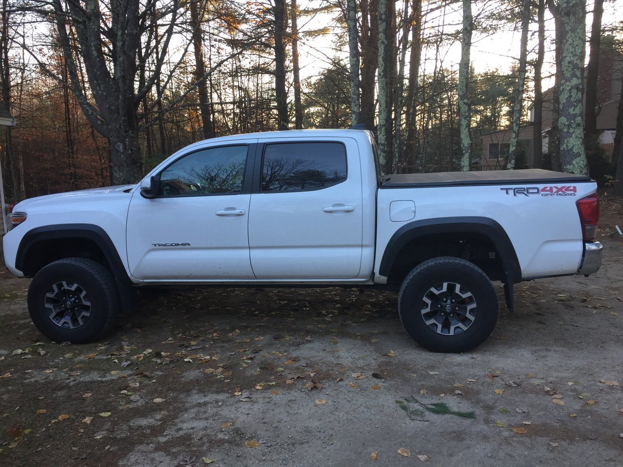

    Of course!1FA625CC-D2D9-4861-9229-87AB8B546FD4.jpg9420CA3B-8C93-4D11-A6D1-226FBB358A3B.jpgCC1C88D7-ED75-4CE1-9C68-A3043DBB63F6.jpg
    Now just imagine matte grey scs ray10’s with 285 cooper st maxx tires. ( spring time )
