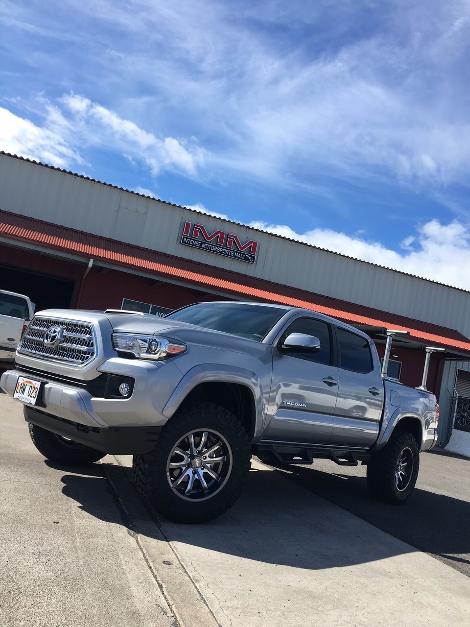

    So what is the 5100 bilstein rear shock part # I need to buy? Looking on Amazon to ship to Hawaii but don’t want to order the wrong one. My friend mentioned I need to change the stocks cause of the lift... 3” front 2” rear.
    Mahalo

    The rear Bilsteins are 24-186728.
