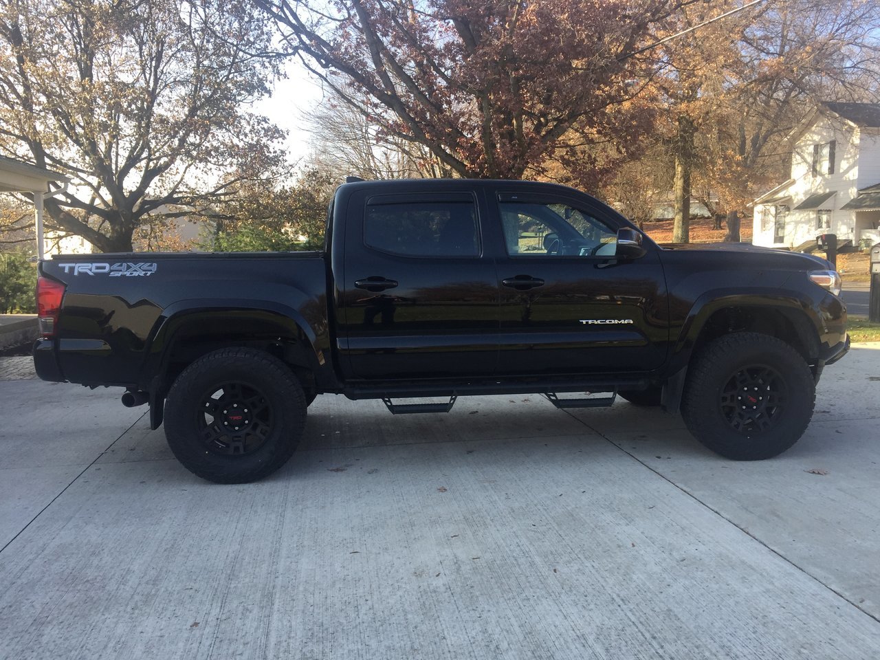

    17' TRD Offroad DCSB
    SpiderTrax, RCI Sliders, Warn bumper, Smittybuilt winch, Ridge Grapplers...

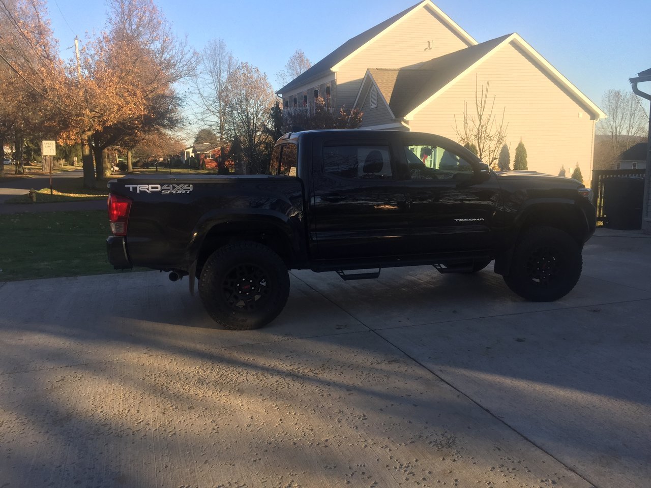

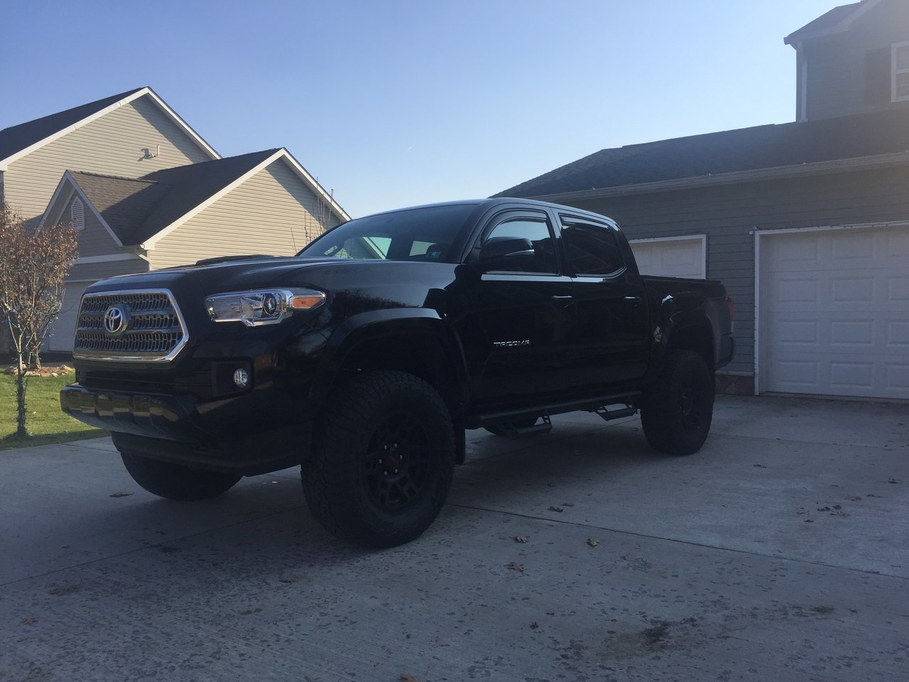

    Put the 5100 kit from headstrong on my 16 sport. 888 coils, lr uca’s, and 2 inch blocks in the back. Put on 285/70/17 wild peak at3’s. Wheels are seam trd’s. No rubbing and no cmc.

    I’ll put some up tomorrow it’s dark here now. Hardest part was the uca bolts if your doing it yourself.

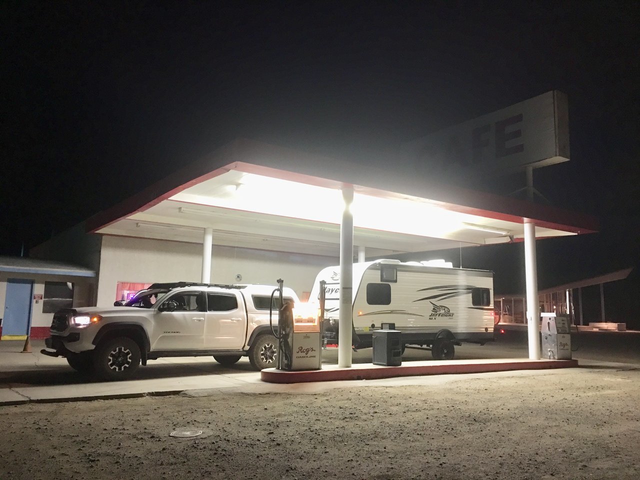

    Thanks! I mentioned it earlier, but I have 5100’s, front set to 3rd click (1.5”), and rear at the lowest setting. A single AAL leaf, 265/75/16 KO2’s on stock wheels. My trailer has a Husky weight distributing hitch, too.
    Edit: 20’ Jayco @ 3000 lbs.

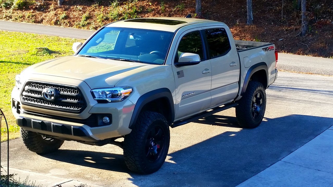

    Thanks! It’s a Prinsu cabrack, and I lifted front and back about 1.5–inches with a combination of using 265/75/16 KO2’s, 5100 shocks front and back, and a single AAL spring in the rear to give it less sag when towing. Drives great empty too.

    Haven’t had it off-road but no rubbing so for. Just put the hyper tech in today to correct the speedometer. The pics really don’t do it justice it looks like a completely different truck.lost my premeasurments bit from the floor to the top of the wheel well upfront 39 1/4 rear 40.
