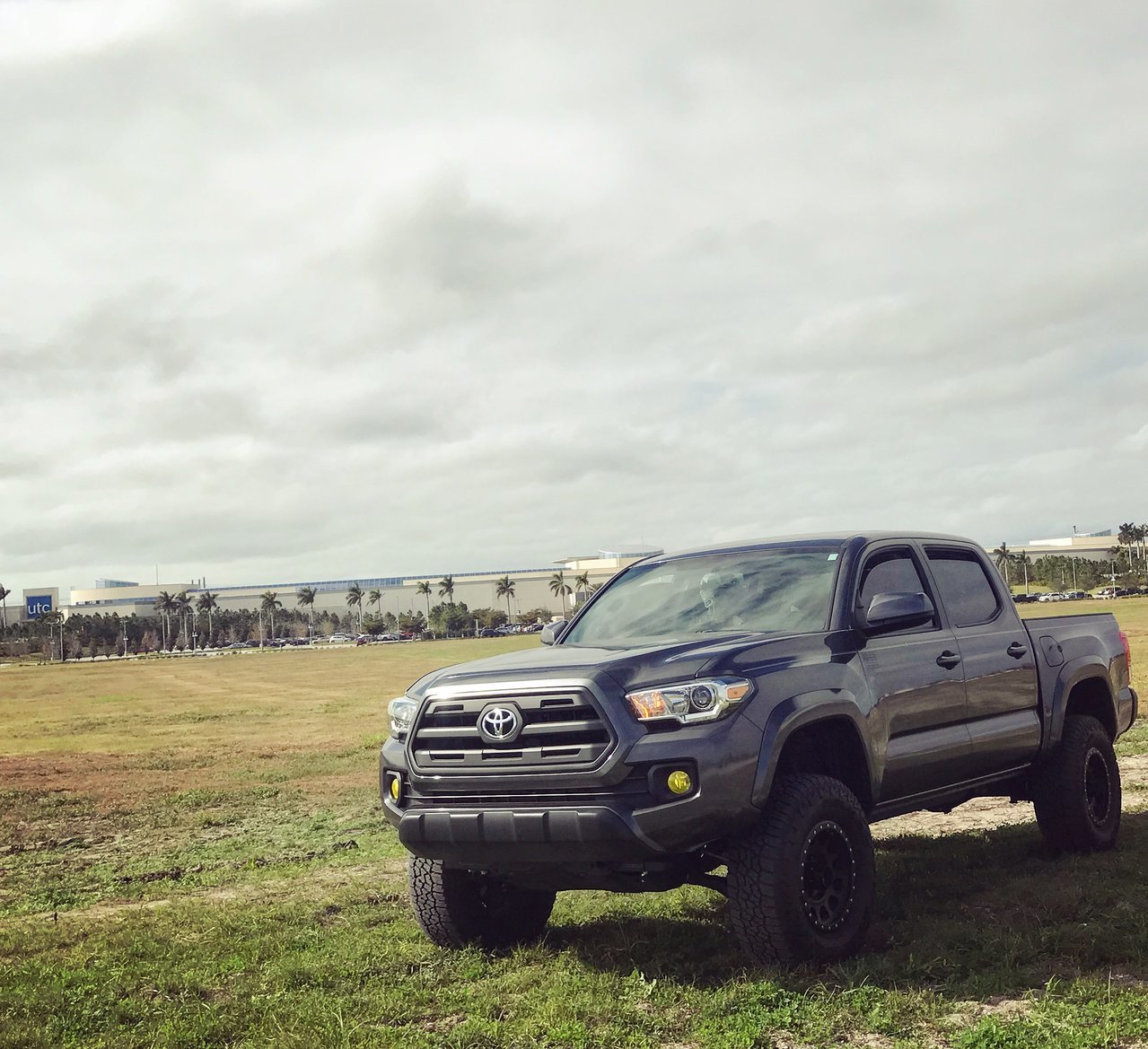

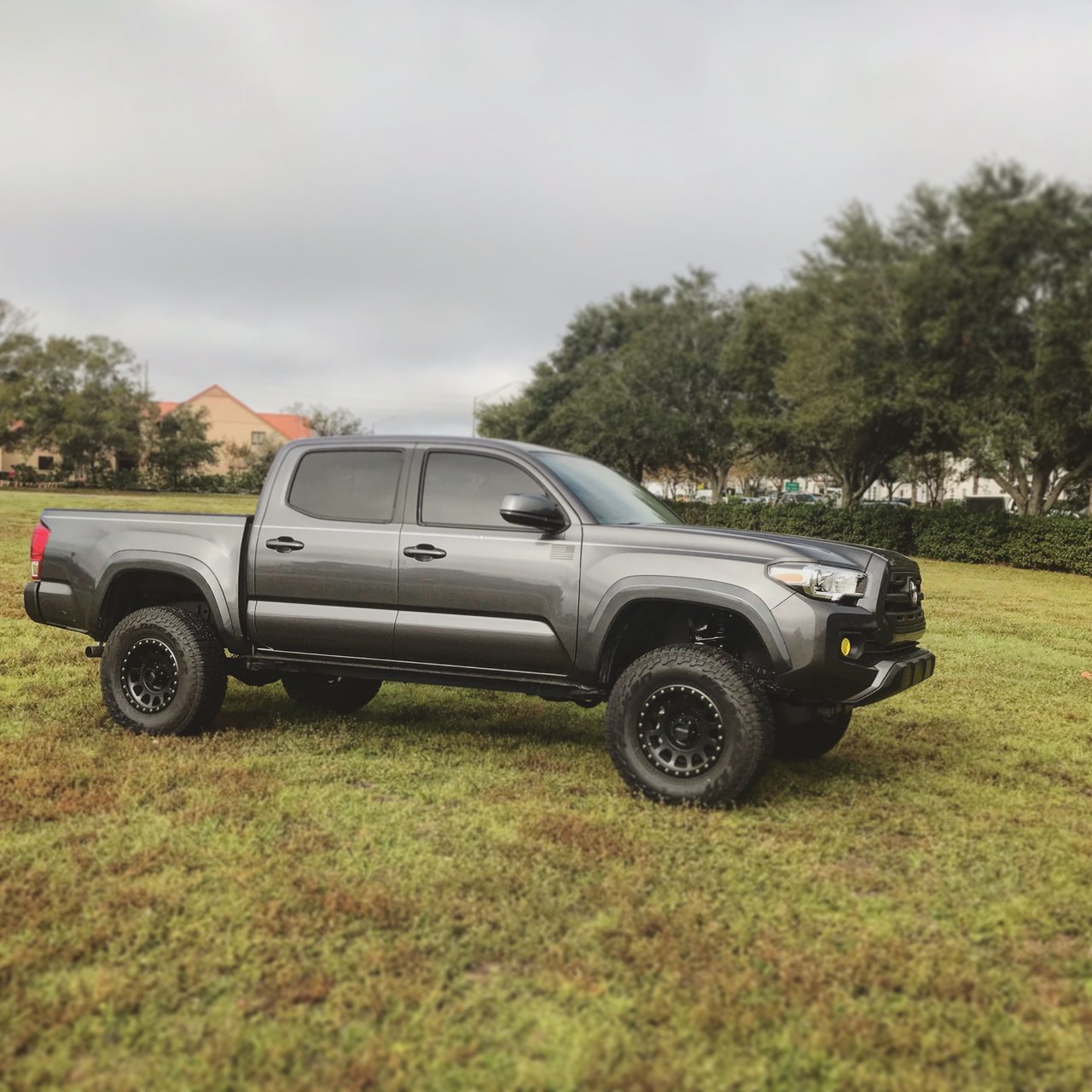

  3. Jan 15, 2018 at 6:35 AM
    #403
    iiitsmikey
    iiitsmikey Well-Known Member
    Mar 26, 2017
    #214463
    390
    Sarasota fl
    2017 MGM SR5
    2wd, so no need for it. But I would highly recommend it since you’ll be working in that area anyways.
    265/75/16 falken wildpeak at3w p rated.
    They run a little large
    I think they’re 32.8 compared to other 265/75 tires that run closer to 32.5
