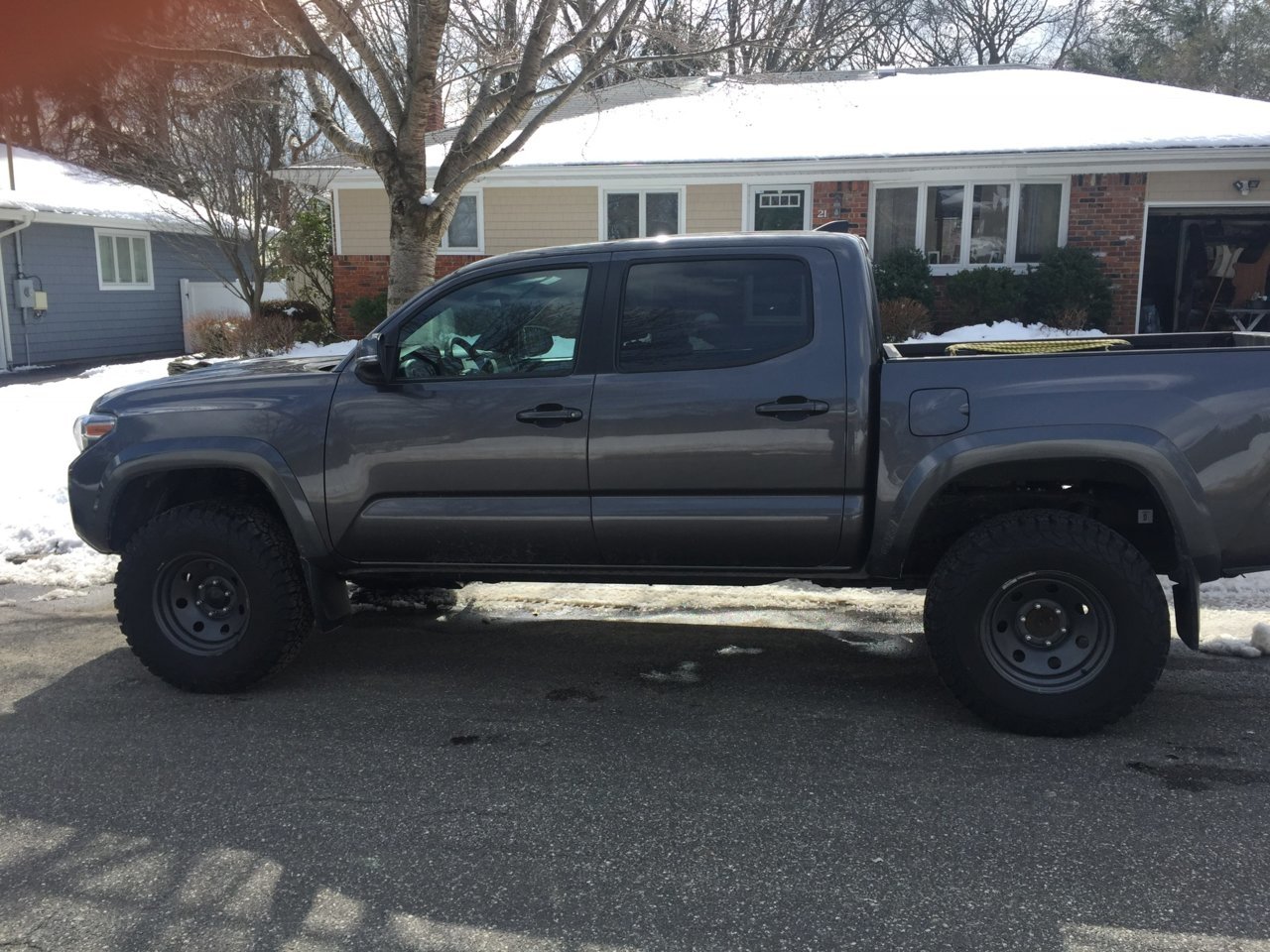

    Is this what you you are looking for. 5100 fronts set at 1.55 and rear add a leaf with 265/75/16. At 5.5 backspacing on the rims. No issues. C2F4A949-B235-4225-8404-B236BFE14DE3.jpg
