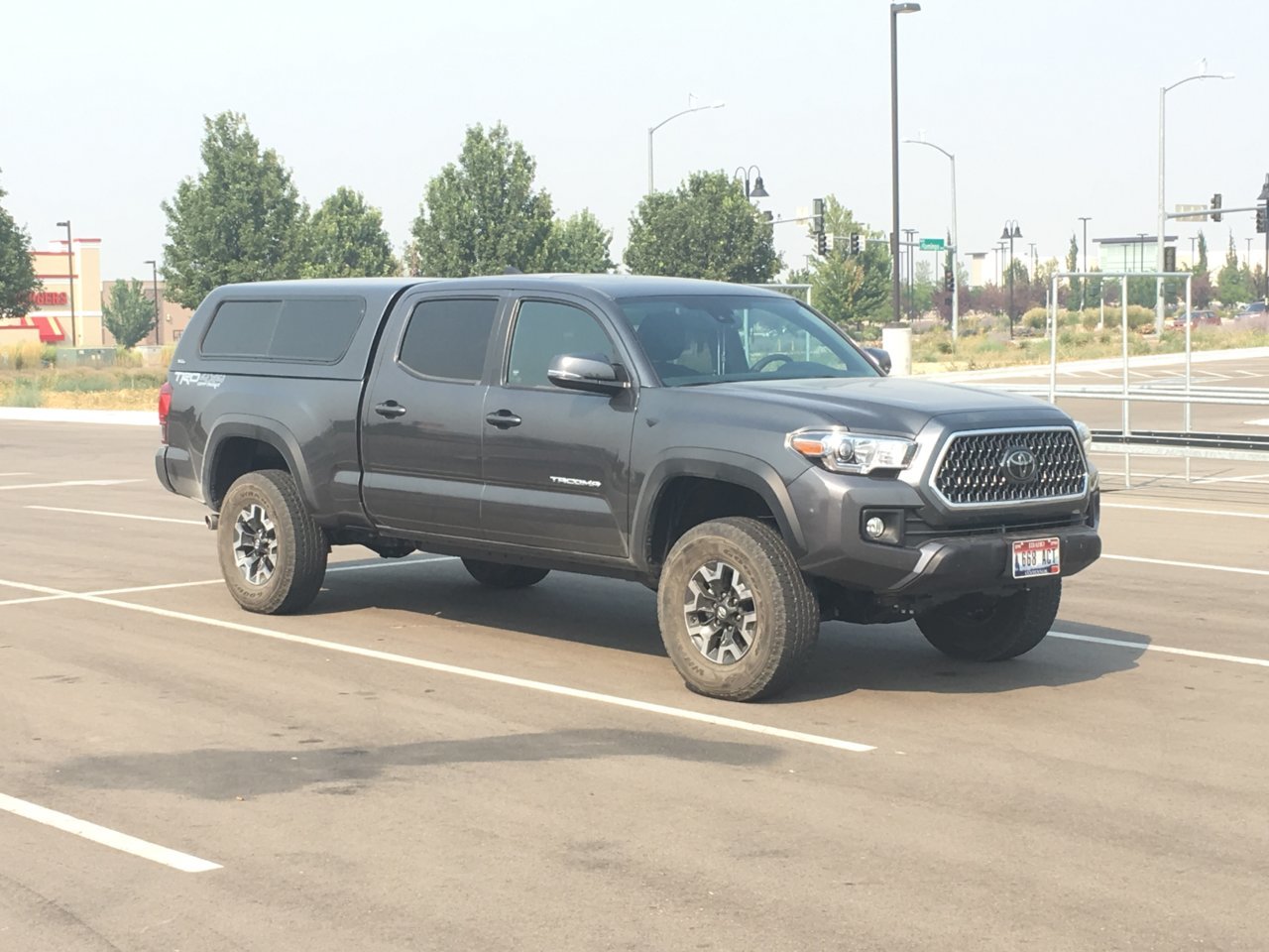

    If I didn’t have the Sumo’s in place my constant load of 350-ish lbs causes the rear end to sag even with the AAL installed. I don’t do any intentional rock crawling, but I do want the truck to be able to go down marginal dirt roads to get me to the trail head or other wanderings, and be able to support the weight of the gear I bring with me in addition to the normal load.
    I’m looking at OME Dakar leaf packs as well, just trying to figure out if I need the HD or MD. Leaning towards HD.

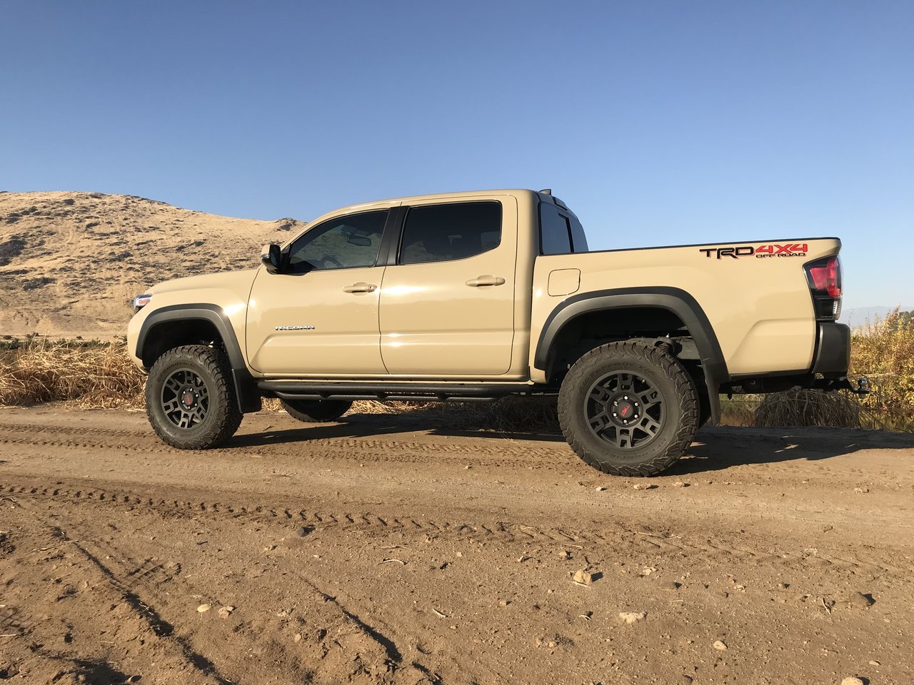

    Two year update? haha, I bought my truck used, and previous owner put a 2 inch spacer and block. i want to upgrade this hopefully this year. im assuming my current ride is a little harsher than stock due to spacer and block. also, are you using stock springs etc? Thanks!
