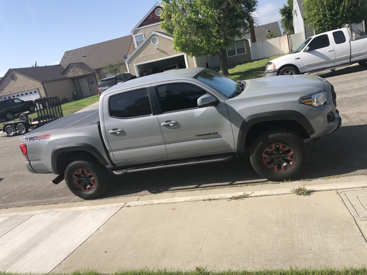

    OME 888 5100s 1/2 top spacer camberg UCAs AAL and 2 in block and 5160s in the rear. It's about 3 in with 285-75-16 on stock OR wheels and 1.25 spidertracs spacers and a CMC.20190301_152733.jpg 20190301_151832.jpg

    This has the old UCA that I didn't use.

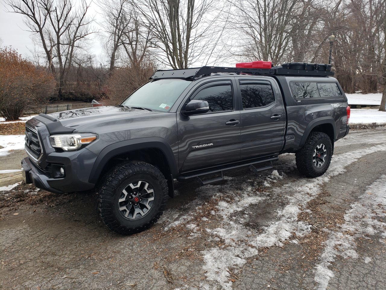

    498F1F52-655B-48C1-B237-CD39EF8407B0.jpg E21BB81E-0963-4B65-8D04-878F66F70785.jpg

    What camper is that?

    It's a softtopper

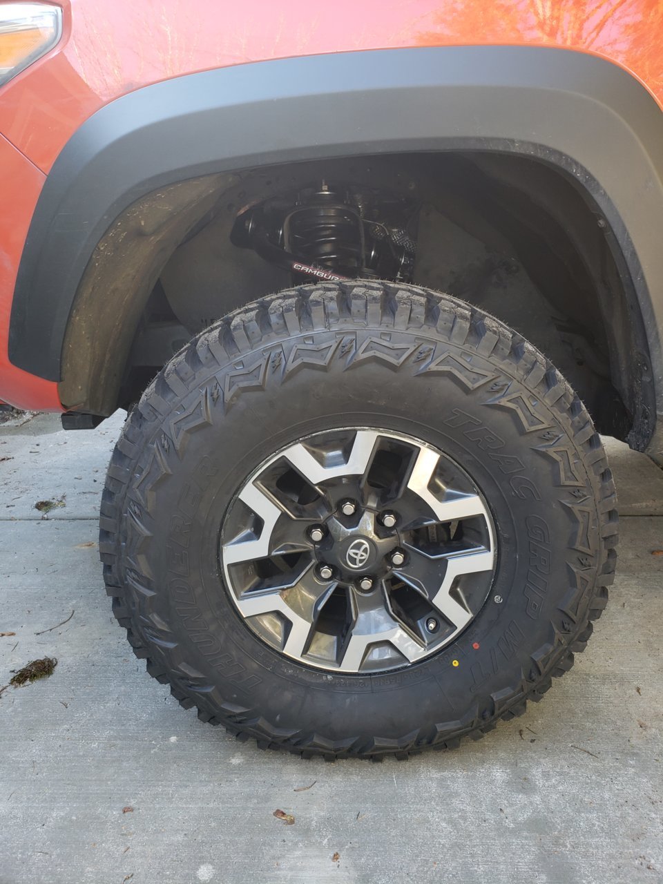

    Front - 5100's stock height plus 2" lift spacer , 1" rear block plus AAL, 1"wheel spacers, SPC uca's, ARE cap, Prinsu cabrack, DIY Prinsu toprack, Goodyear Wrangler Duratracs 285/75/16, K&N air filter, custom bed drawer system, center console rear outlet mode, 400w inverter all the time mod, DIY pop n lock tailgate e lock, hondo garage un-holey tablet mount. Soon.... RRW Stealth front bumper (ordered - 6-8 weeks) Smittybilt X2O 10,000 lb winch (waiting on bumper) Rigid industries 20" E series combo beam (waiting on bumper)
    Here is my 17 OR. 1" rear spacer plus AAL in rear. 5100's up front on stock setting and 2" lift spacer. Had about the same front height before with the 5100's on 4th setting but it was way too stiff for me. Much smoother now. SPC uca's and nowhere even close to rubbing anywhere with Duratrac 285/75/16 spaced 1" on the stock wheels. No cab mount chop for me. 20191213_100938.jpg20191213_100924.jpg 20191213_100903.jpg

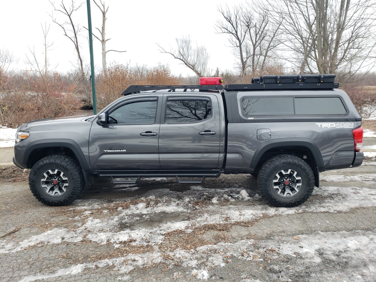

    Road is flat, no incline so the rear looks taller. Level the curb to get an idea of rake.
    Another angle
    5100s front and rear
    887s settled after a year
    3 progressive AAL with overload left in.
    SPC UCAs
    CMC
    285 Nitto tires on the 4runner TRD Pro wheels.
    2 inches from stock, maintains factory rake.
    Very happy with it.
